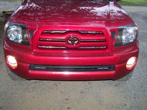

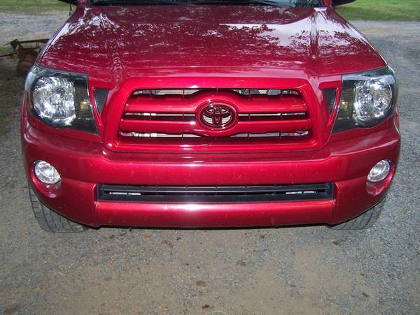

  12. Sep 19, 2011 at 4:01 PM
    #112
    jerretxx
    jerretxx Some do, others talk
    May 23, 2010
    #37692
    2,233
    Jerret
    North Carolina
    2017 DCSB Tacoma TRD Sport 4x4
    My before and after pictures:
    Before Foglight Mod:
    After Foglight Mod:
  13. Sep 19, 2011 at 4:06 PM
    #113
    memario1214
    memario1214 Hotshot Offroad Moderator Vendor
    Oct 1, 2009
    #23628
    20,162
    Colton
    Missoula, MT
    SOLD - 05 Dub Cab TRD Sport 4x4, CURRENT - '21 Tundra MGM Limited
    Not quite sure why, but I find myself mesmerized by this picture... Looks amazing
  14. Sep 19, 2011 at 9:19 PM
    #114
    AWorthyOpponent
    AWorthyOpponent Member Caught Off Road
    Aug 22, 2011
    #62164
    2,965
    Dan
    Palm Beach County, Florida
    2013 MGM DCLB TRD SPORT 4x4
    TRD Catback Exhaust
    Thank You. The silver taco has a tendency to do that to people. :D
