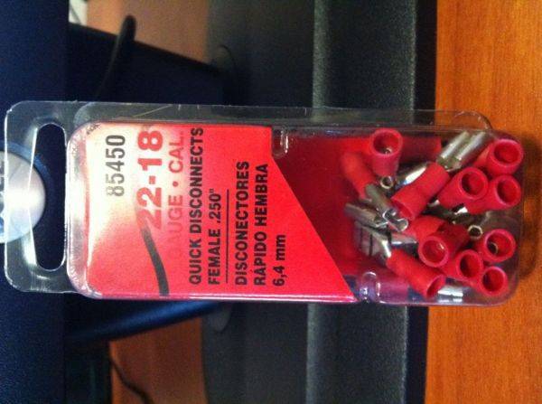

  16. Jan 19, 2012 at 7:05 PM
    #176
    Derpy Derek
    Derpy Derek Well-Known Member
    May 10, 2010
    #36868
    4,890
    Derek
    Brookings, OR
    2012 TRD Sport 4x4 DCSB
    ARB Bumper, Smittybilt X20, King suspension
    I'm trying to figure out if this will work as the "female blade connector" described in the original post. It seems to look the same as the picture in the original post, but it says "quick disconnect" instead of "female blade connector".
    I might be over-thinking this, but I would just like to be absolutely sure if I got the right piece or not.
  17. Jan 19, 2012 at 7:49 PM
    #177
    yunohoo
    yunohoo Member
    Nov 21, 2011
    #67449
    17
    Ozarks
    07 TRD Sport DC BSP
    ^^^Looks exactly like what I used. Those are "female blade connectors."
  18. Jan 19, 2012 at 8:26 PM
    #178
    Derpy Derek
    May 10, 2010
    #36868
    4,890
    Derek
    Brookings, OR
    I have the female blade connector on the 18gauge wire, did you use a male spade connector on the other end of the wire?
  19. Jan 19, 2012 at 9:47 PM
    #179
    "OLYMPIC VIEW"
    "OLYMPIC VIEW" [OP] Well-Known Member
    Mar 8, 2010
    #32829
    106
    WHIDBEY ISLAND, WA
    2011 TRD SPORT D/C LB...1987 SR-5 4WD XCAB
    Those are the right "female blade connectors"...strip off 1/2" inch of the insulation on the other end of 18g wire, twist the now exposed copper wire, and insert that end into the Towing Tail Relay socket as described in OP...Hope this helps...PM me if you have any other questions!!
  20. Jan 20, 2012 at 2:37 PM
    #180
    yunohoo
    yunohoo Member
    Nov 21, 2011
    #67449
    17
    Ozarks
    07 TRD Sport DC BSP
    ^^^^Exactly.
