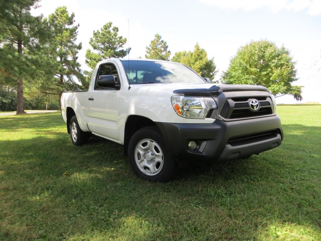

    I was wondering if anyone installed any fog lights on their bumper. I realized a lot of 5 lugs, including mine, didn't come with fog lights on the bumper, just a black plastic circle in the spot. I was wondering what I need to buy specifically to have simple fog lights for my Tacoma

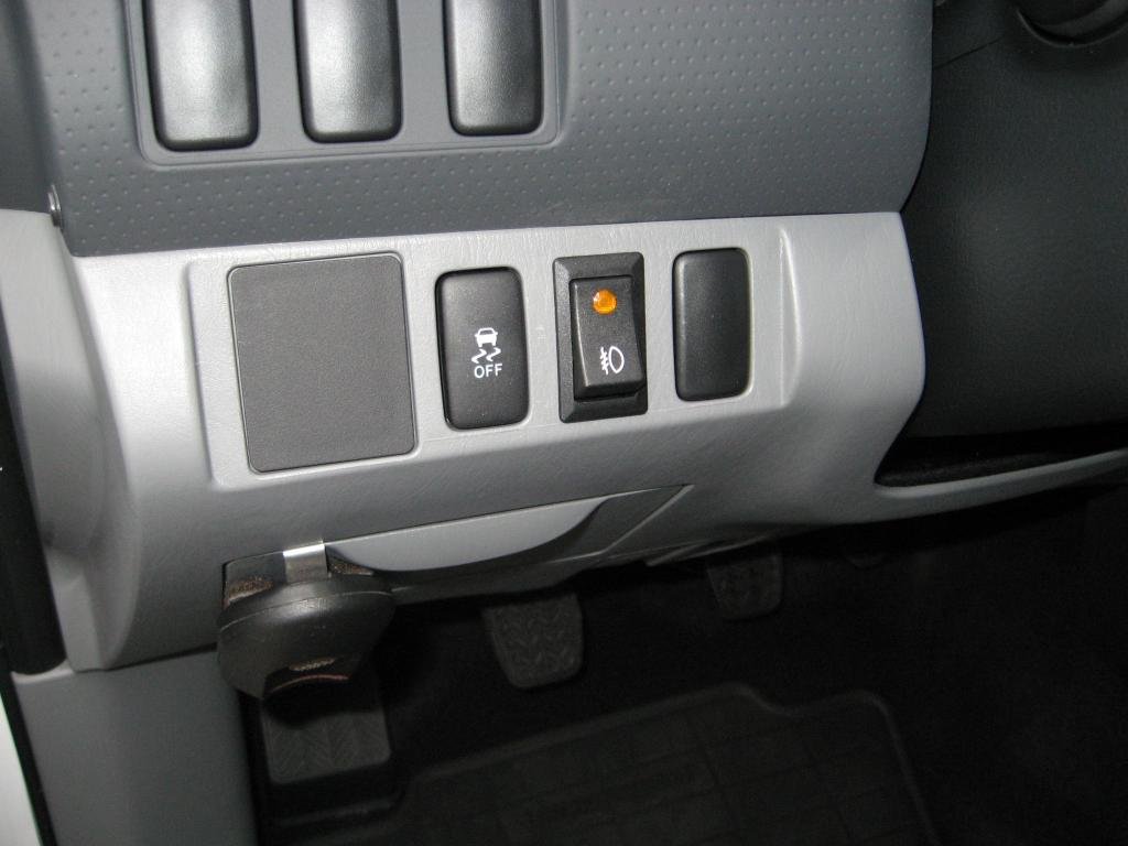

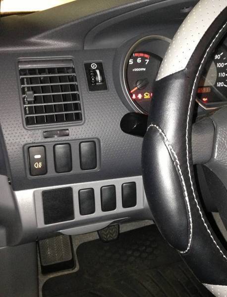

    got the exact same ones. Took me a minute because i'm an idiot, but they look completely stock. Plenty of write-ups on YouTube, and actually a few really helpful reviews on Amazon.

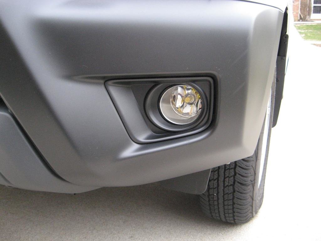

    Here's my OEM style from Ebay. My kit is actually for an '06-'08 RAV4. The lamps the '12+ Taco uses are nothing special. Toyota has used them for years on damn near everything they built. You don't need the aftermarket bezels has the OEM bezels and blanks separate. All the "universal" harnesses these kits come with are pretty much the same. You'll need some electrical experience as the harnesses are not plug-and-play. So some wiring modifications will be needed.
    I cut off anything on the harness that had anything to do with the switch and incorporated in older OE rocker switch they used to use on old 4Runners and RAV4's.

    Will those fit 2012+? I think the fog light cutouts for 2012+ are smaller

    I think you're right, but that's the factory position for the switch on my 2008.

    Yeah the ones FubarJohnny posted aren't for the 12 plus. I did a set similar to those for my 2010 and it's about an hour or so, fortunately a fellow TWer hooked me up..no issues in 2 years.
