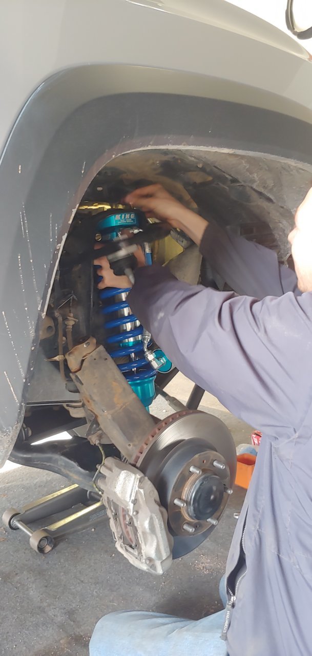

    Also installed some sliders custom bed rack sumo springs, and hidden winch cradle for @CO-Tacoma didn't grab pics but mebbe hrew can post em up :fingerscrossed:

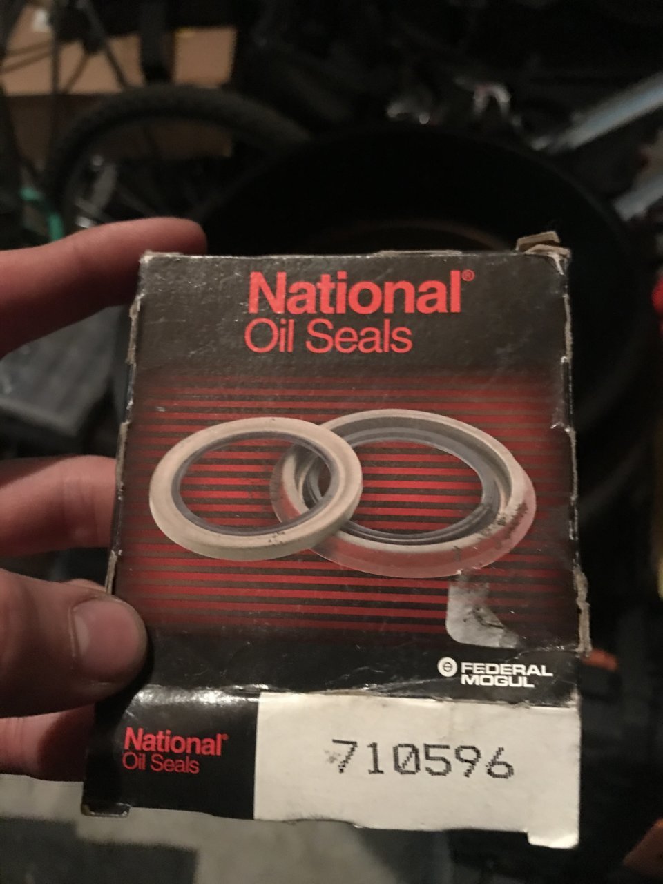

    @iTzWho @Hashc93
    so here is the parts list you’ll want to get:
    Ecgs bushing
    1 qt of gear oil that you use.
    new seal (either from Toyota or pic below)
    Lug key if required
    we try and save as much of the oil as possible so we’ll end up putting ~1/2 the bottle in. Also the seal is highly suggested as to make sure it doesn't leak when the old bearing comes out.
