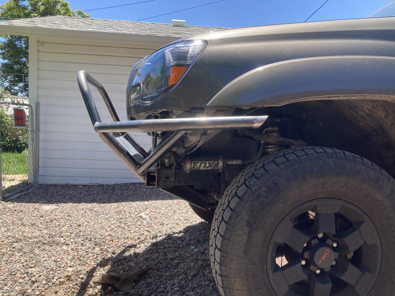

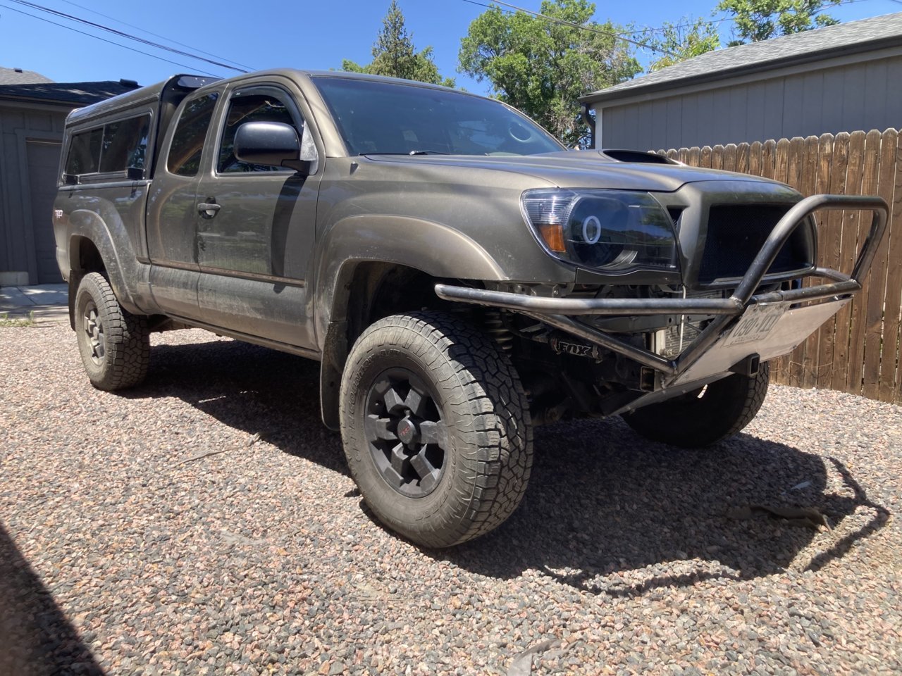

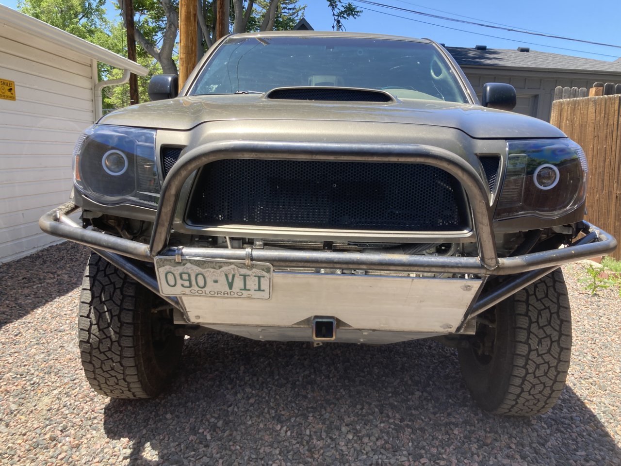

    Extreme high clearance bumper with front hitch and aluminum plates. These guys went way above and beyond to get this the way I wanted, I really appreciate all the great work.
    The new bumper is super light weight compared to the all-pro steel plated bumper I had on there before, over 100lbs difference. I have 600lb springs on my coilovers, and they were way too soft between the steel plated bumper, winch, and supercharger. The front has about an extra inch of lift now and driving it feels way better.
    I’m still planning to paint the tubing black, brush the aluminum plates, properly mount my license plate, and cover all the exposed inside bits with some cut polypropylene sheets.
    Sliders & high clearance rear up next on the wishlist

    Hell yea man! Really glad you like it

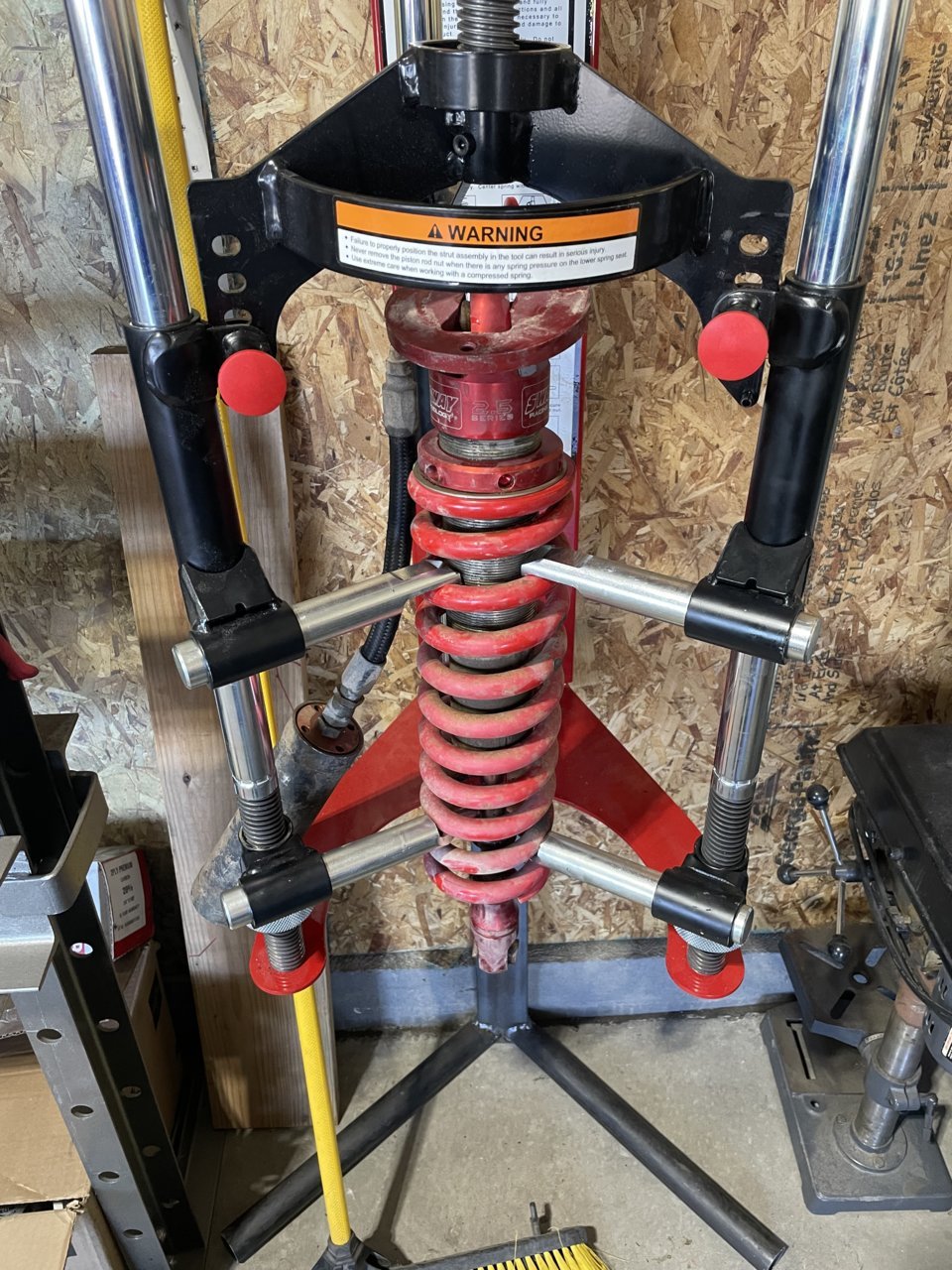

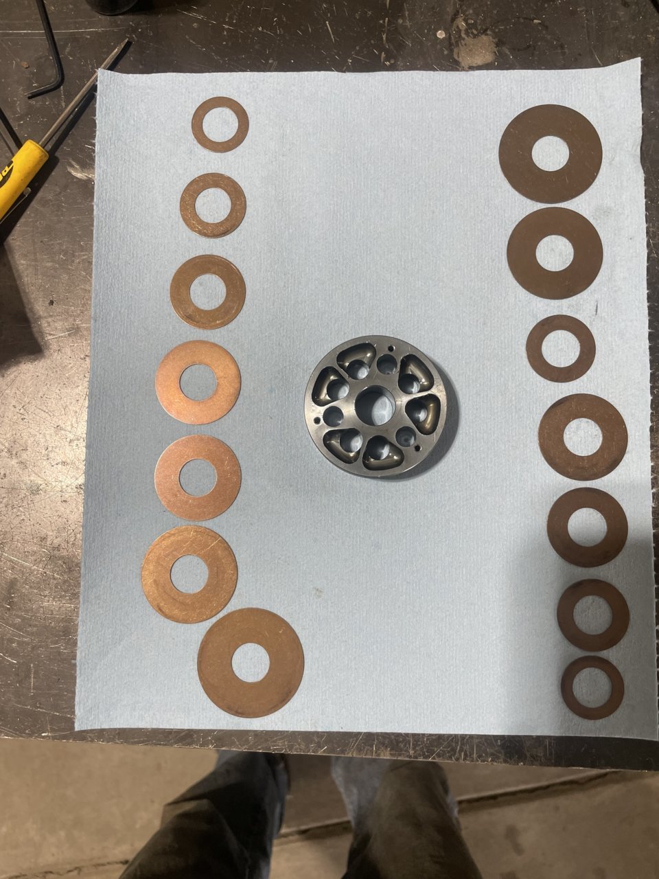

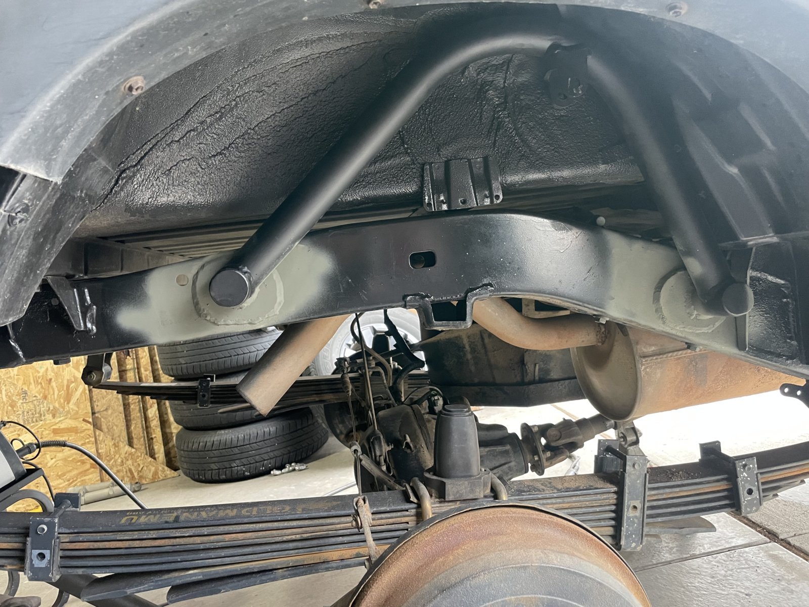

    We now offer shock rebuilding services.
    I don’t carry a lot of seal kits in stock at the moment. But we can get them quickly

    Thanks for the rebuild
    Great job
