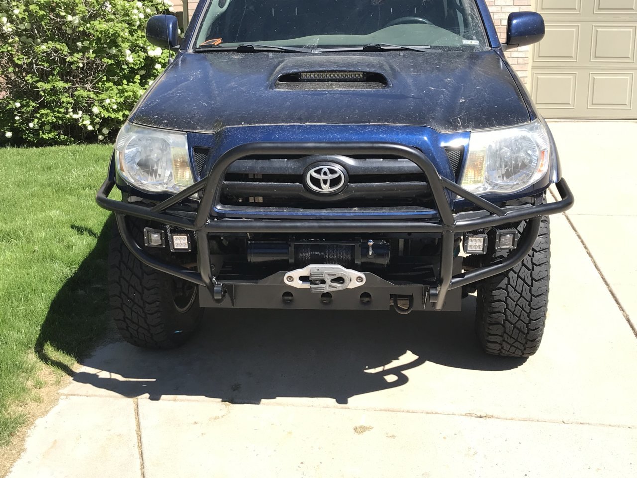

    Bumper design is finished and it super light! Got to use it this weekend to tug @bot102 ’s truck out of the snow and the bumper held strong! Still gonna add 2 more tie in points to the frame.
    Without further delay!
    D708F2FE-0140-4448-BDB8-9D301BA59D2B.jpg E27AE2B4-744D-4AE2-9C7A-5EA3107A06A0.jpg

    Agreed. But when there connected to the 1/4” winch plate and the 3/16 leg as well as the tube, i think the bumper will come off the frame before that recovery point gives way.
    Once I add 2 more tabs on the bottom 2 bolts it’ll help spread the pull through the skid plates and less stress on the front frame horns. Right? Or is my thinking off?

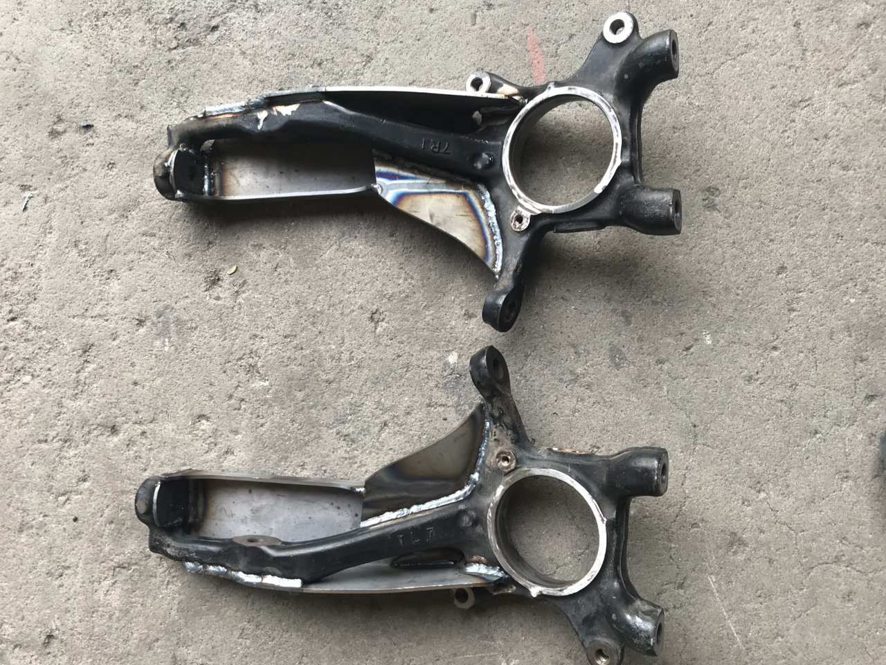

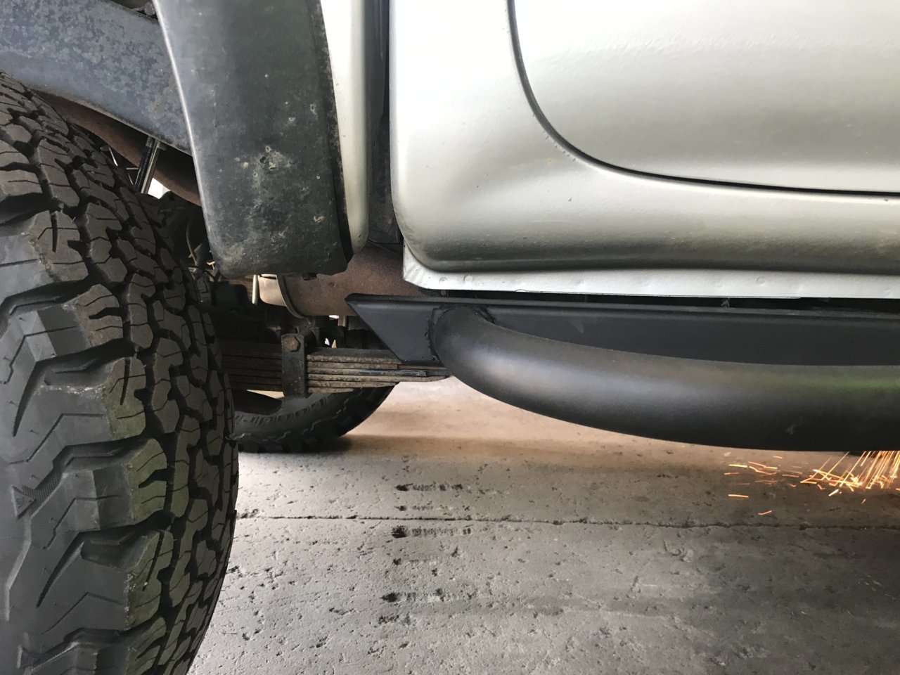

    1st gen sliders
    7CB01B52-2033-4537-BC6E-8DA61E469381.jpgA526FF1C-2884-4637-9296-9C72F913A6A3.jpg1E24039D-6FE5-42C9-84BC-A466EEFDEC8D.jpg 4664818C-B9D9-4F5E-B90A-C73BDC2573BA.jpg

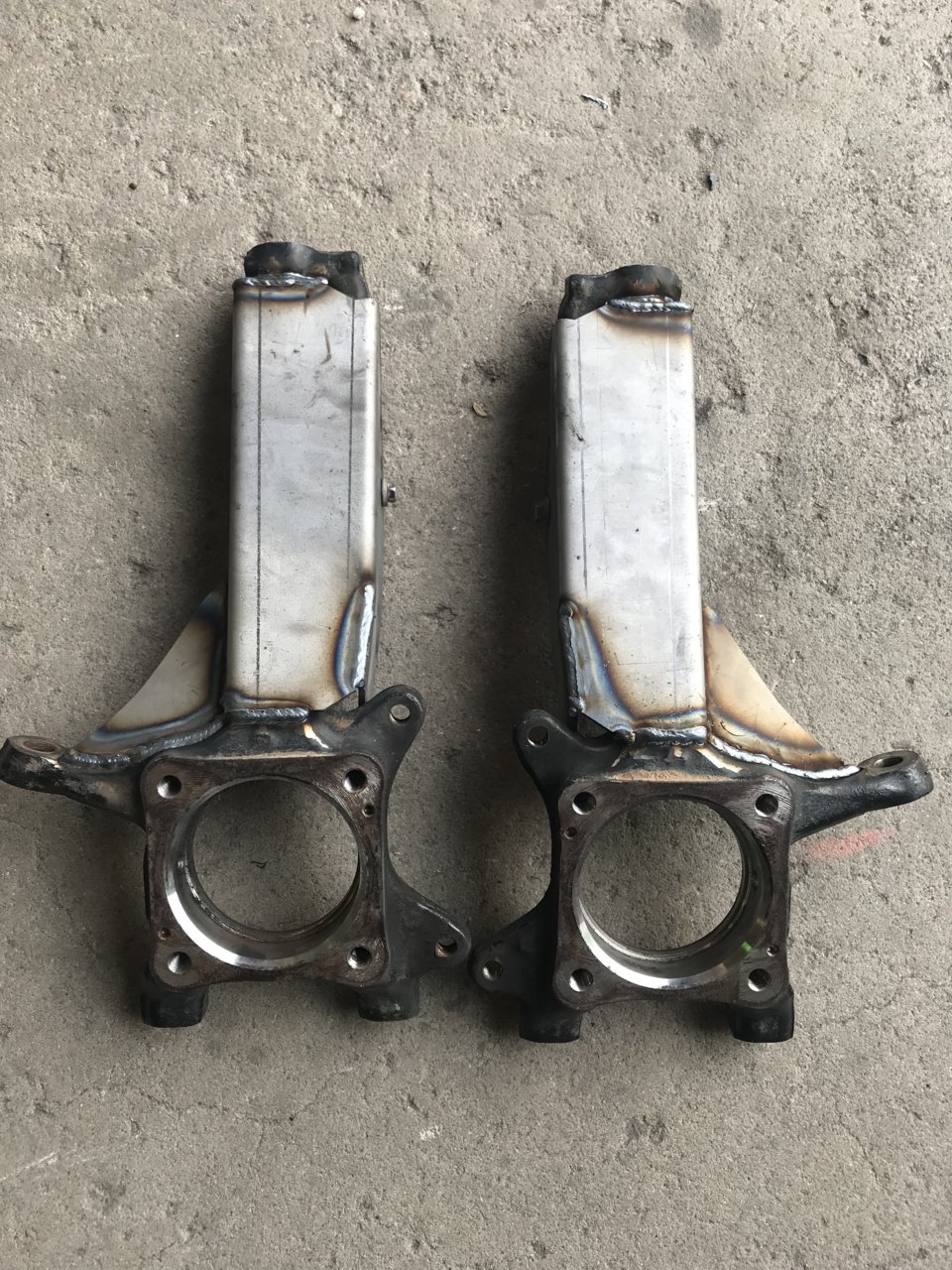

    2nd gen spindle gussets
    36835818-3469-4BA1-8A44-592BA1FF95B9.jpg 4813B892-E0C6-4E41-8C08-567A29D4F360.jpg
