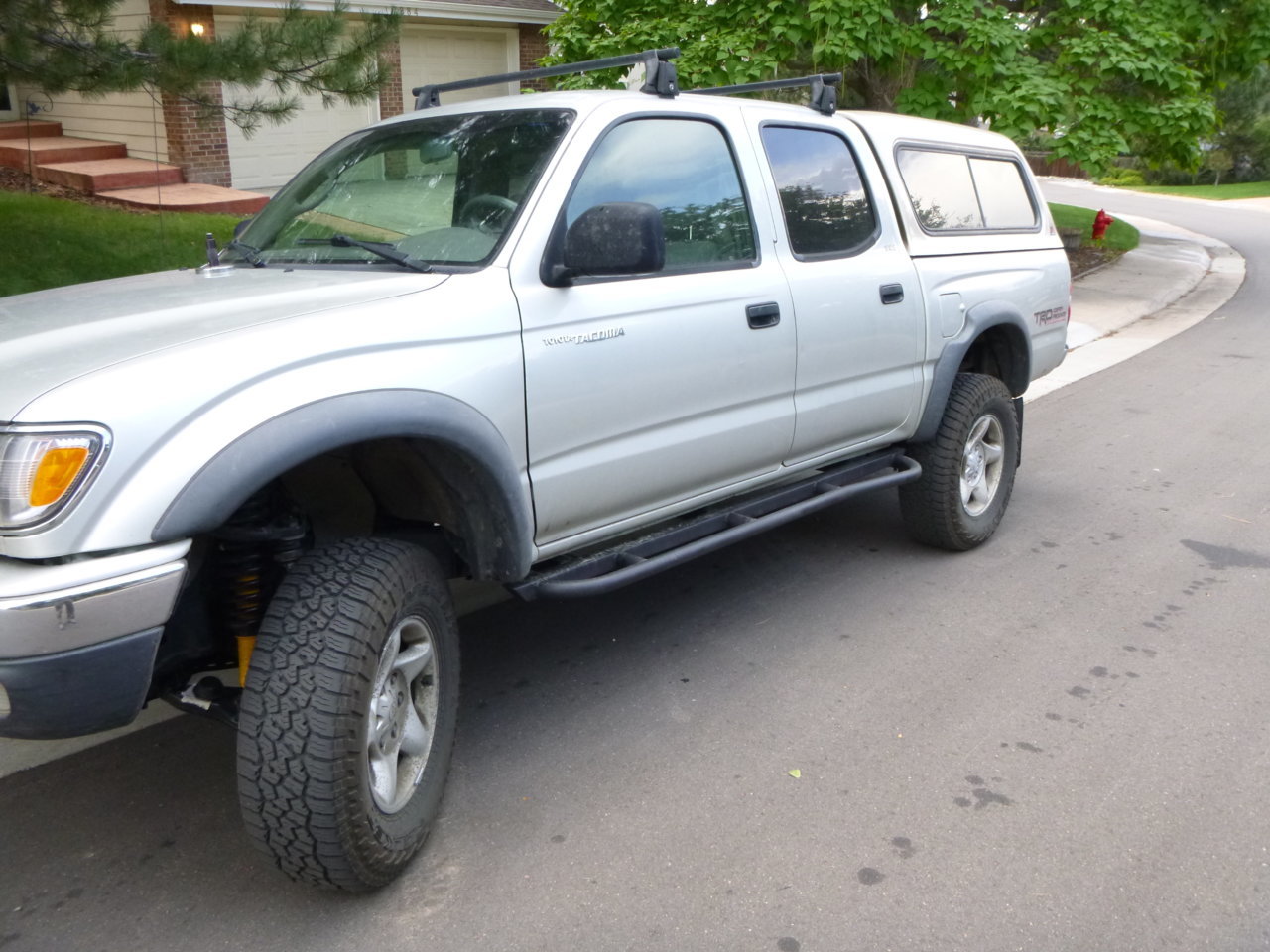

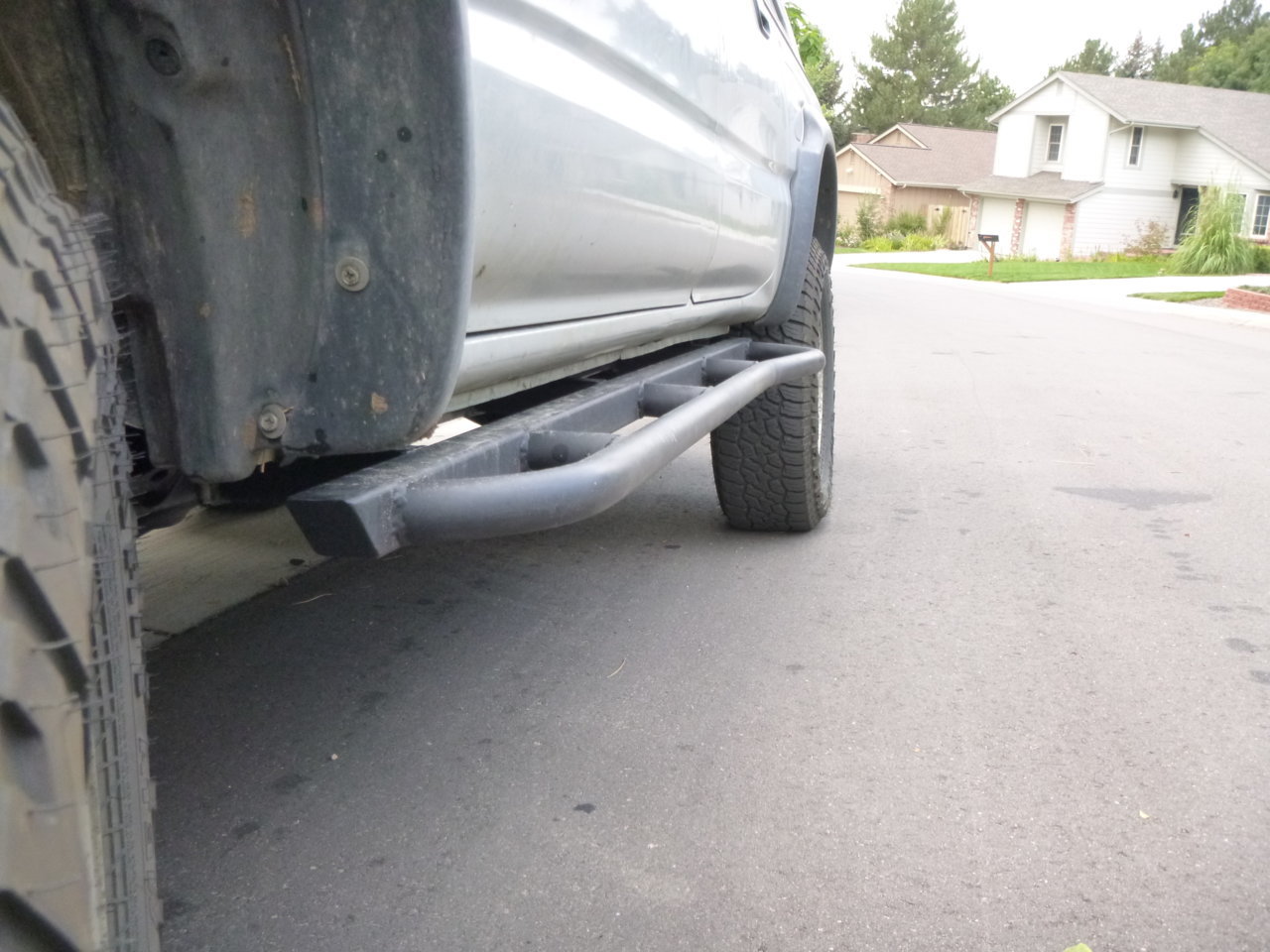

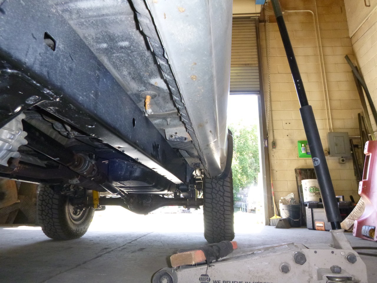

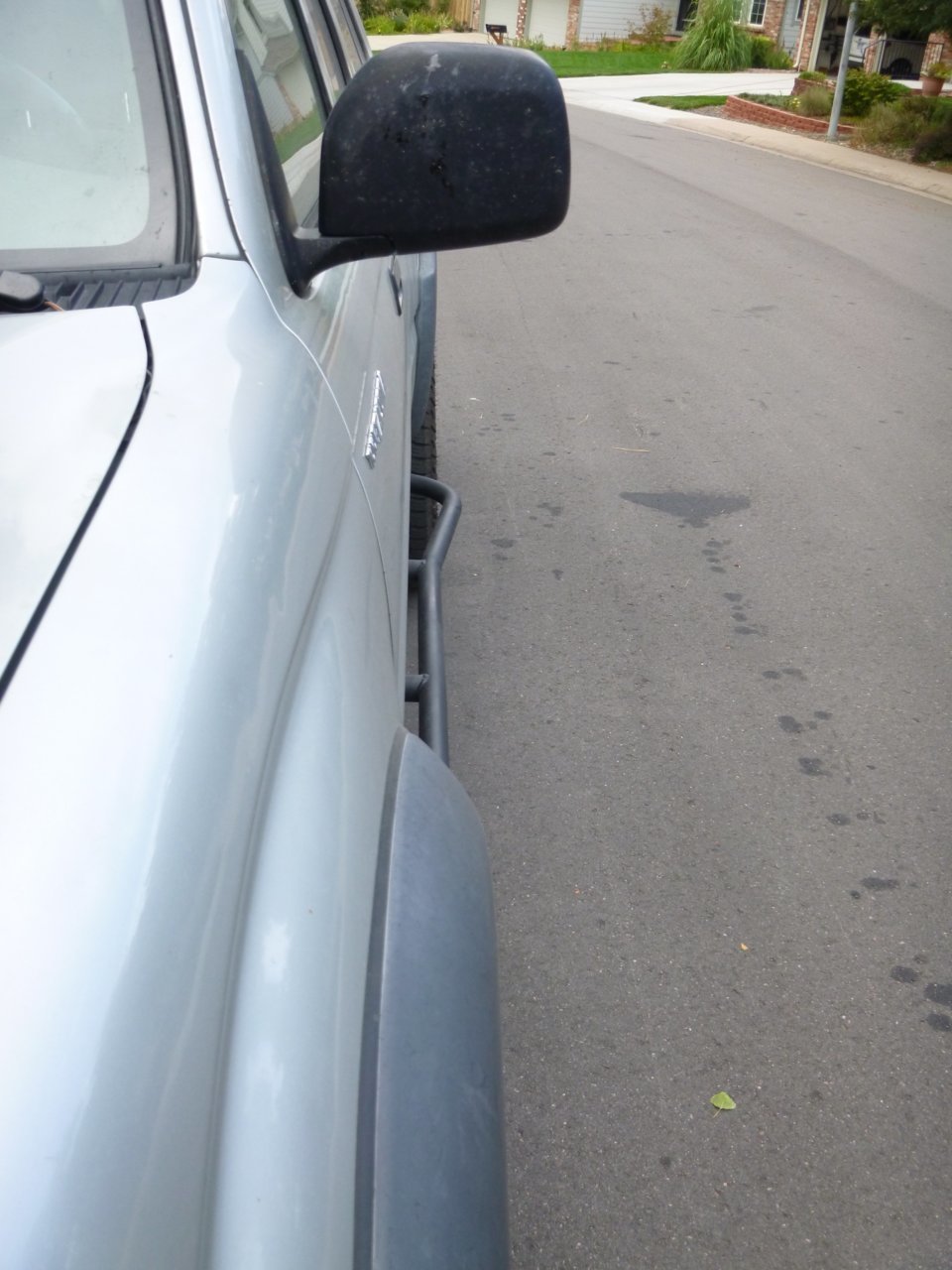

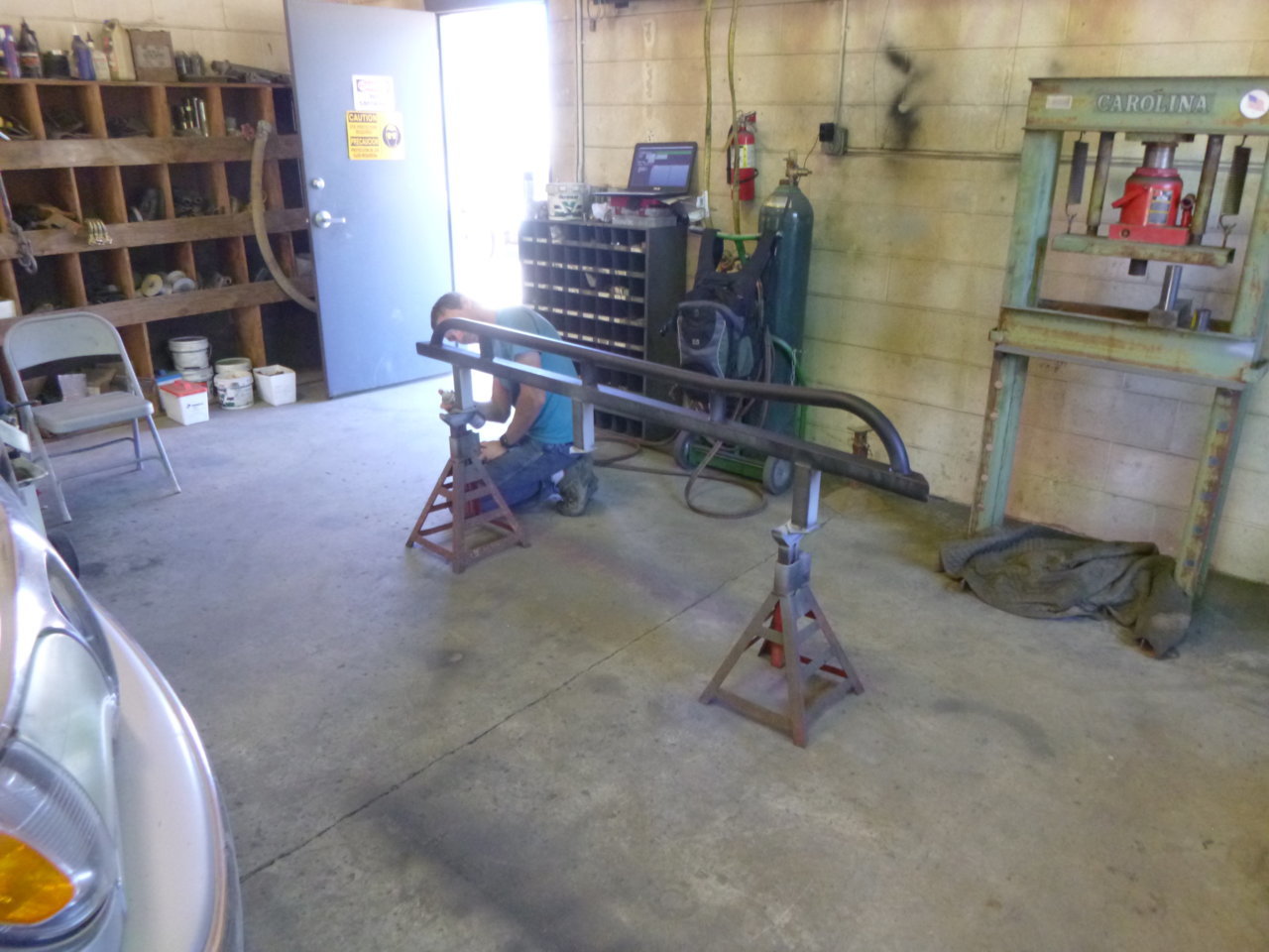

    I have been remiss to not publicly thank @YamaDirtrider and that filthy mouthed fool @Red Baron for the sliders they kindly installed last weekend on my 1st gen '04 DC TRD. So... here's a BIG shout out to these two TWers for their custom 1st gen sliders, $500 out the door. (I opted for HREW, fwiw.)
    Ultimately I decided to go flat. Probably a good thing I hadn't remembered how @lambo did his. That was the mall crawling / trail crawling look I had been considering. Yama & Baron would have been happy to do them that way, but in the end, practicality won out: this is my survey rig, and by putting the sliders @ 0° I maximized their utility as a step, which was a consideration for wife & family.
    Here are some photos...

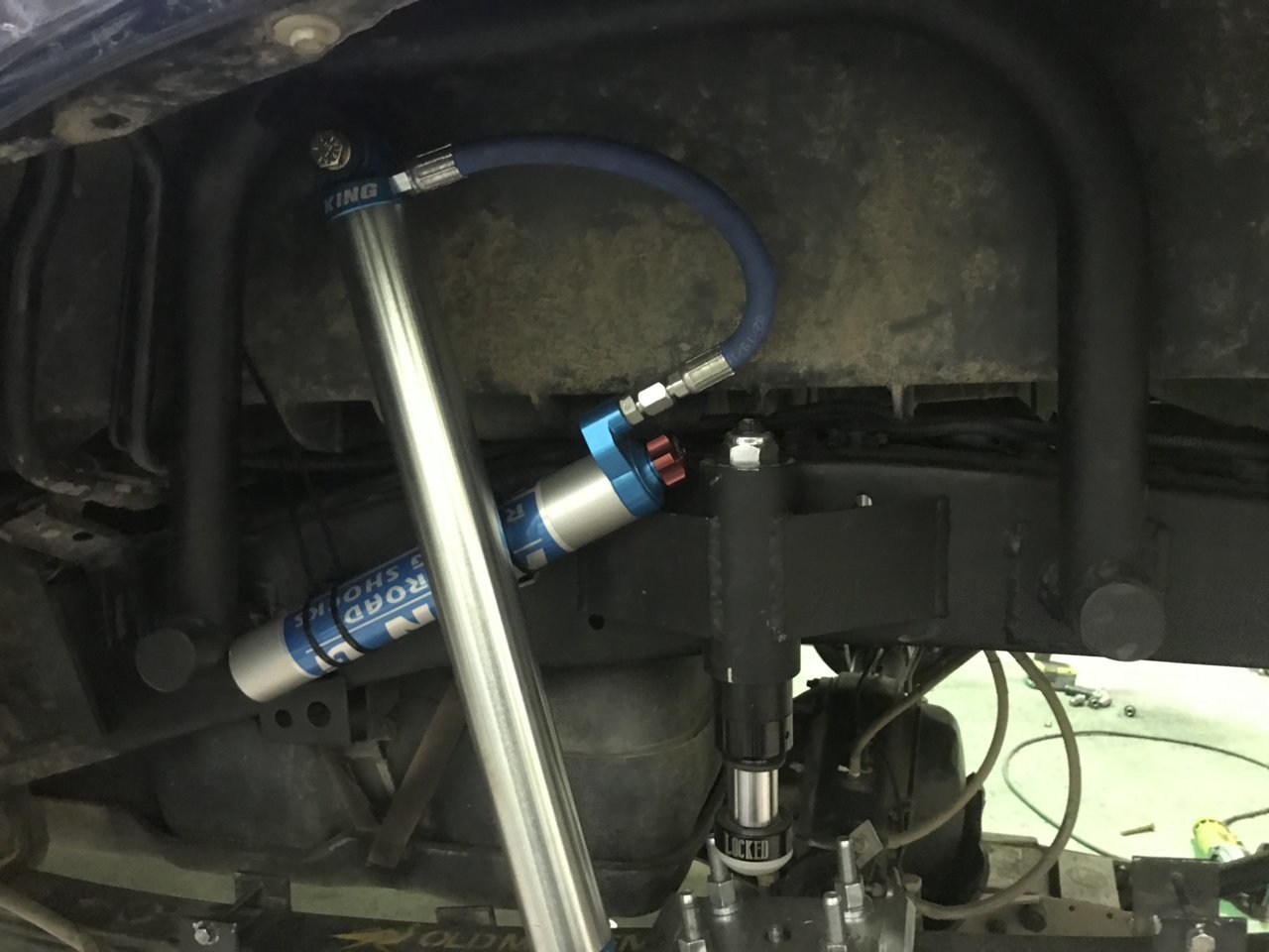

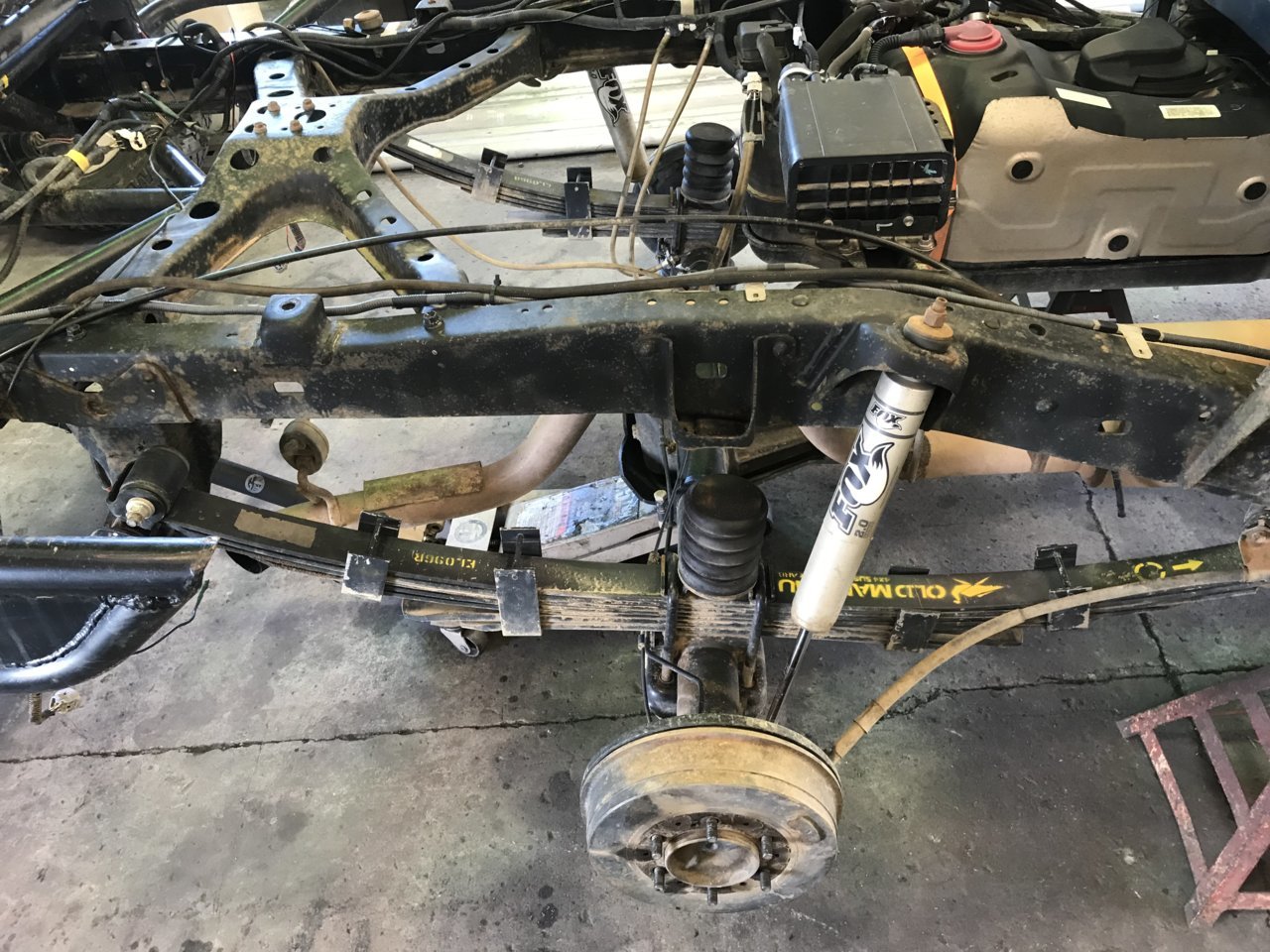

    Finished another large project! 14” custom relocates!
    Old: 18086CF7-0E6A-4AF9-80C2-571E6F40BD12.jpg
    New: 1409F81E-6F16-4174-92B8-90F42DBBAC60.jpg

    Nice. Looks like you got the bed back on too.

    That resi location needs to change, you will crash parts together.

    Yea.. it was the best for what we had to work with. I’ll have to get with you to get some longer hoses.

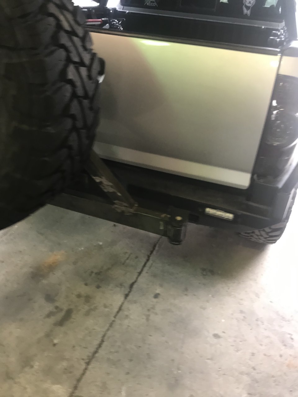

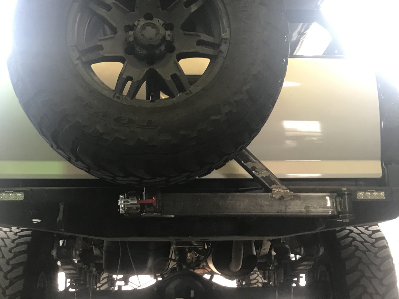

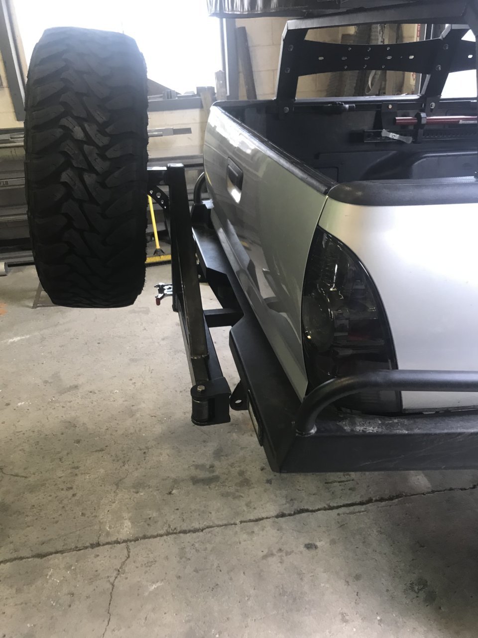

    Newest creation
    Swing out hitch tire carrier. For the trips you need the spare out of the bed.
    This one is for @50 amocaT
    we’ll get more action shots in Moab next weekend 417EB62A-C571-4A69-9B1B-9F27E54C57C0.jpg C85AD8F7-1FA4-4B78-A154-9D9F836C4DB6.jpg9FD5D109-82B8-4169-AEB5-4C13E6465F50.jpg

    This the truck that Aaron called about? Looks good. Interesting Resi location but not really space to put it anywhere else, cool idea. Those 2.0s definitely have more room around them than the 2.5s.
    Look at ruffStuff they have some good cheap weld on resi brackets. They work really well.

    Yea. The mount location has to change though. As it’s too close to the shock.
    Gonna meet up with @TMFF this week and get the resi hoses rebuilt to locate them above the shock, bolted to the bed.
    Already have ruff stuff resi mounts, and used there shock mounts to the axle and upper tube.

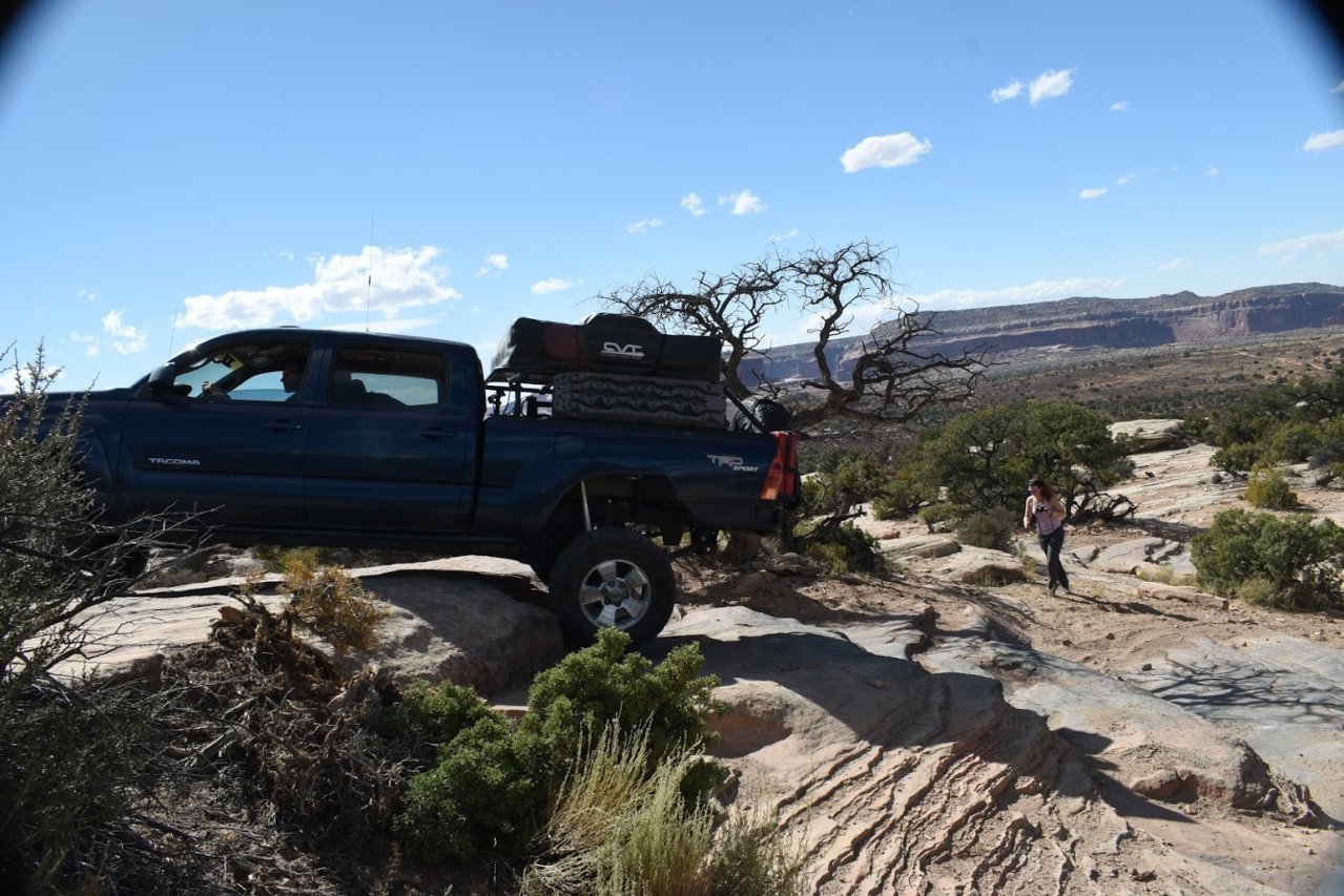

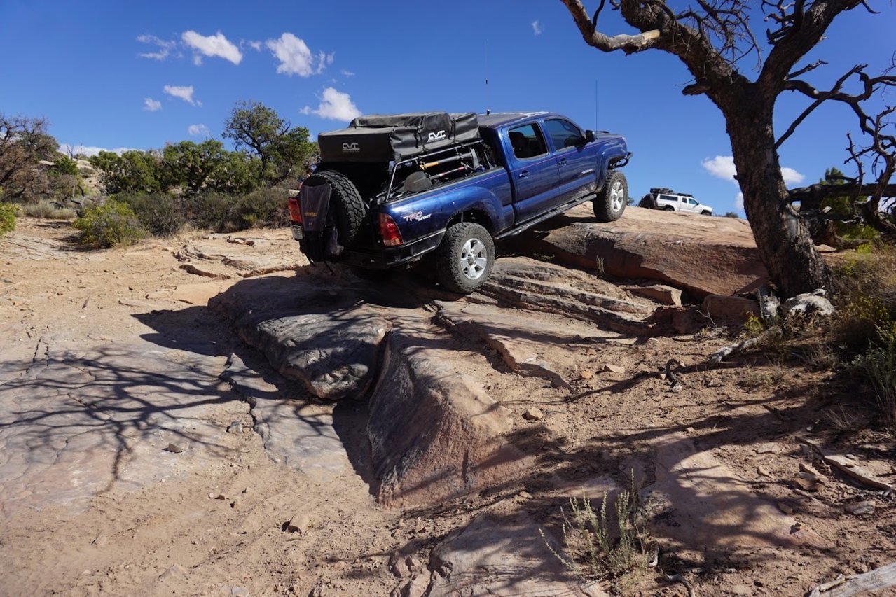

    @Littles scared! And in low-low sounding like a jet screaming at 2mph:rofl:
