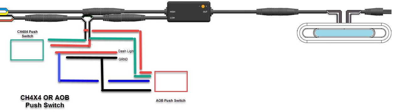

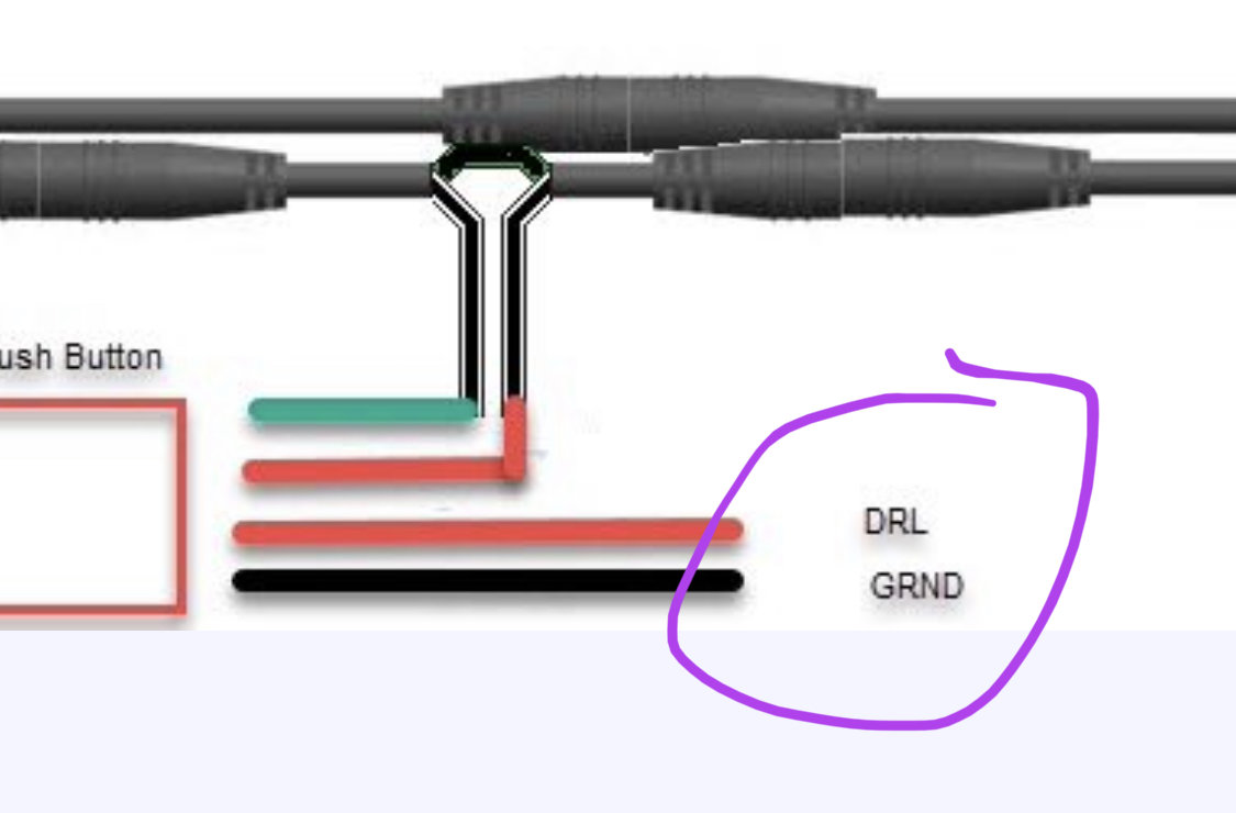

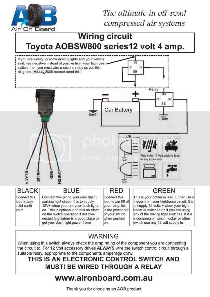

    The colors to the left of the drawing (Blue - Dome Relay (+), Yellow - ILE =dimming and Green - Panel, White with Black stripe = Ground) are the circuits that are tapped, not the colors of the cables used. But you got it as you like it:burp:

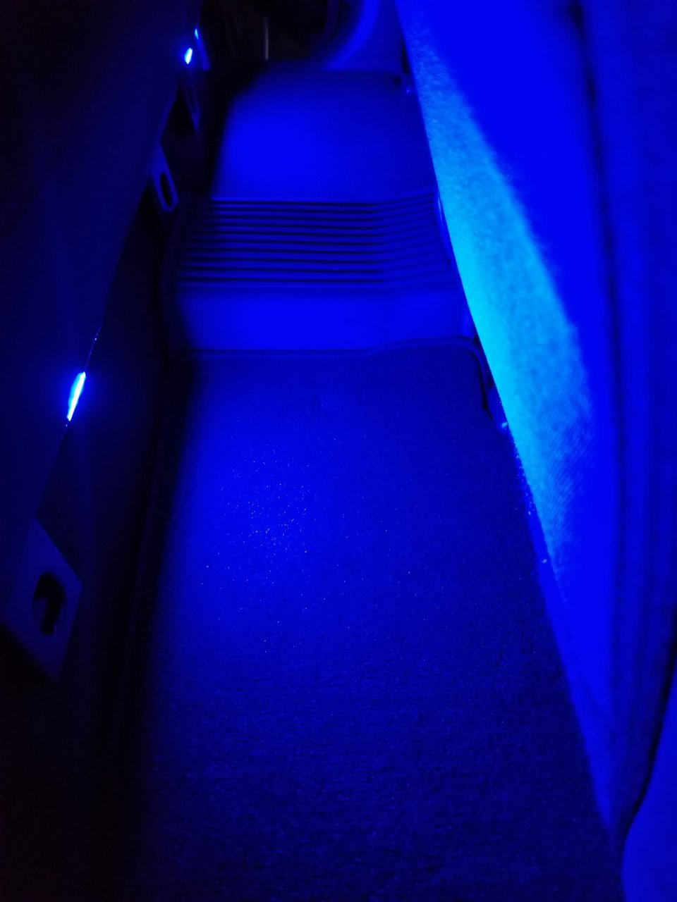

    This is why I want to have an aqua blue option in the back of the truck.

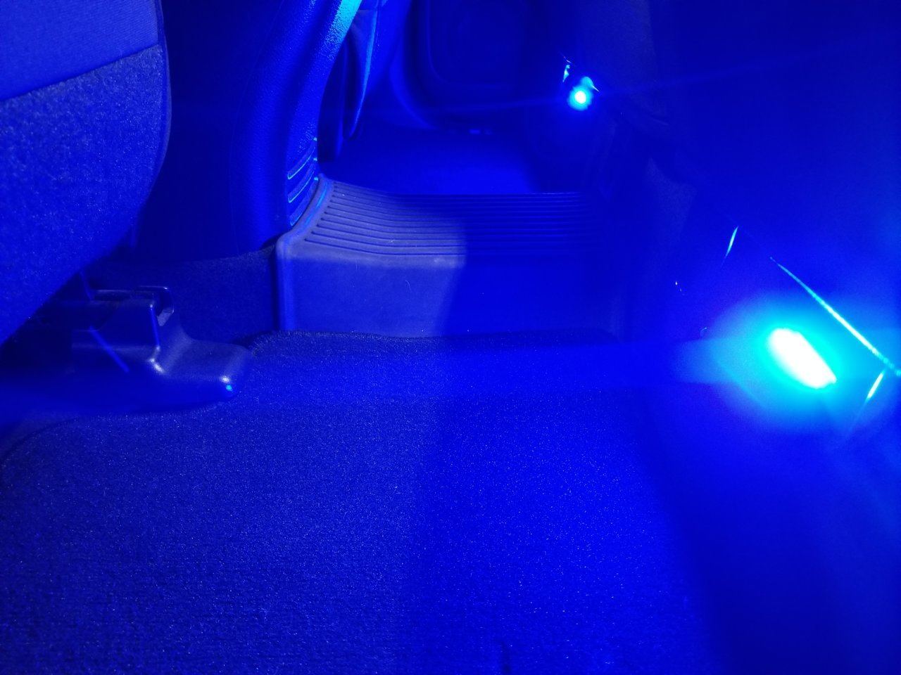

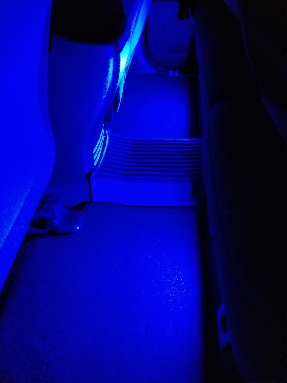

    Blue is the shit! Hahaha!:D
