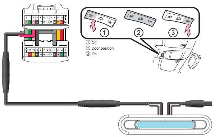

    There are no wires branching from the overhead console switch (Door, OFF, ON) to the dash.
    @kmorgan3 has had the intercept harness for the overhead console (R44) for some time now. He might want to assemble a 2.0 and 3.0 version of it for you and others.
    One would have what is required for your taste. But still a pair of wires need to be routed from the overhead (console removal) down by driver's pillar (no disconnecting harness there), secured along the way by your preferred method. Finishing at the module (optional).

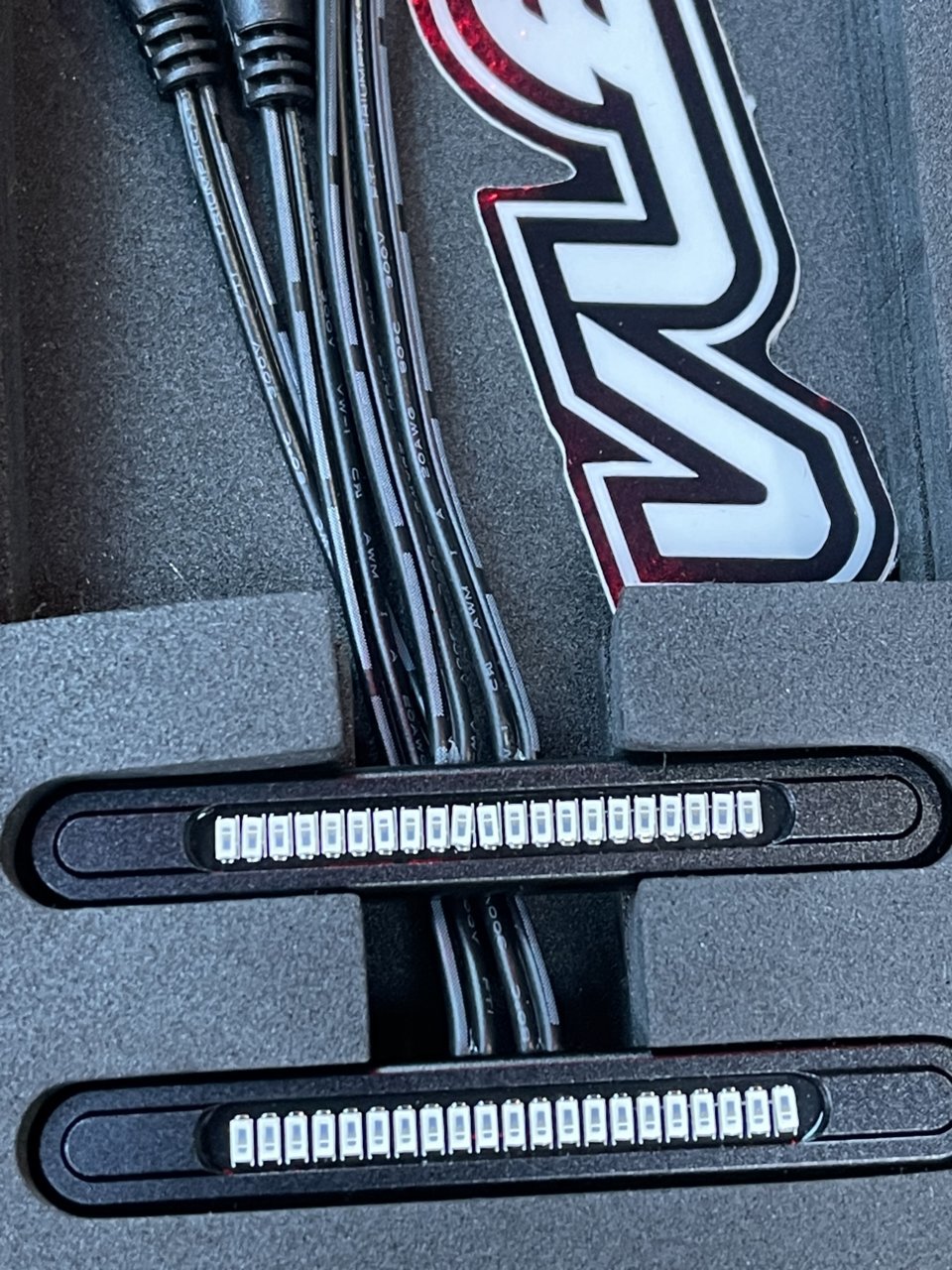

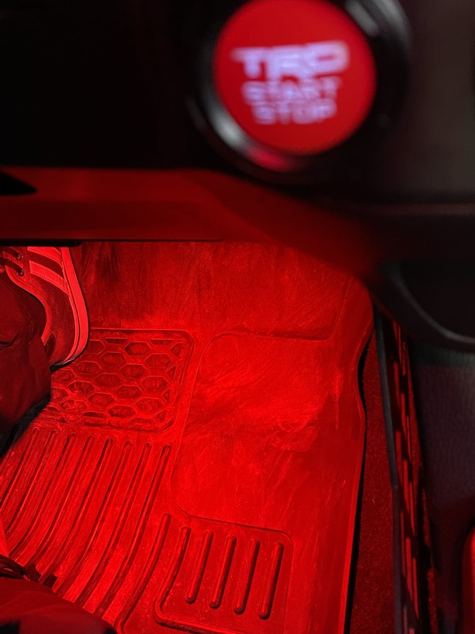

    Got mine installed today, probably took me around 45 minutes, 15 of that was multiple failed attempts to get the wire to drop down along side the dash and then another 15 trying to get everything crammed back in the A pillar and get the pin lined up properly. They look awesome though so it was worth the time and effort.

    Finally got my set installed, one of the LEDs was skewed, doesn’t appear to affect function tho . Anyone have a hell of a time getting their LED to stick to this plastic? I scrubbed the hell out of my plastic with alcohol and lint free wipes and she just didn’t wanna stick. I had to switch to my own grey 3m vhb, even those had trouble. Also stuck my pwm to the side of my meso fuse cover haha.

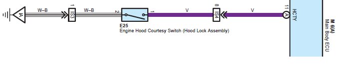

    Like using the hood latch to trigger an under hood light? The center screen on the gauge cluster tells me when the hood is open, so there must be a sensor that we can borrow the signal from.

    There is a little tiny tab on the latch that makes contact and likely closes the circuit for the hood open display. I didn't bother with that for my light activation but instead, replaced one of the 4 rubber hood bumpers attached to the front crossmember, with one of these grounding plunger switches. I ran power for the light to my accessory Power Tray so it's fused appropriately, and then ran the ground to the newly installed plunger switch. I used 1 Harbor Freight Rock Light mounted in the front end of the hood in the center and it throws great light throughout the engine bay. Cheap and easy.

    You just need a simple pin switch for that one; no need to get overly complicated.

    Those switches have been unreliable for me in the past. Likely due to corrosion.
