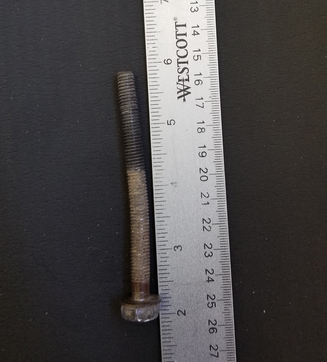

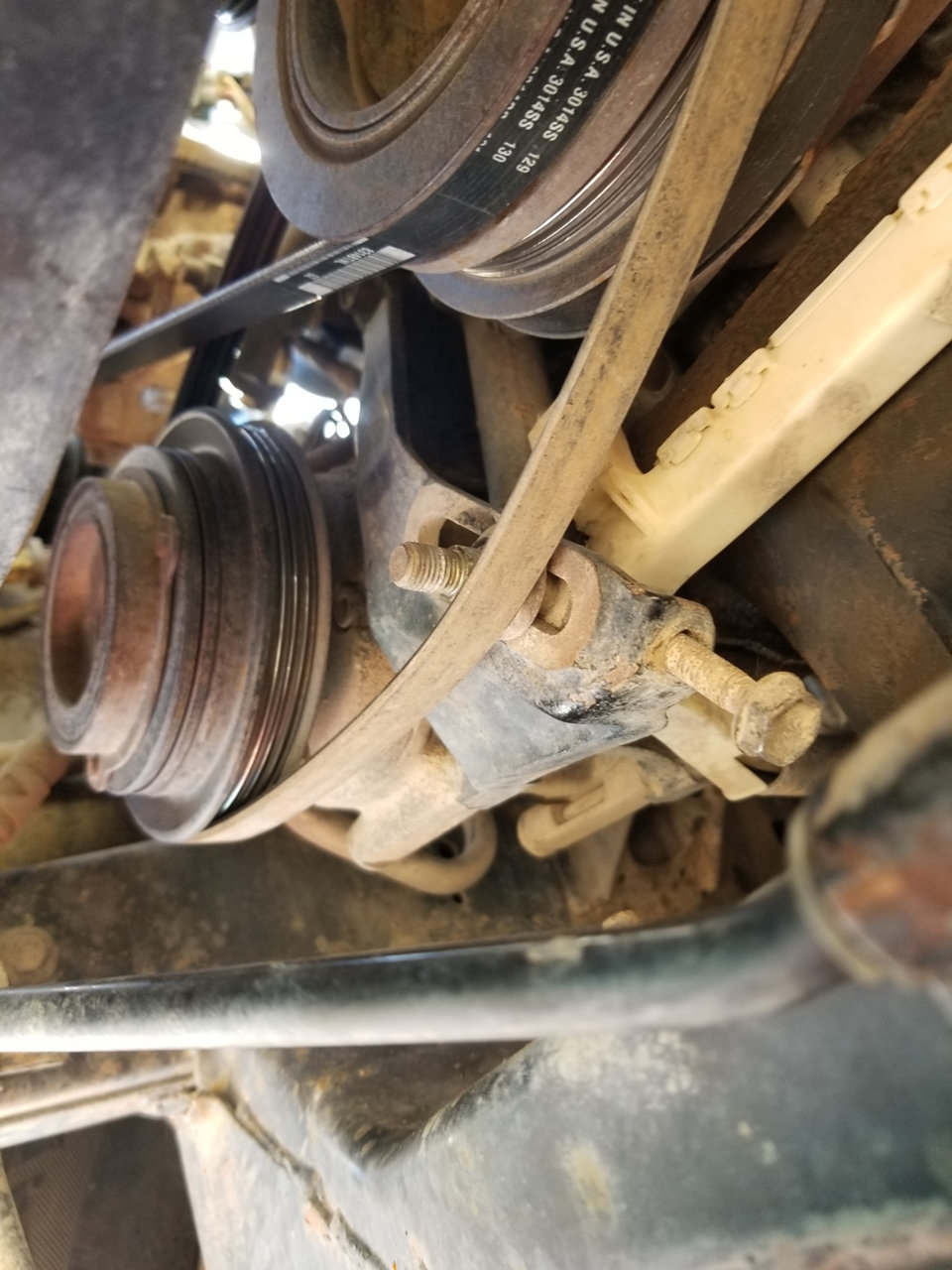

    I've had this issue since I've owned my truck, so since early late 2016 early 2017. Asked multiple mechanics to take a look at it and they never have a good answer. I had the timing belt replaced, and the water pump replaced.
    Recently I've become more mechanically inclined. Swapped my clutch, did valve covers, replaced my entire suspension etc... So I did some digging on this and ended up here and a few other pages.
    I replaced my Idler Pulley yesterday and it has really helped w/ the whine when in idle/neutral and when in 4th - 5th gear on the highway the whine is completely gone. But I still have a bad wine when accelerating.
    Like mentioned before, when the truck is put into 1st gear, or any gear between 1st and 3rd it sounds like whine/wain of landing gear on a 747 coming down, but consistent. It is very apparent in 1st gear, extremely apparent in 2nd gear and then starts to get quieted down in 3rd, then around 1500-1700 RPM in 3rd gear it goes away almost completely. From 3rd gear to 5th gear you can hear it EVER so slightly when you release the gas and the truck is gliding/idling at the speed given. It was muuuuch louder between 3rd and 5th gear before the idler pulley swap.
    When I swapped my idler pulley out, I found that tensioner/carriage bolt was bent down toward the tension of the pulley. I think either someone over tightened it, or since the bearings were so crap it was causing extra strain.
    I -The next step will be to replace all the actual belts. I have new ones sitting in the garage. Here's a good video from Tim on how to do that
    II -If that doesn't fix the issue I'll be replacing the #1 & #2 Idler Pulley along w/ the cam shaft and crank shaft seals and checking my timing belt pulleys, camshaft pulleys, harmonic balancer etc and associated parts since I know the mechanics didn't really do any of that w/ my timing belt change (2k down the drain.) Here's another good vid from Tim on how to do that. I'll probably start by getting the cover off and running the truck for a minute or two in a clean area and seeing if I can track down the whine w/ a stethoscope.
    Here's a visual of why you'll want to change your bearings:
    Bent Carriage/Tension Bolt for Idler Pulley
    Location of Pulley (Removed), Part # 88440-04040
