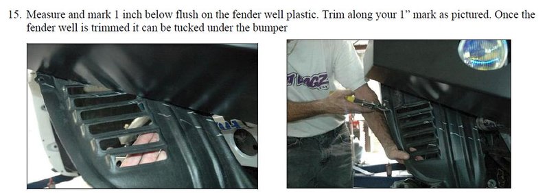

    150lbs with everything.
    Mine are zip tied. No problems.

    As said before, the ARB instructions tell you to do so. Take the zip ties off and move yours up more out of sight.

    Fwiw plastic zip ties last longer than the steel ones, over time the steel zip ties lose their "grip"

    Trimmed and zip-tied for a year now and still no problems!
    Keeps the mud out of the engine bay!:D

    Or you can do what I did and that is cut the plastic inner fender wells completely out
