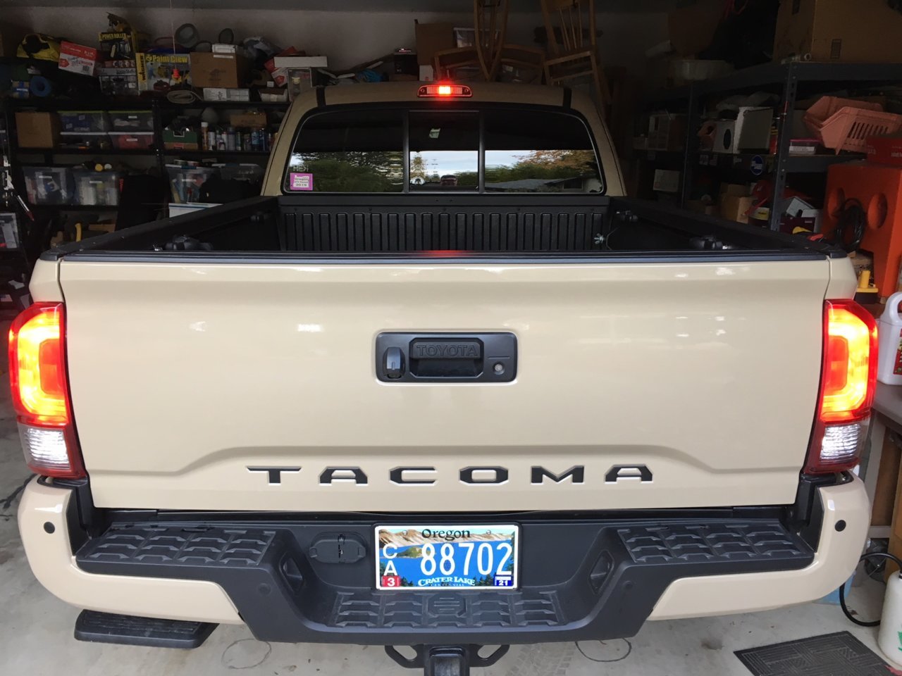

    I installed led tail lights with the Diode Dynamics Tail as Turn module and they have worked perfectly. It wasn’t plug and play but @mesojdm is coming out with a plug and play setup real soon.

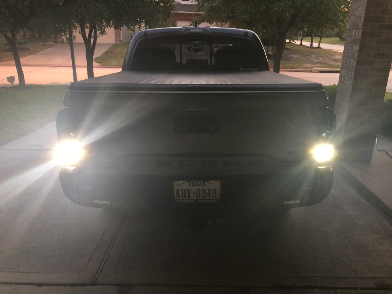

    Hello there sir! Let me see if I can address your questions as best as possible.

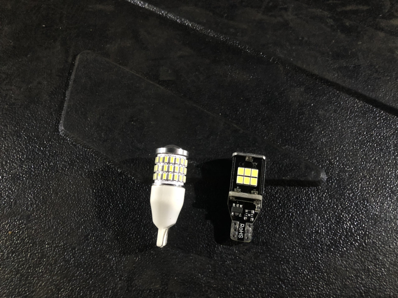

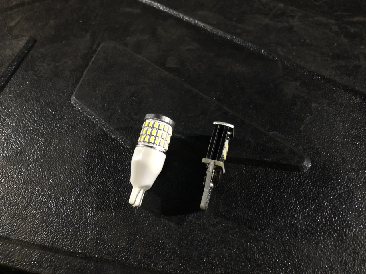

    So just to be clear, I have never replaced any of my rear bulbs other than my reverse bulbs. Pertaining to the reverse bulbs, I'd recommend you get the flat square style (see attached pic) rather than the round style. As it might seem that the round style would produce better light output, it actually does not. I have tried several different round styles against the flat and the flat style has one each time. The picture showing comparison has the flat style on the left and the round style is on the right.
    As for built-in resistors on turn signals. The only brand I know of that doesn't require them at all is @deAutoLED.com. I am running their front turn signals only which are incredible, but the rear bulbs claim to be resistor free also.
    I no longer have Winjet taillights at all anymore because they had way too many issues and TacomaBeast quit selling them for that reason and they hooked me up with a different style from a different manufacturer. The new set I have is AMAZING. They look great, perform very well, great light output, and I have had no issues at all. You can take a look at those HERE and a link to the purchase page is HERE.

    I should have been clearer in my original post, I used led’s By Sylvania 7443R that I bought at Walmart, Diode Dynamics tail as turn module and 6 ohm resistors to prevent hyper flash.
