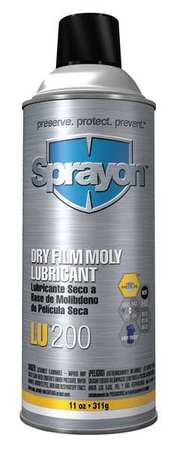

    I don't know anymore!
    I would suggest an over based calcium sulfonate grease, elastomer compatibility is important. PTFE, Nitrile are most common. TS-115 and a yamaha brand are two I use. Also, a dry film Moly Aerosol works great for uni ball applications.
