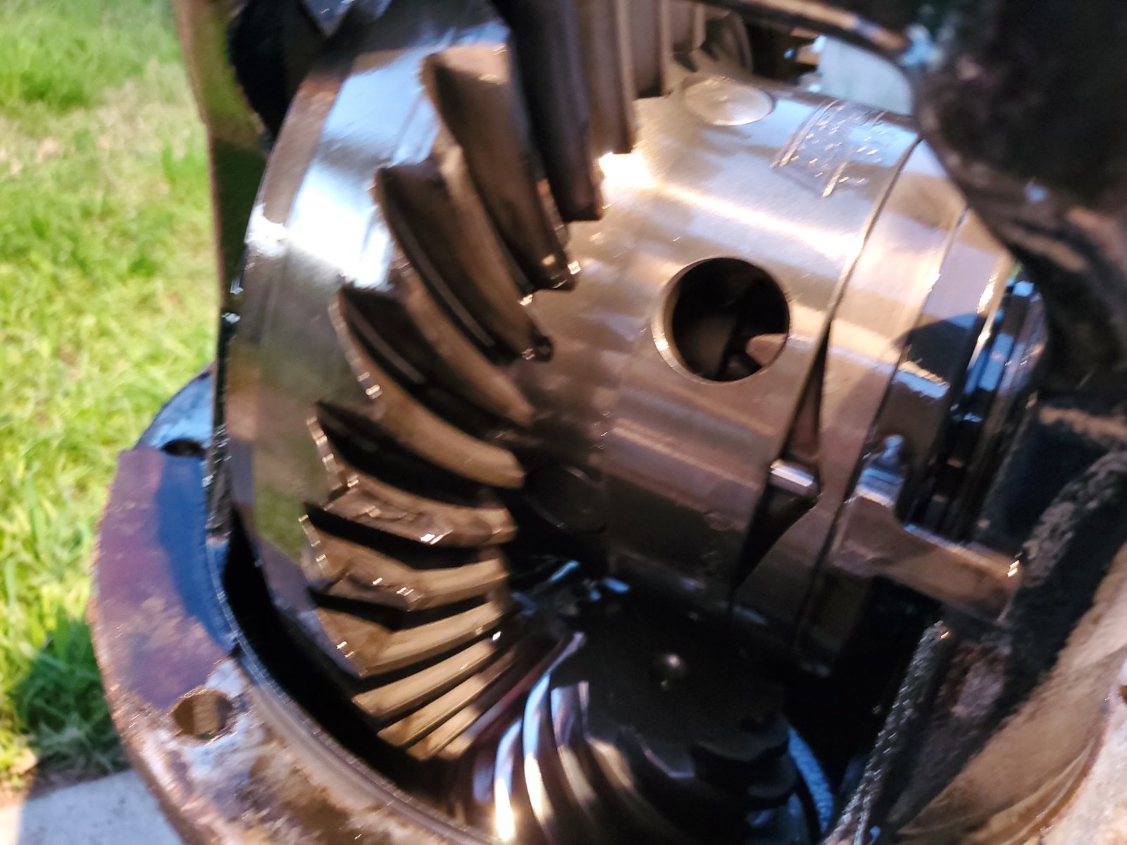

    @Jon64l does a lot of that kind of terrain in AZ with the 8.4 and a Harrop in his 1st Gen.

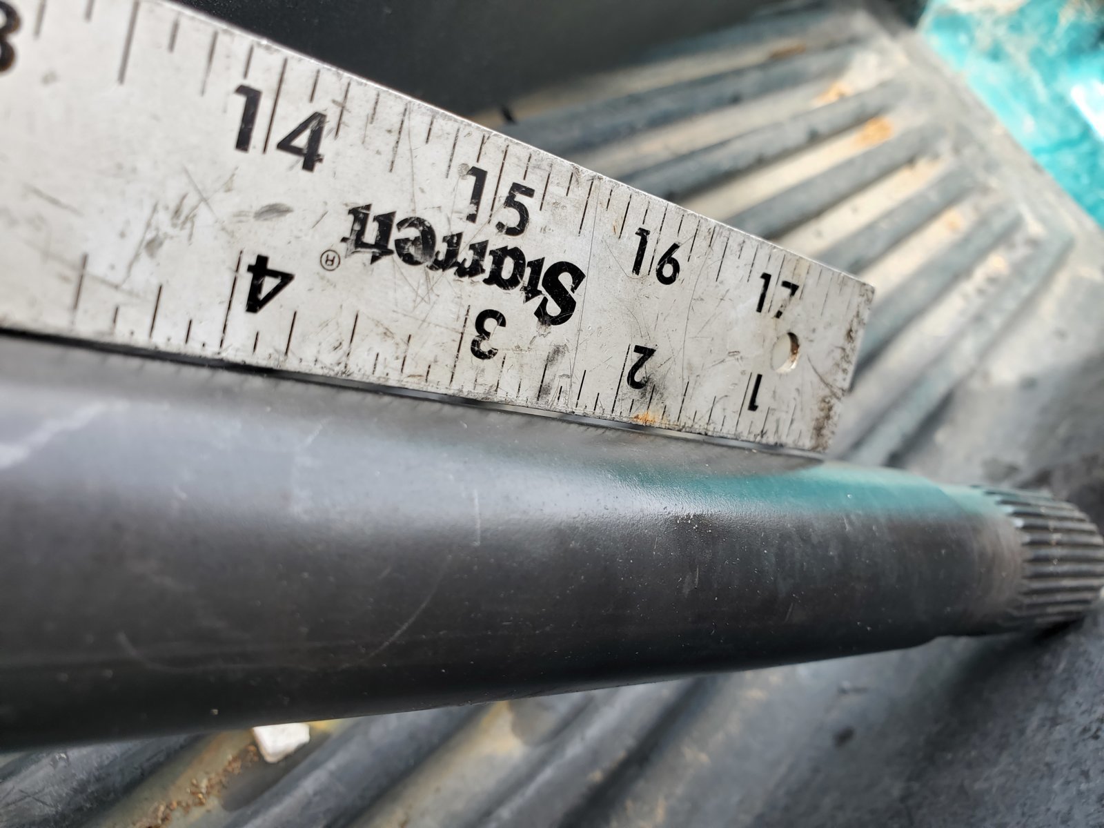

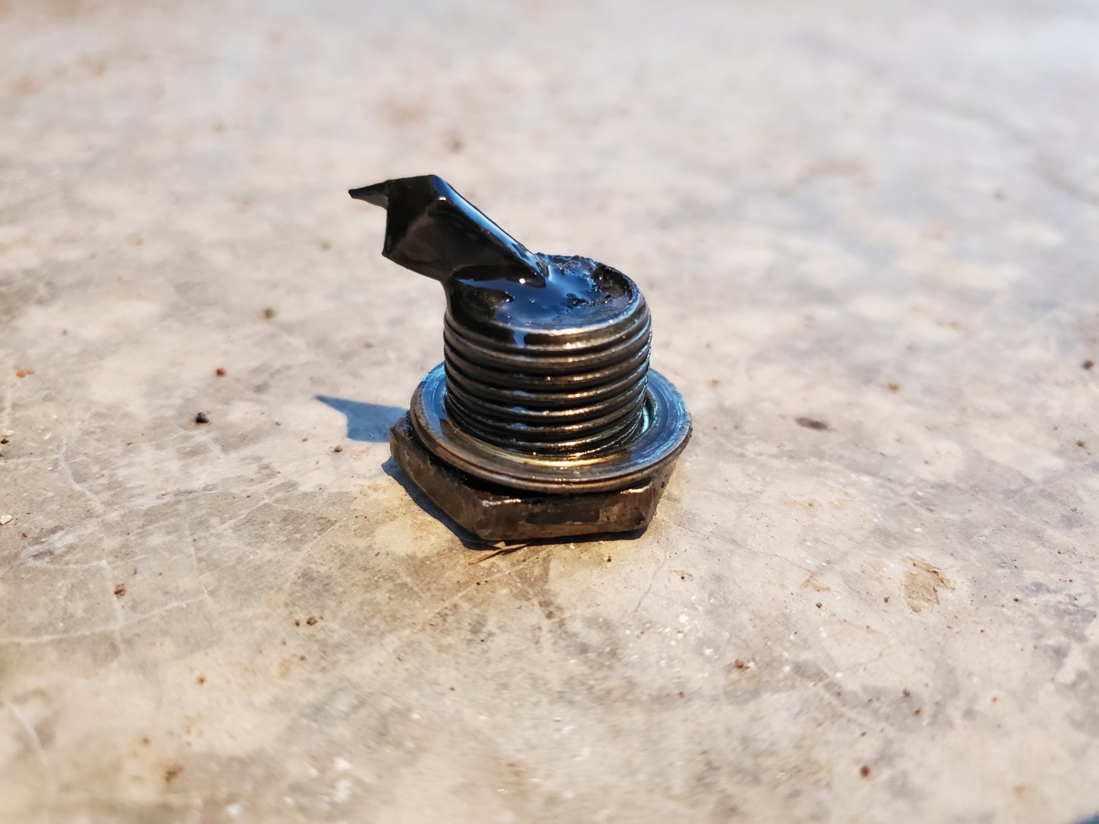

    Busted some teeth. Bent some axle shafts. 9" selectable locker would be cool but not in the cards.
