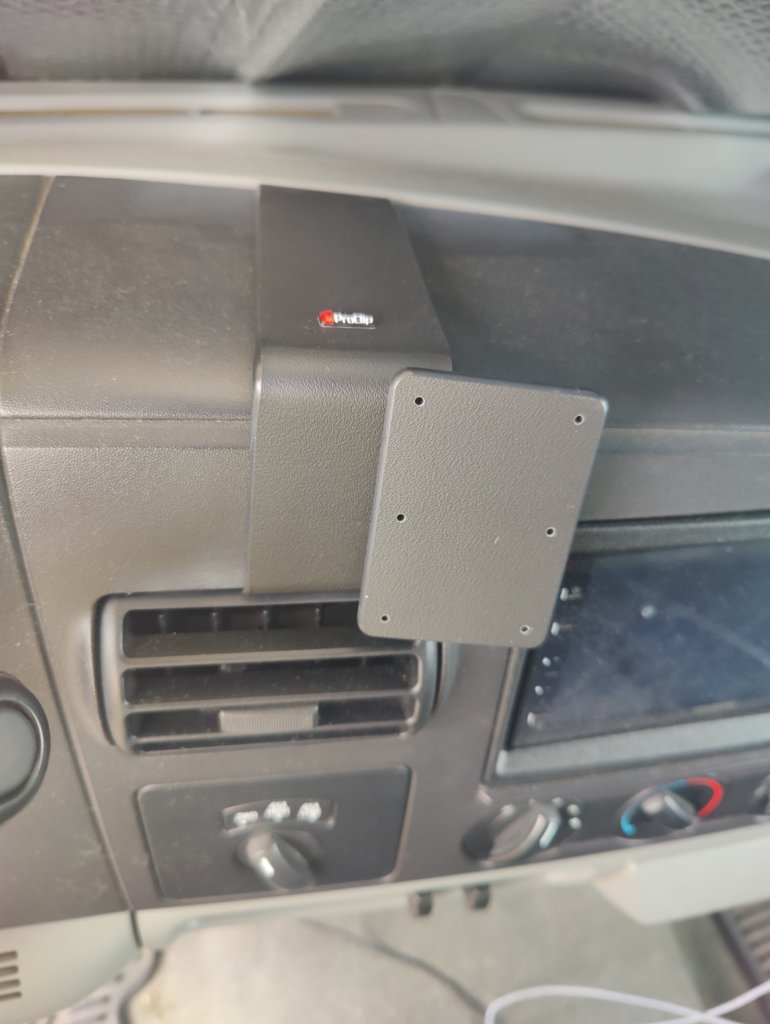

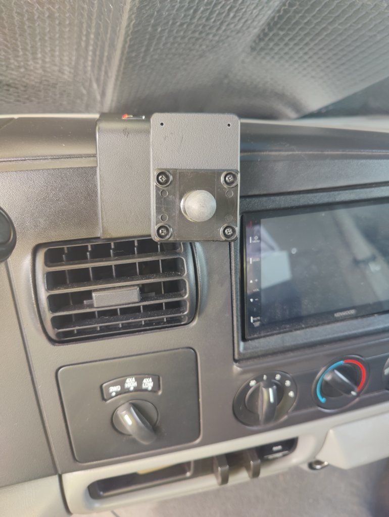

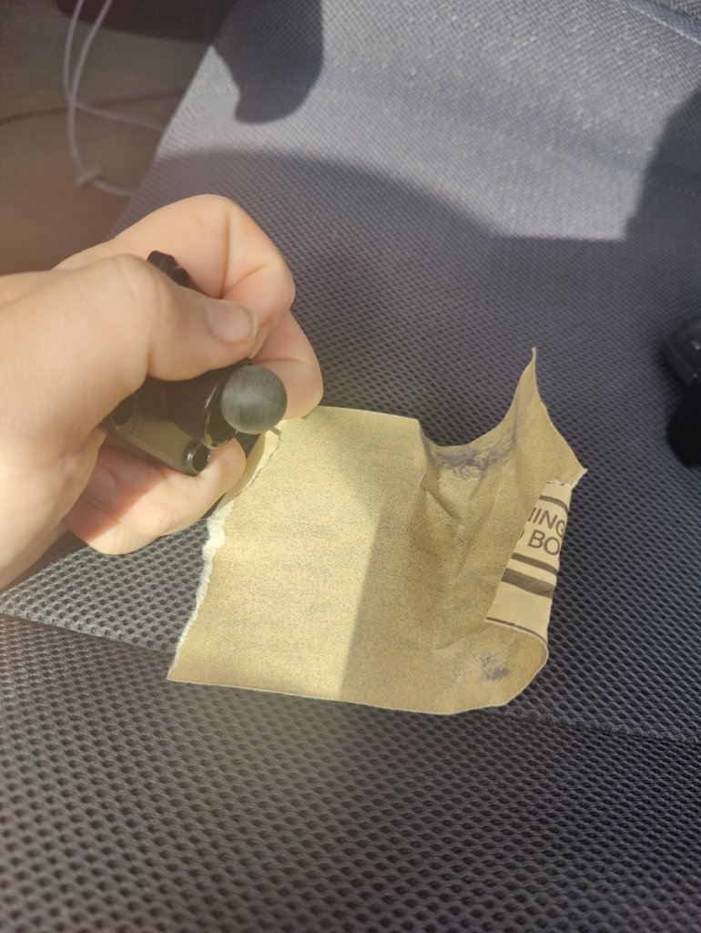

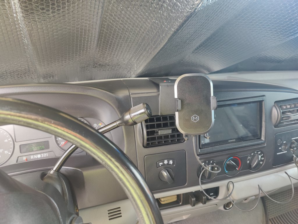

    Installed this phone holder as there isn't really a good place for storage while driving.
    The ball for the socket was too large for the phone mount. Some light sanding got the desired clearance.
    installed and works well enough. Nice and solid and can charge wirelessly.

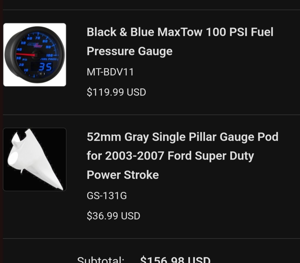

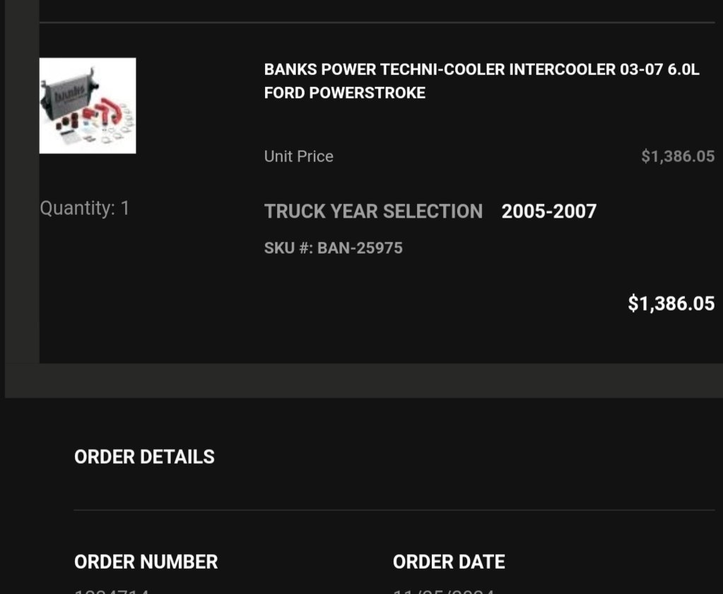

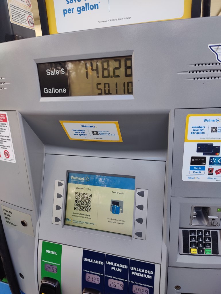

    Took advantage of the Black Friday deals and ordered a banks intercooler, fuel pressure gauge, and a tuner. Went with banks as it has the largest I.d. charge pipes and intercooler inlet and outlet at 3.5in while others are 3in. Tuner mostly for transmission tuning (sct and hptuners can only do that) they have some light tow tunes I could also try.
    The tuning can also help at the pump. Had this towing some stuff for the property, around 13k this weekend. Every little bit helps.

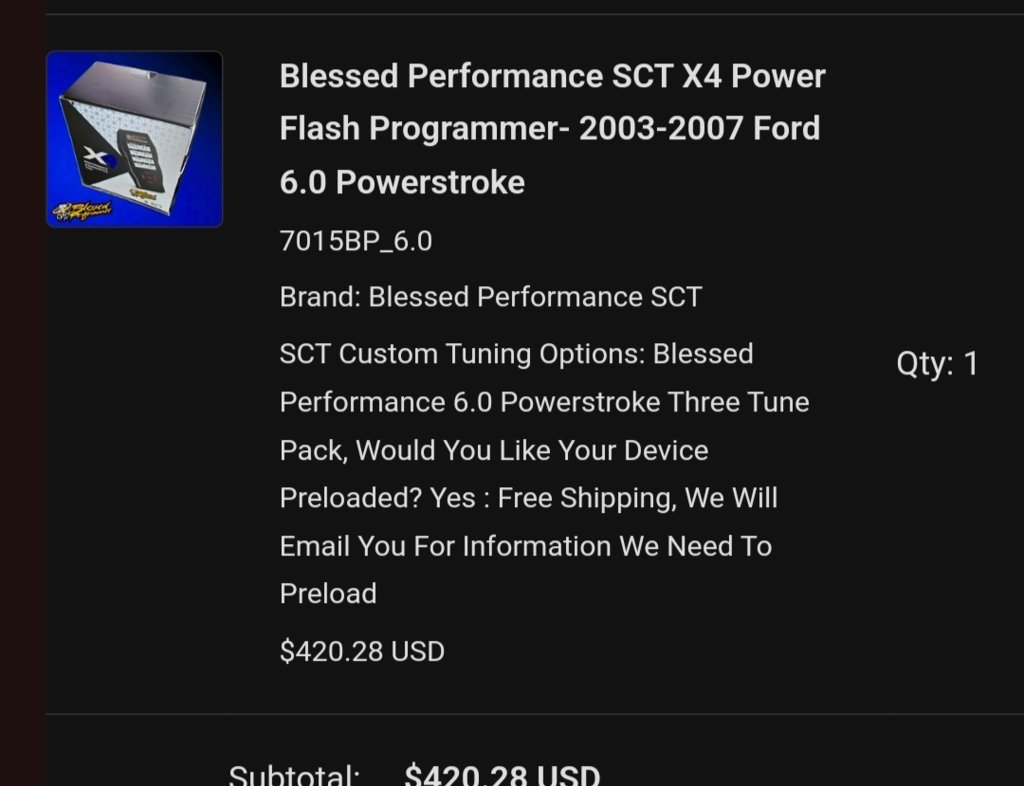

    AFE stage II intake, APR X1, URD 70mm Throttle Valve (ported and knife edged), NST intake manifold spacer, URD spec U headers, Denso IKH20, URD fuel pump, APR fuel rail, URD Y pipe, URD spec u catback, lightweight water pump pulley, Greddy sandwich cooler plate, Earls oil cooler, IPT valve body, FJ TRD shocks, Cusco front and rear sway bars, Energy Suspension rear track rod bushings and rear link bushings, Carbotech pads, Stoptech ss brake lines, Stoptech slotted rotors, Motul 600 rbf, Limited Grill, Painted hatch cover by me, Painted valve covers by me, Cobra CB, TRD rad and oil cap, Escort 8500, Autometer oil psi and temp gauges, AEM wideband afr gauge, Flexpod, Pioneer 400w speakers.

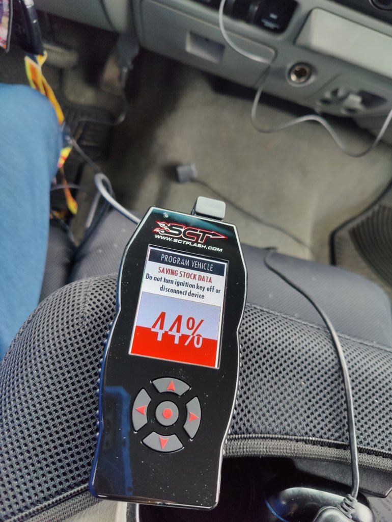

    Flashed the truck with a new tune. Didn't get anything crazy due to stock head bolts and transmission but should aid in responsiveness of the truck. Possible increase in fuel mileage too.

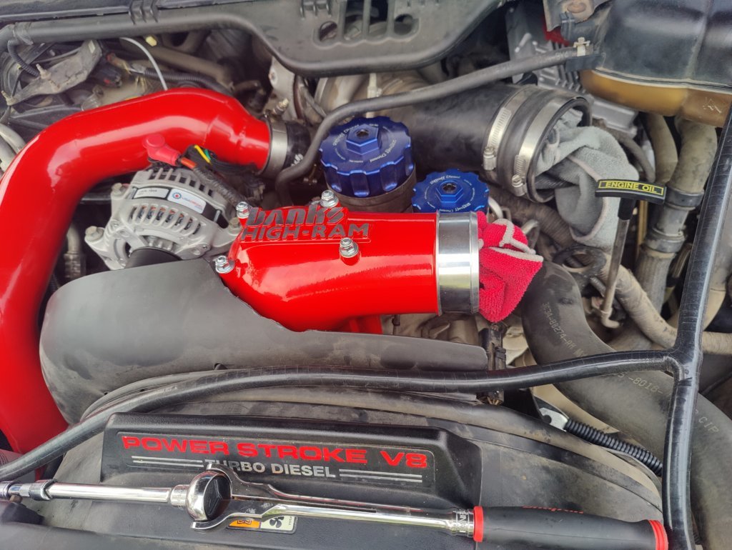

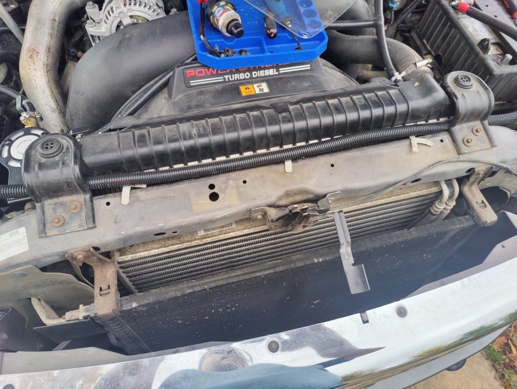

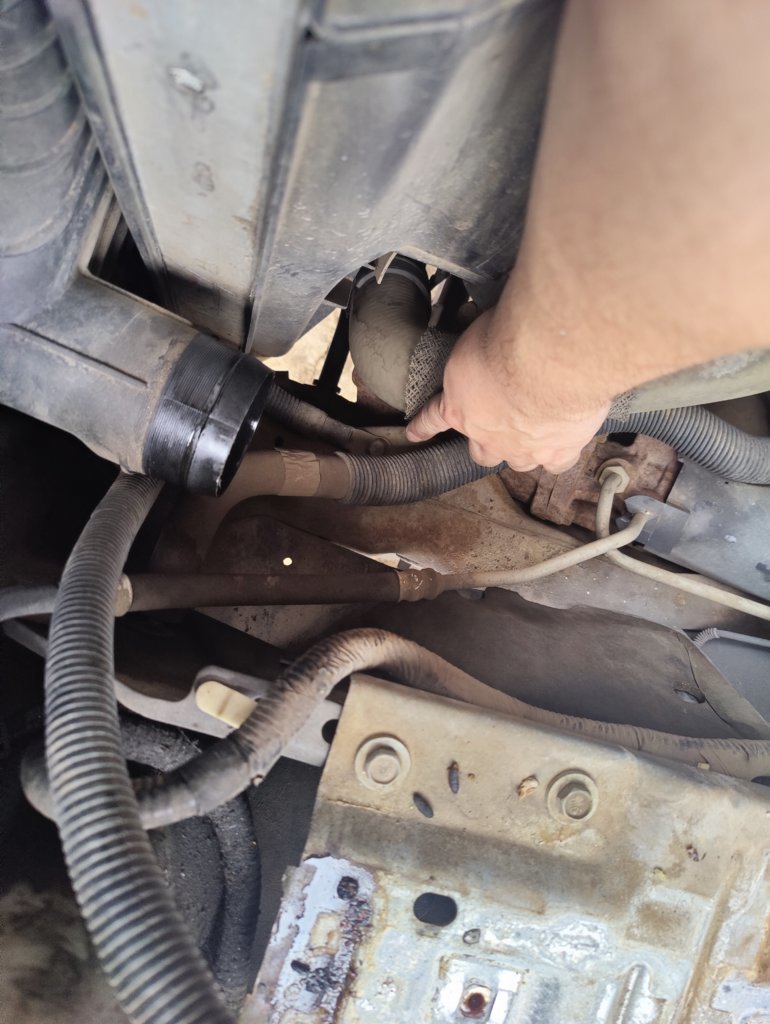

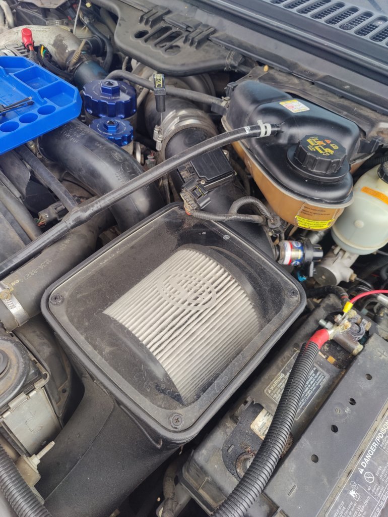

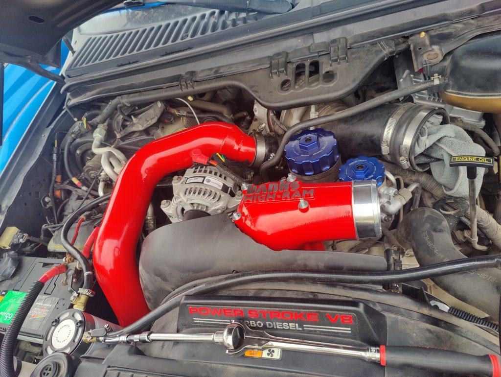

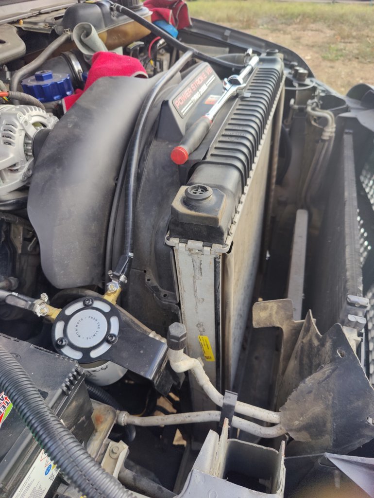

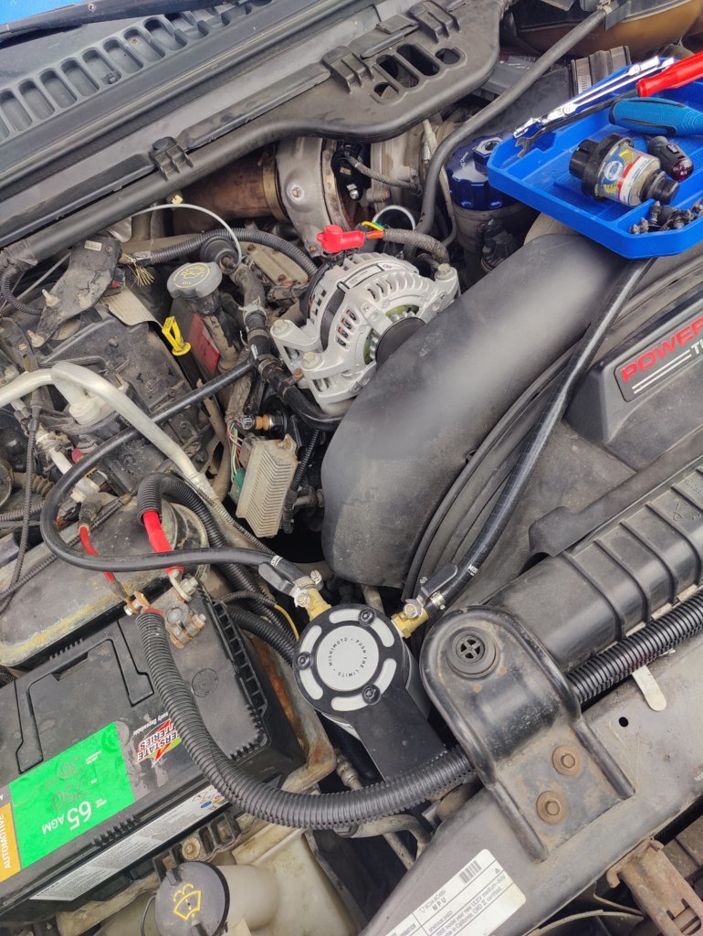

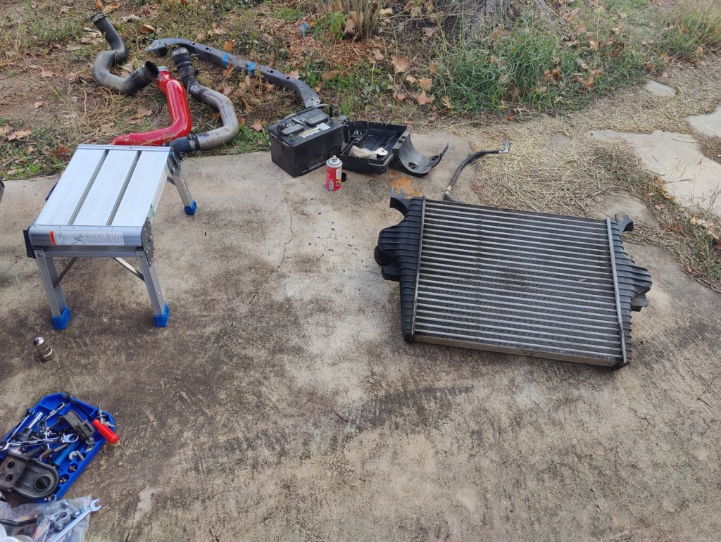

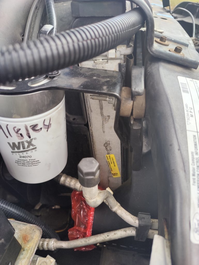

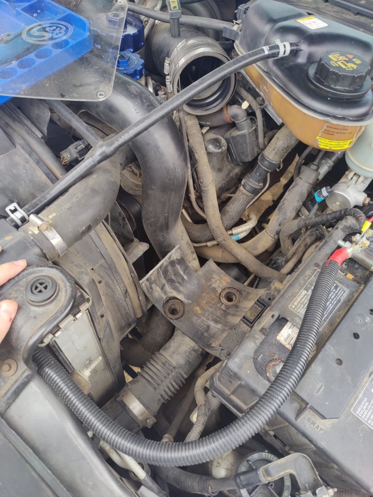

    The banks intercooler came and I mostly got it installed. Ran out of daylight.

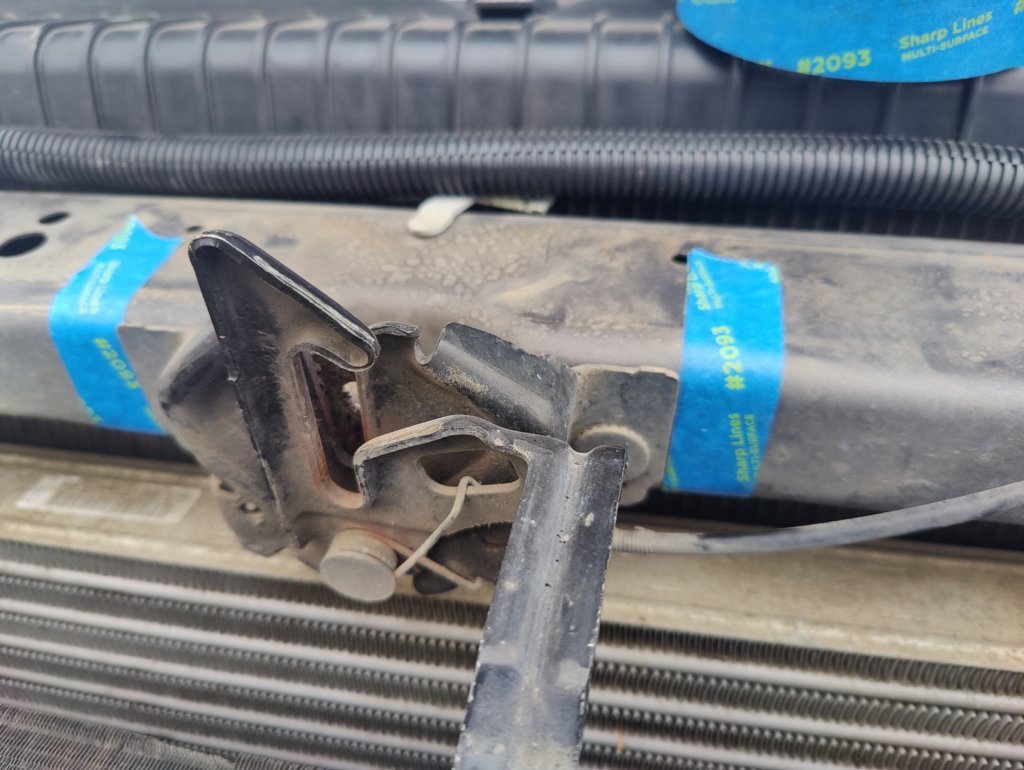

    First air box needs to come out.
    Air deflector is next to be removed.
    So some people will leave a witness mark by scratching the paint to retain the orientation of the hood latch. I prefer the masking tape.
    Hot side boost tube out.

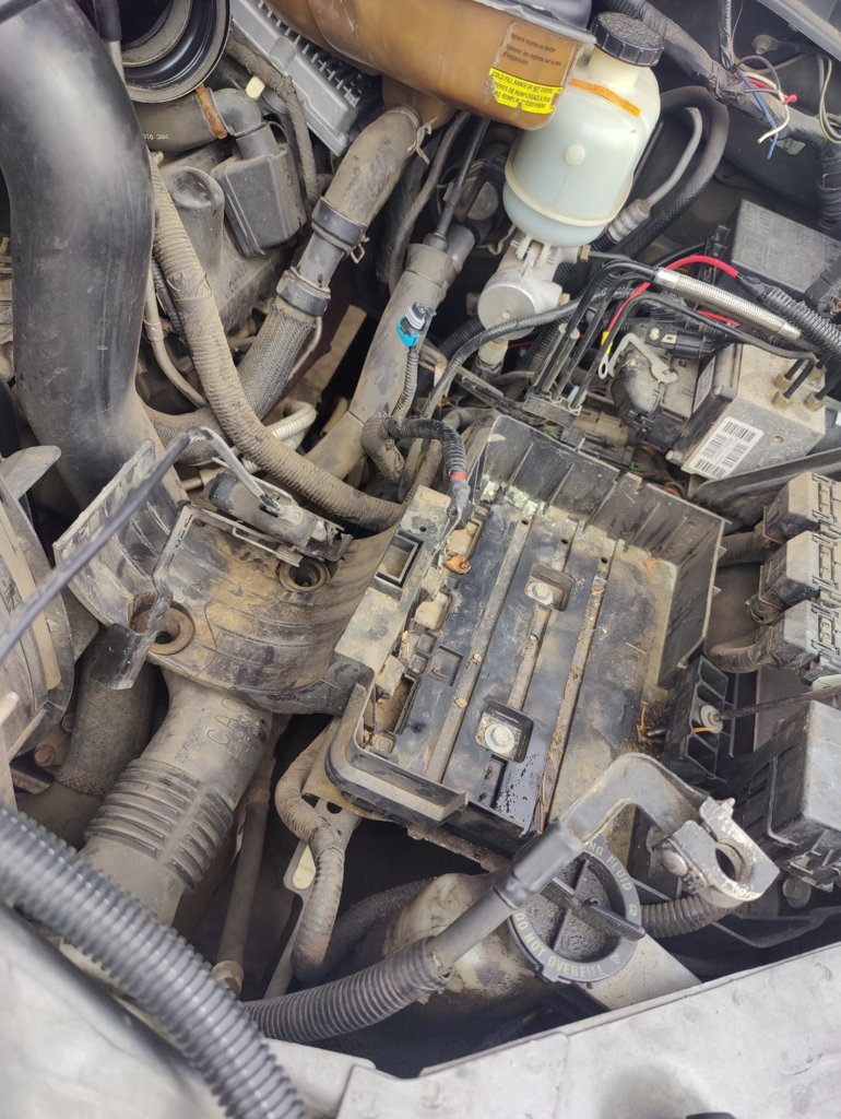

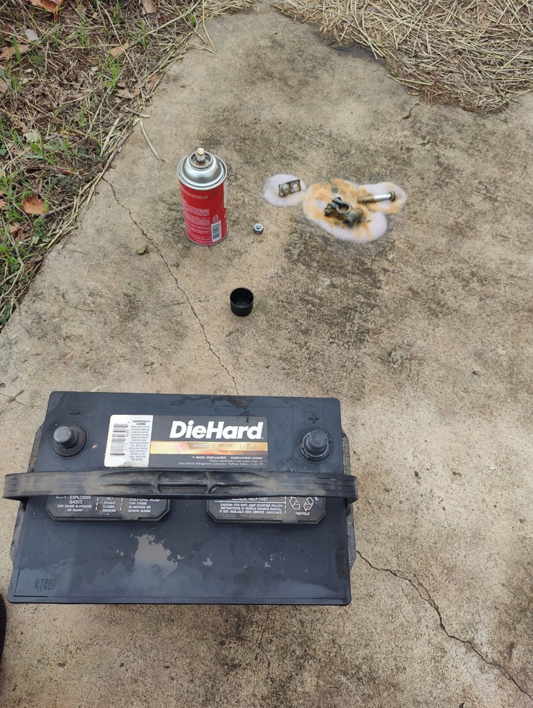

    IMG20241214135103.jpgbattery removed.

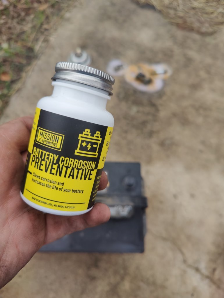

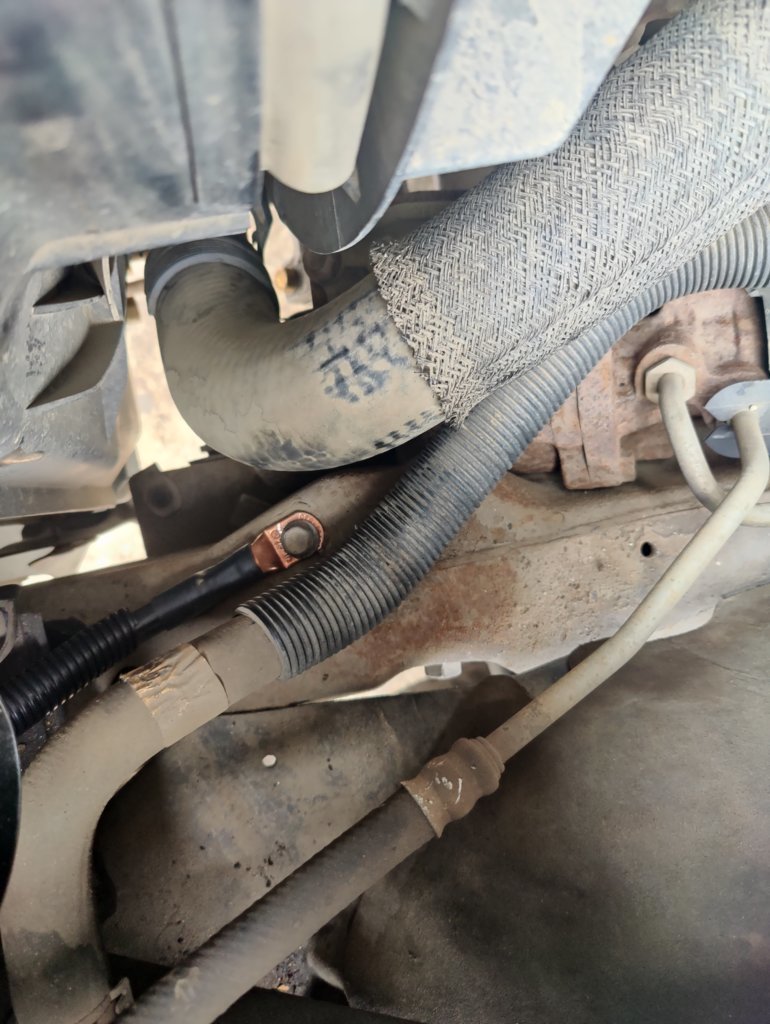

    This battery needs to be replaced so I'll get a new agm soon. In the meantime I cleaned up this one again.
    This is a oil based anti-corrosive paste. We'll see how it holds up.
    Finally I'm able to finish exchanging all the battery cables on the truck. This is the ground but you needed to remove the air box so what better time then now.
    Driver side ground now upgraded.

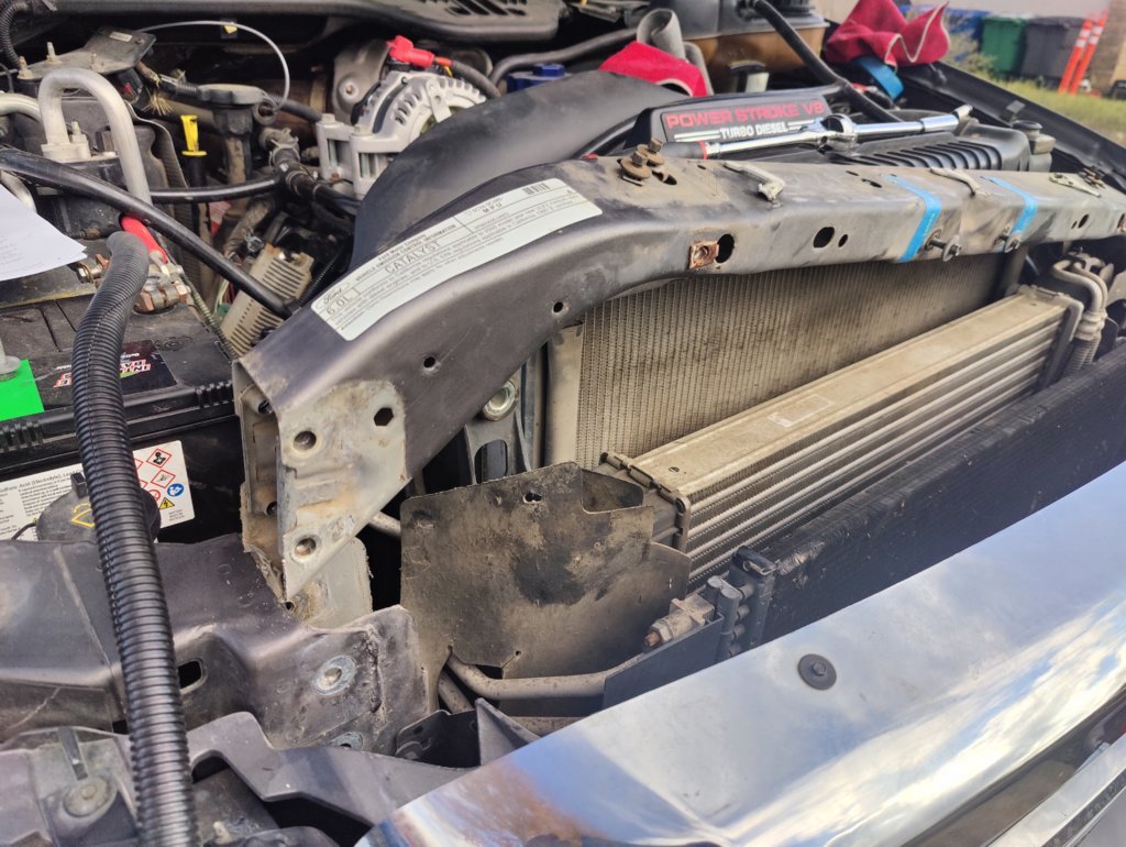

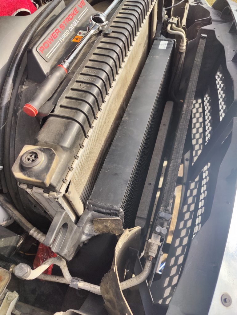

    Radiator support out. Needed quite the persuasion to lift out but it eventually lifted out.
    Stock intercooler out.

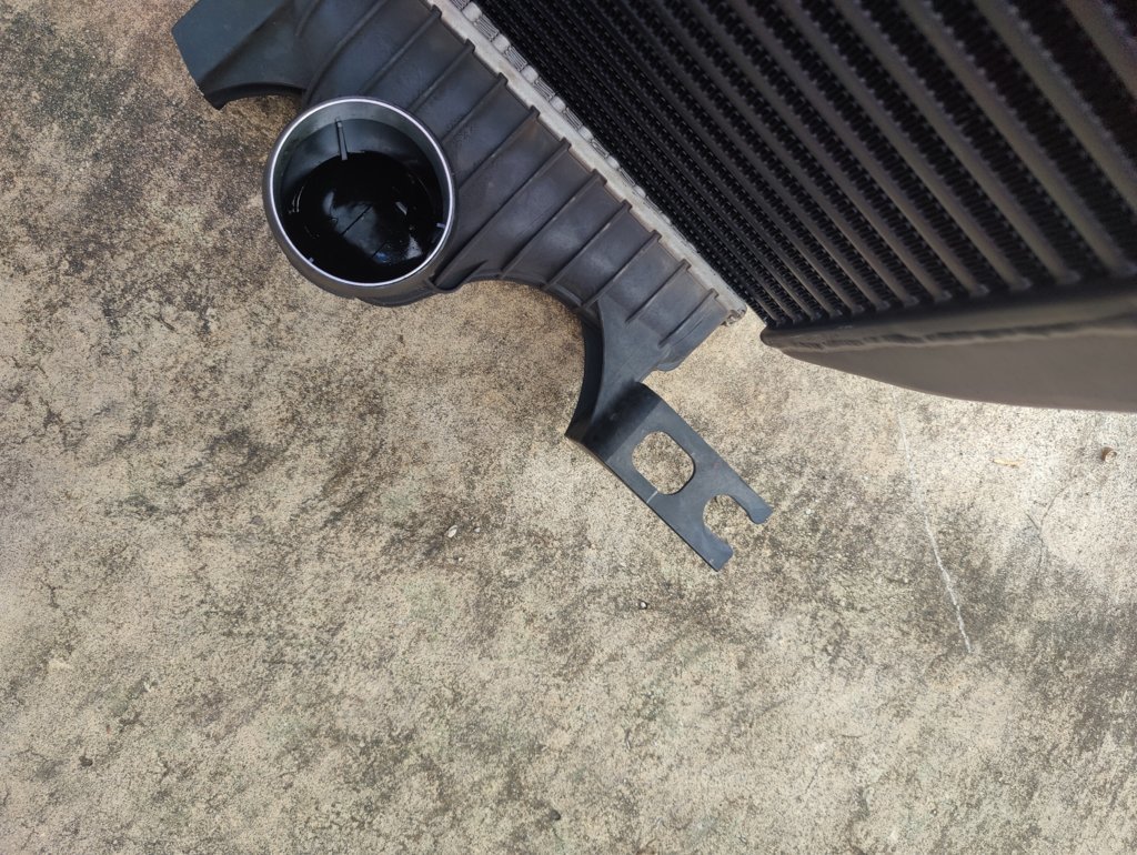

    At this point you're able to remove the stock rubber isolators to install on the banks intercooler.

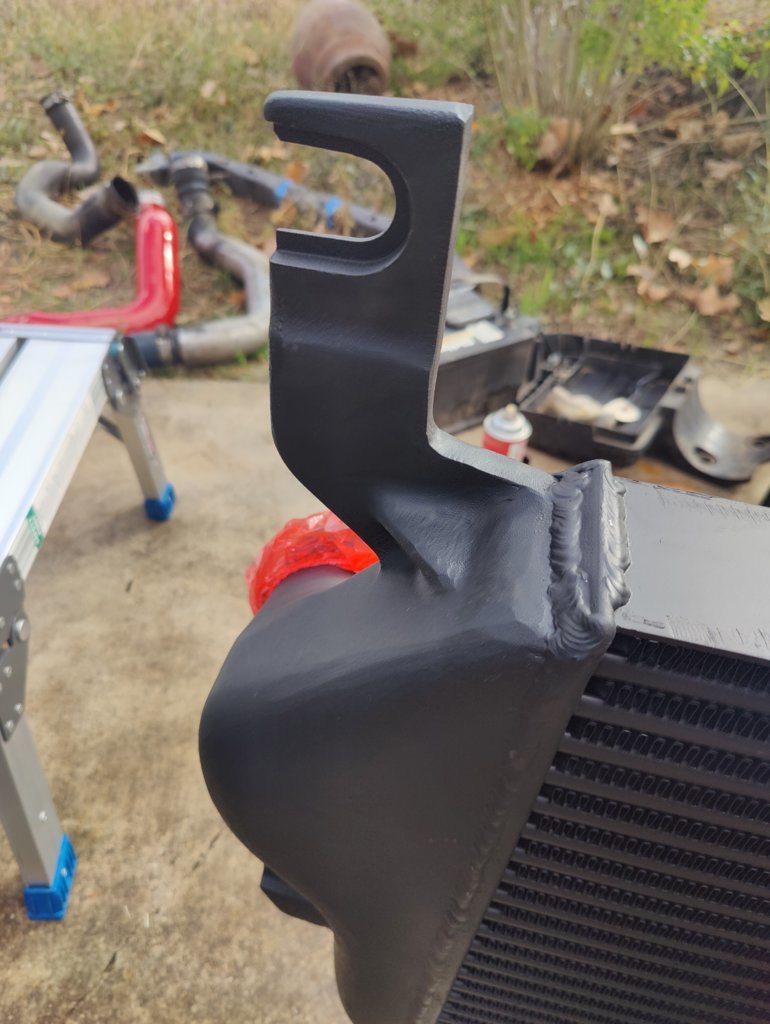

    Upon further examination the banks intercooler does not have a slot that the OEM intercooler has. This takes away a mount to where the coolant filter will sit but will see be held in place by the bolt. I might need to cut the bracket on the coolant filter or think of something else if a singular point of contact becomes an issue.
    Banks intercooler mounted.
    Very tight fit.
    This is the little tang for the coolant filter mount. Might need to be trimmed in the future.

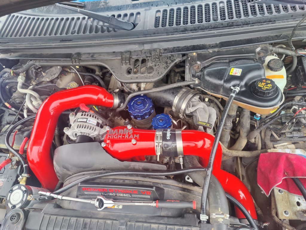

    Everything in the front is buttoned up minus the air deflector.

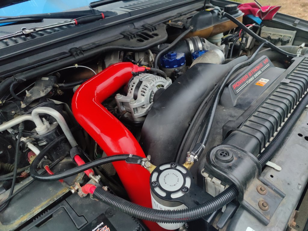

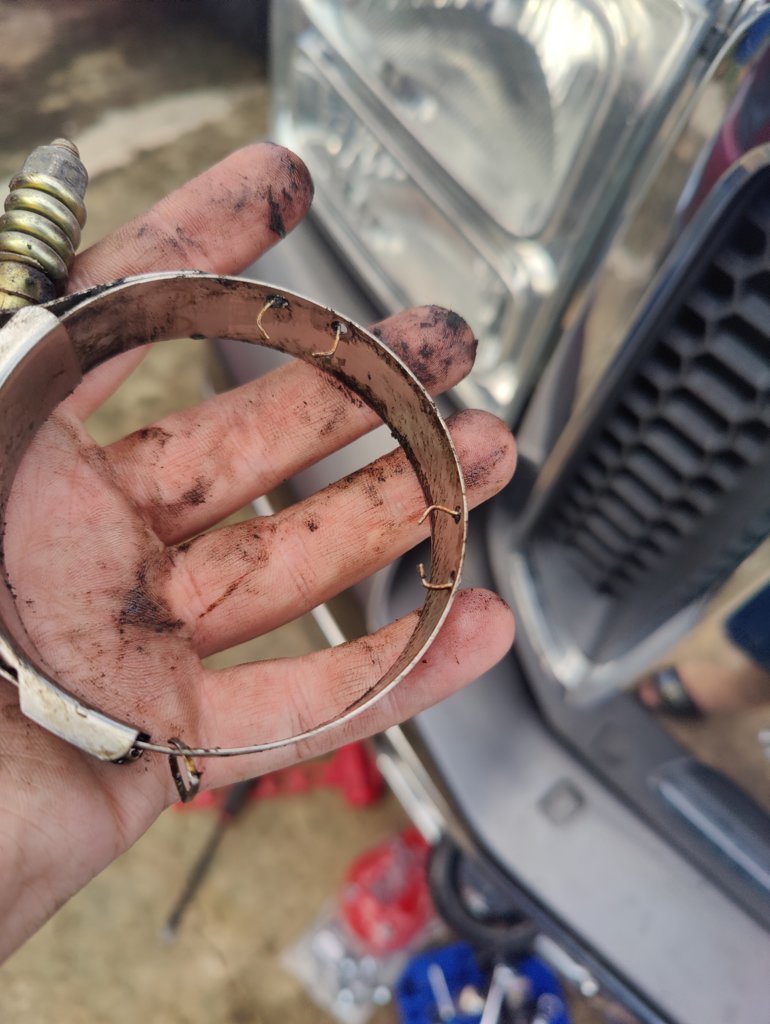

    So banks forgot to include the smaller clamps for the turbo outlet. My stash of clamps were too small or too large. So I cannibalized the old boost tube and used the OEM clamps. As shown they are stapled to the boot so I removed the staples and got them to work.
    Hot side boost tube installed. Very tight fit but these are the largest tubes on the market at 3.5in diameter. As stated earlier I ran out of daylight. Not much is left but I'll need to hit of the store for some Dremel cutoff wheels to trim the fan shroud. Now time to relax and play some video games.

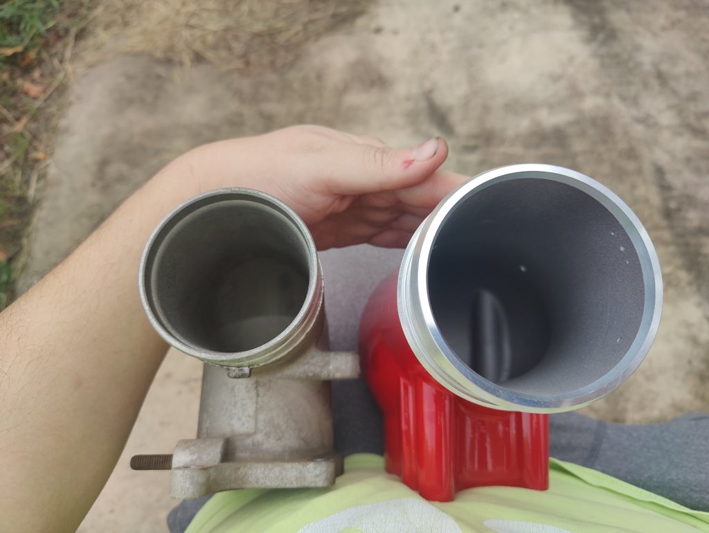

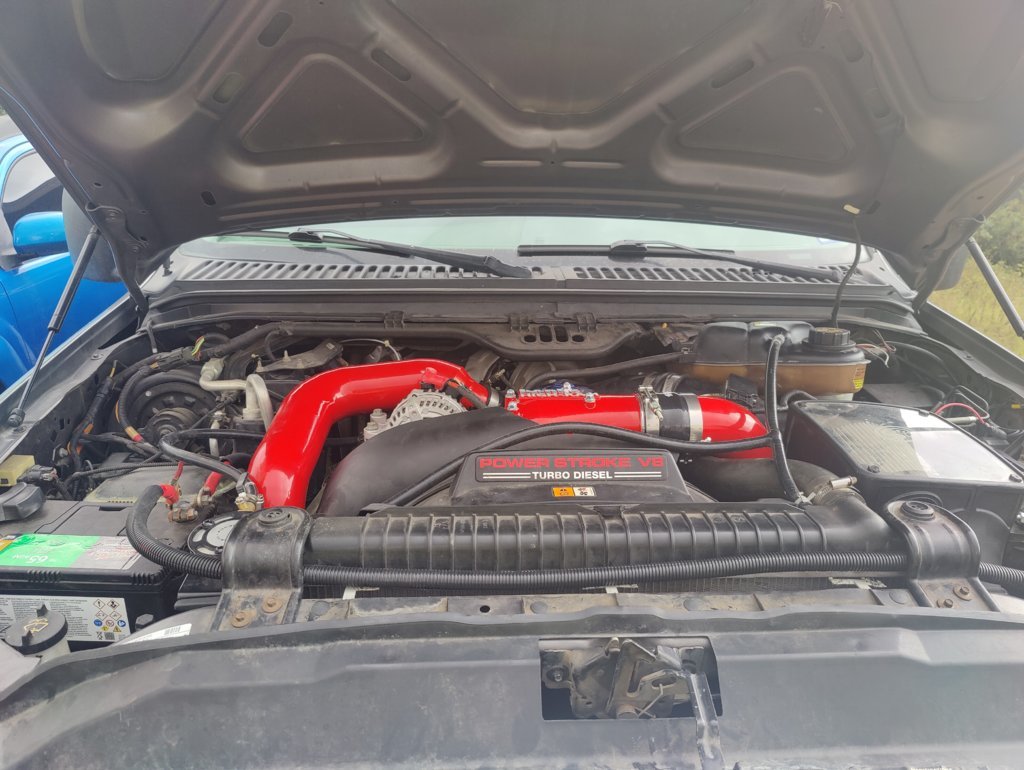

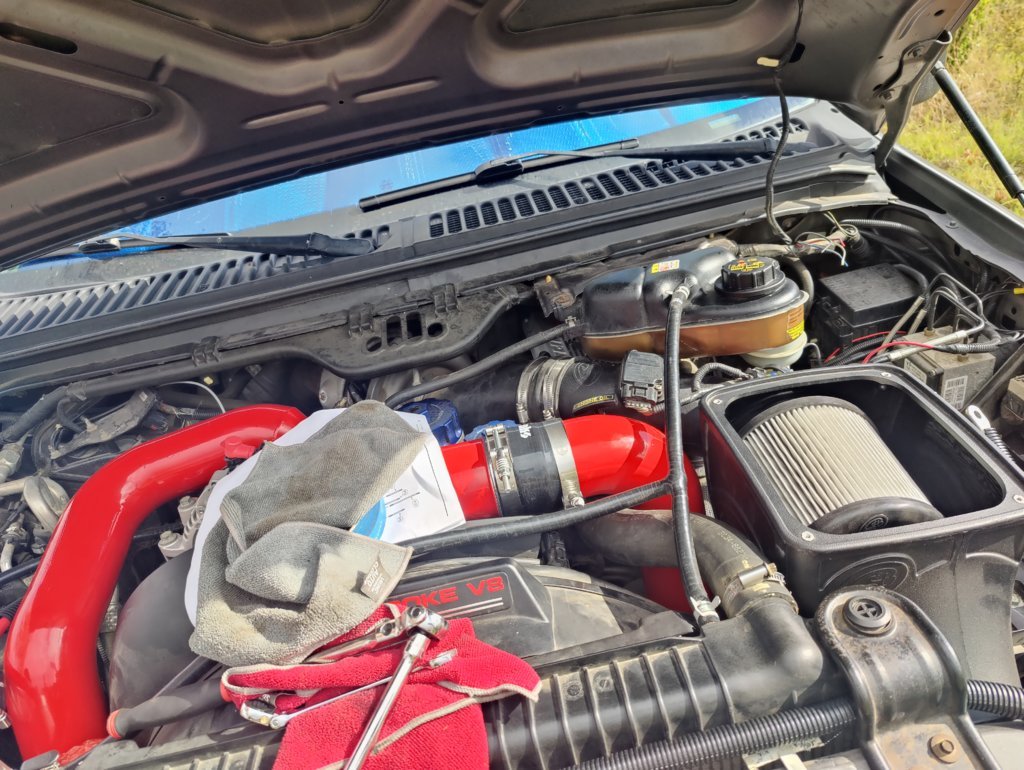

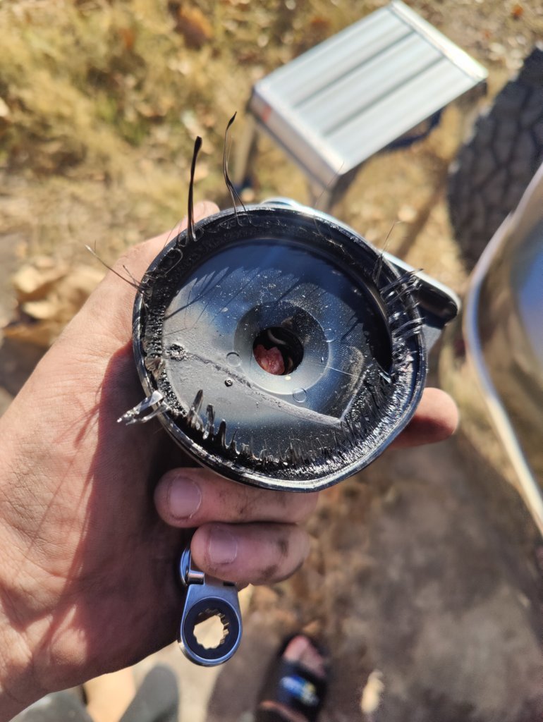

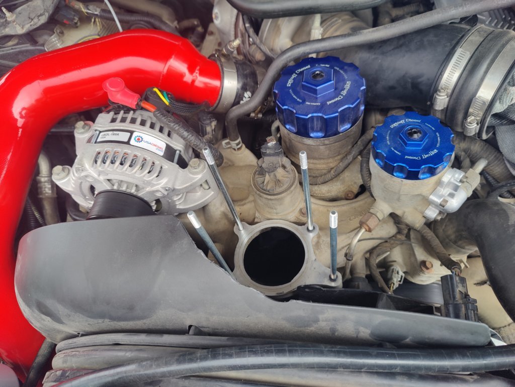

    To finish the install I needed to remove the OEM intake elbow and install the banks one. The fan cover needs to be trimmed.
    As shown the banks has a larger internal diameter. A plus it that it does not have the stud for the fan cover.
    Mocked up.
    So I have seen a lot of people snap the studs when tightening the nut. Two reason are they torque it down too much as they were using ratchets and the rubber seals get caught in the washer/nut. I just used a wrench and went with what I thought was tight enough.
    Cold side boost tube installed. I do believe the clamps are too small for my application. The largest opening they can provide without undoing the clamp barely slides on the boot. Luckily I had some wd40 and muscle to make it work.
    airbox is a tad more difficult to install as it's about 1/2 inch higher but again just gotta find the right angle and it fits fine.
    all buttoned up. I did not reinstall the battery cover as I did not feel like messing with it. The OEM tie down secures it and with the new thicker battery cables it would just be a pain. Last to go on was the air deflector. Truck runs and drives nice. Didn't really get on it as I had the OEM intercooler and pipes in the bed but feels nice. I think it builds boost a tad bit quicker. Mostly though this mod was to keep the intake temps consistent when towing and it will not break like the plastic pieces would.

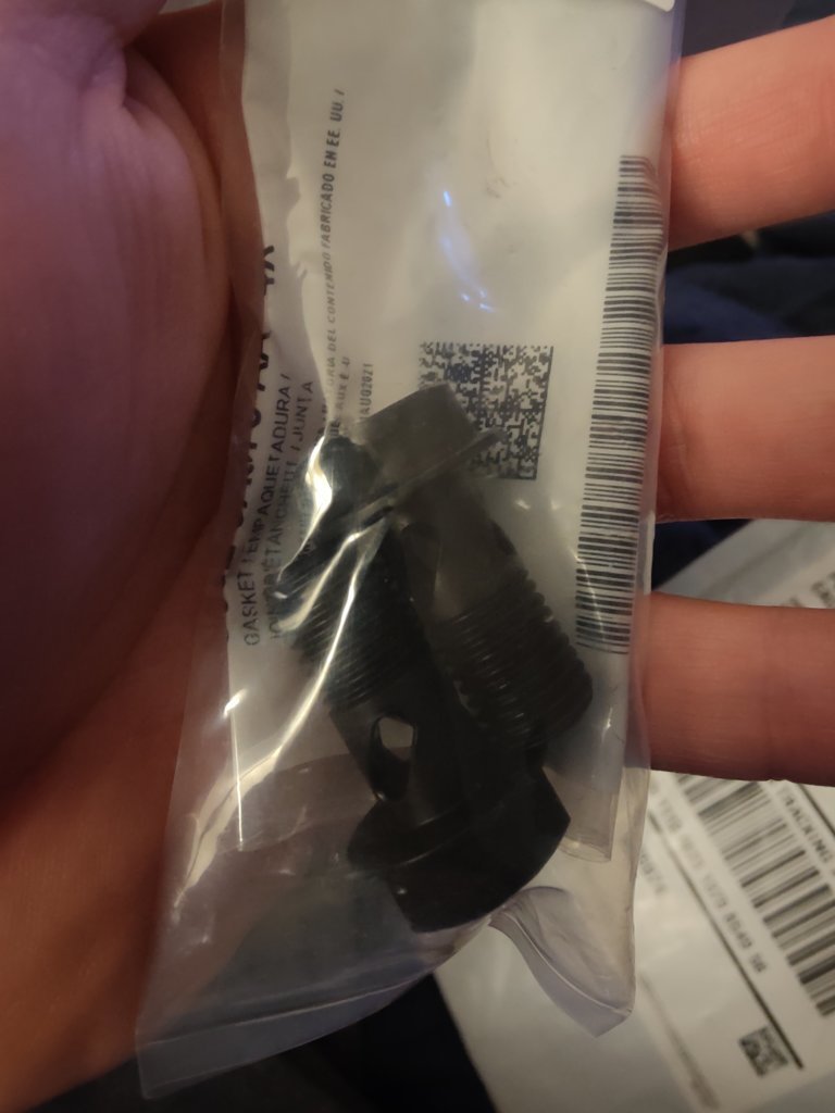

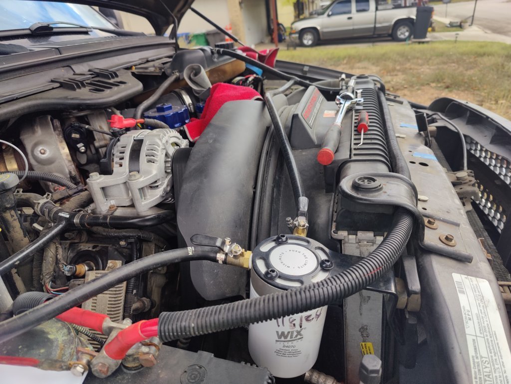

    Got these riffraff high flow banjos bolts that are a nice upgrade from the stock ones. For some reason Ford installed one-way check Valve on the fuel banjo bolts on the 6.0psd. In some situations these have clogged and cause lack of power, mostly due to lack of maintenance. On the 6.4l psd the check valve is removed. To install this it would be best to remove the cooling system to access the driver side easily. Passenger side has no barriers. So at the moment I'm gathering parts.

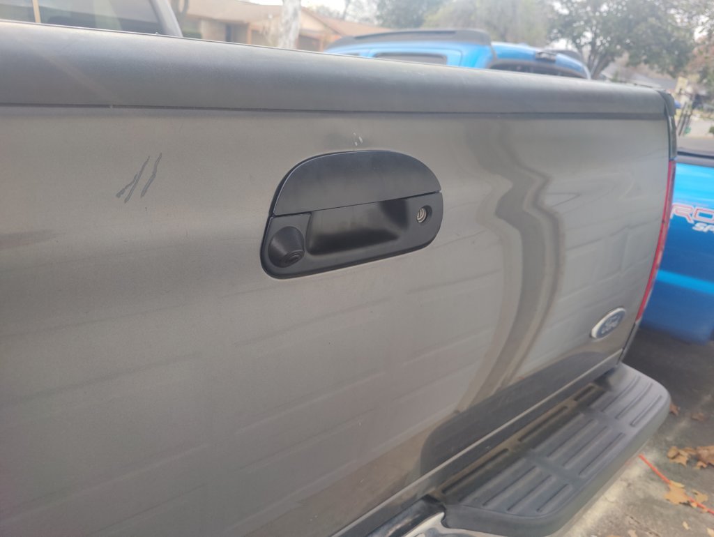

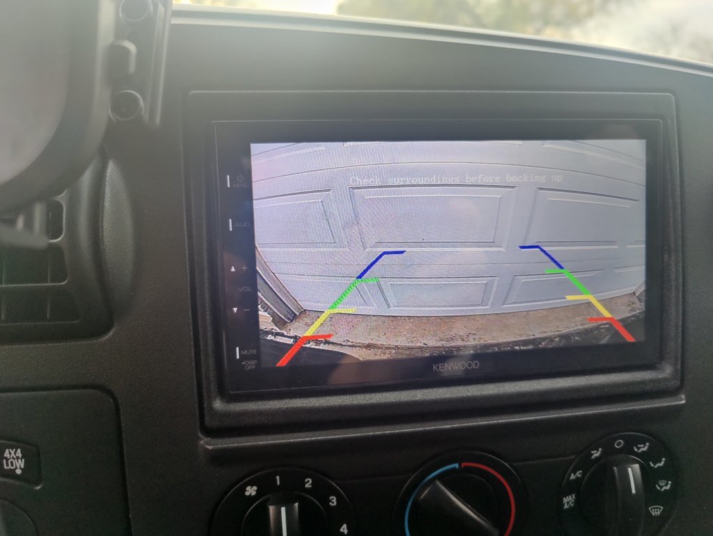

    In a quality of life improvement, I installed a backup camera.
    Very luxurious and safe.

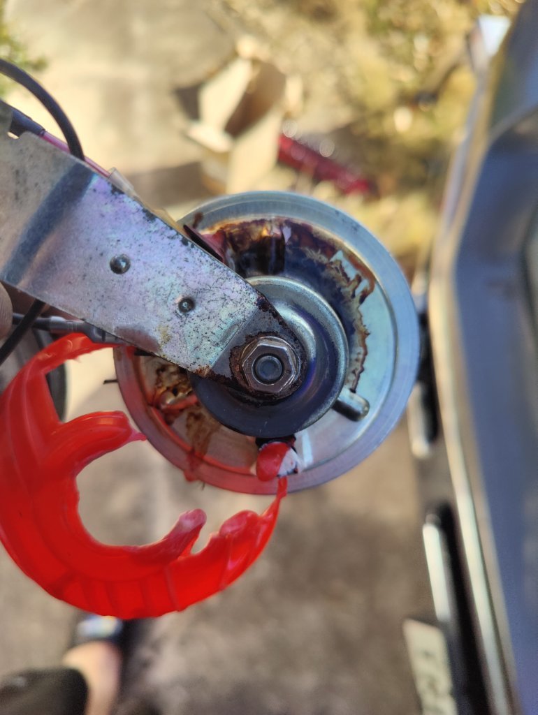

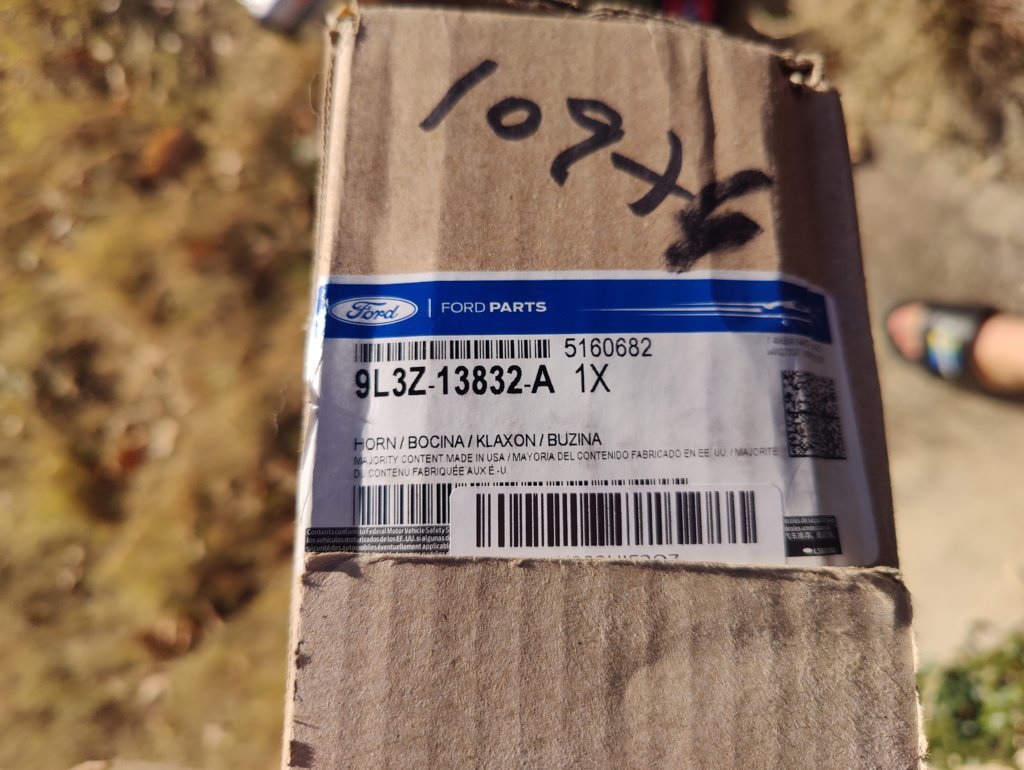

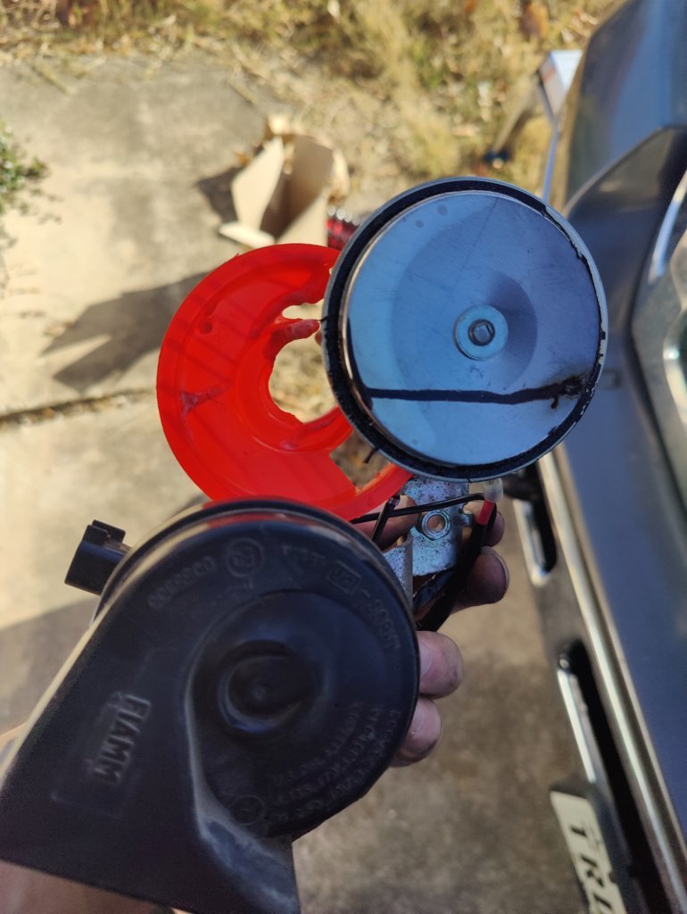

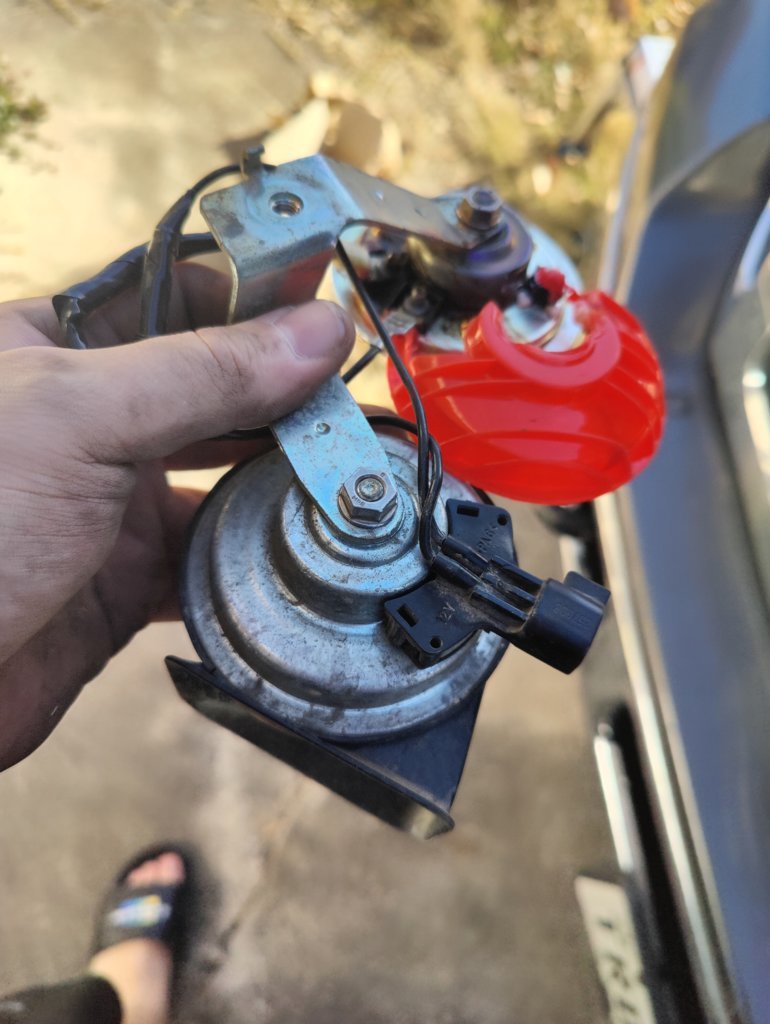

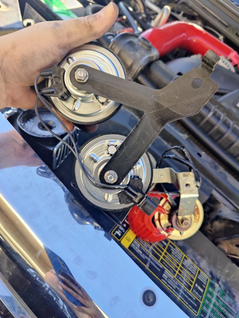

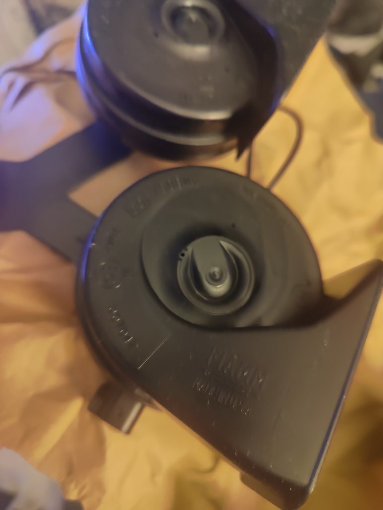

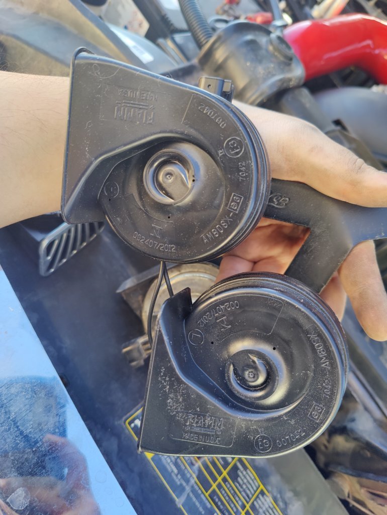

    So the horn stopped working a couple weeks ago but I decided to just buy the OEM horn and needed to wait for warmer weather.
    But first
    Wort wort wort. If you know your awesome.
    New OEM horn for a current gen superduty.
    This fell out so off to a great start.
    Seems things got a tad warm.
    New set
    New horns swapped to old bracket and installed. Horn now works. Hopefully I won't need to revisit it. Lol.
