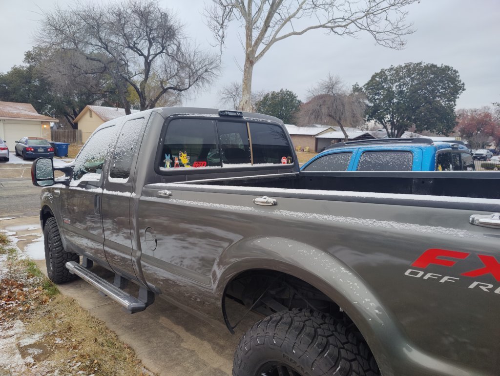

    Woke up to this, refused to accept it, and went back inside. Lol.

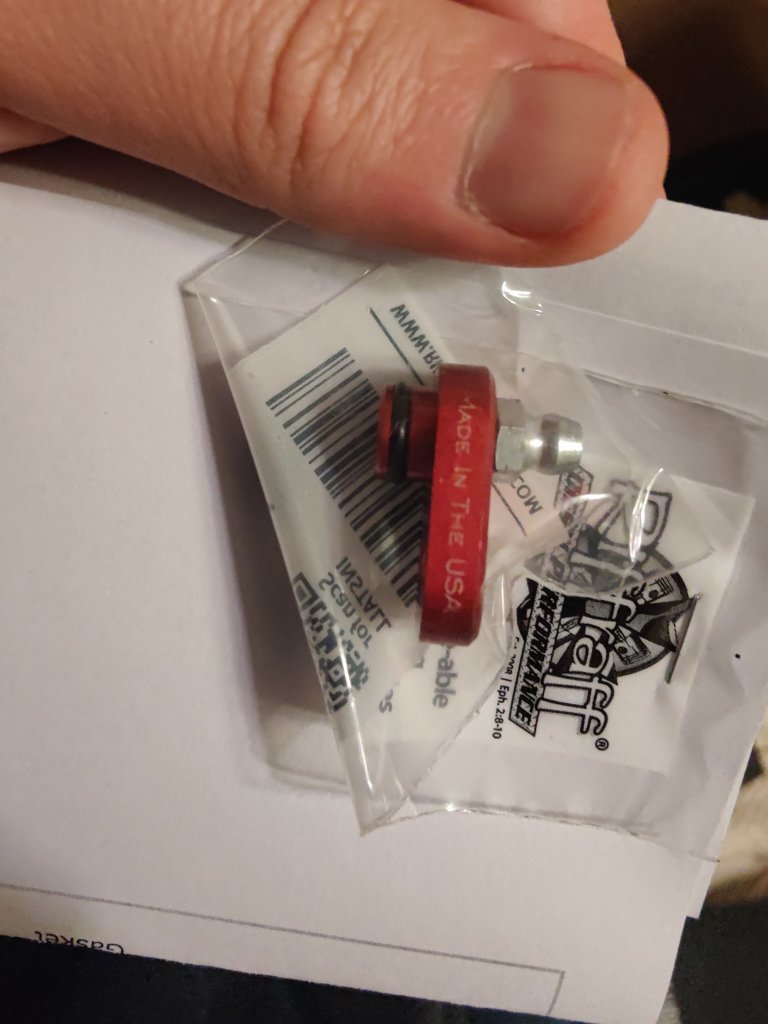

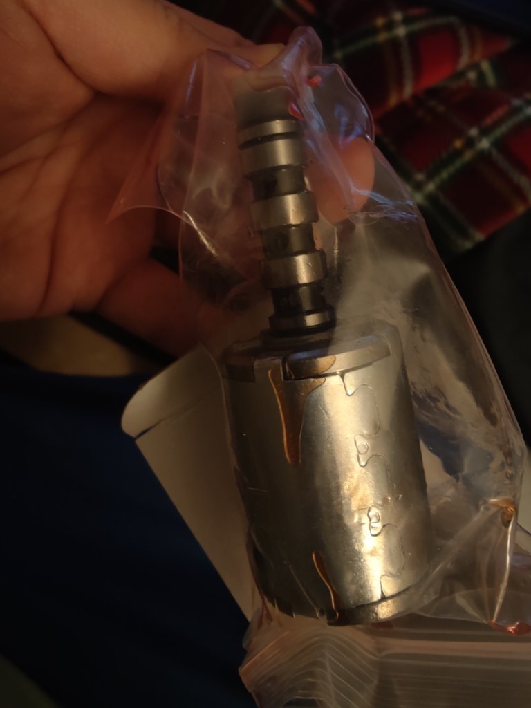

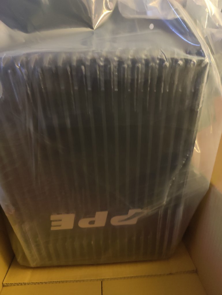

    Got some more parts.
    Transmission pan gasket.
    A tool to grease the front wheel bearings. If I had an older truck I could leave this installed but as I have front and sensors I'll have to grease and remove.
    Nice thermostat housing. OEM one get corroded.
    OEM tstat to swap into the nice new housing. Just gotta now get the hoses, new dgas bottle, water pump, and radiator to work on the cooling system. I have also decided to invest in a Carli suspension system. I'll run the 2.5 springs with the Carli arms. I plan on running the back country shocks that Carli makes as they're budget friendly and seem to offer the best ride. Rear will run the Carli shackle. Spring wise I think I'll stay with the OEM springs for now as I need to retain the payload capacity. You can swap over leaf springs from a 08 and newer superduty but you need to move the front mount.

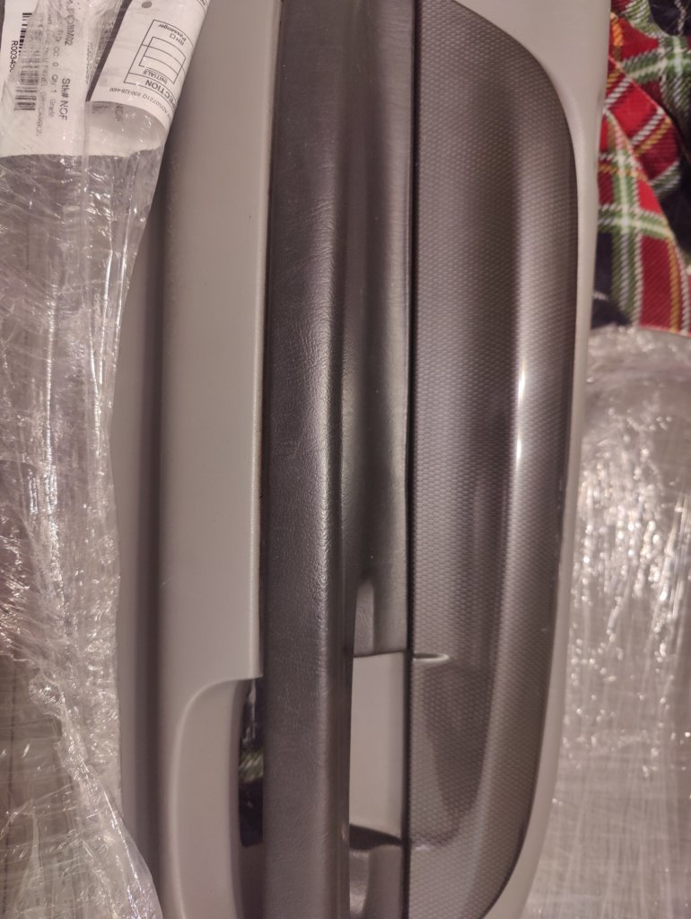

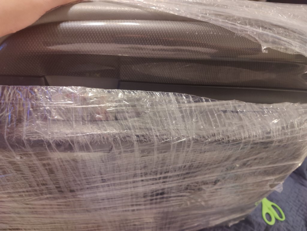

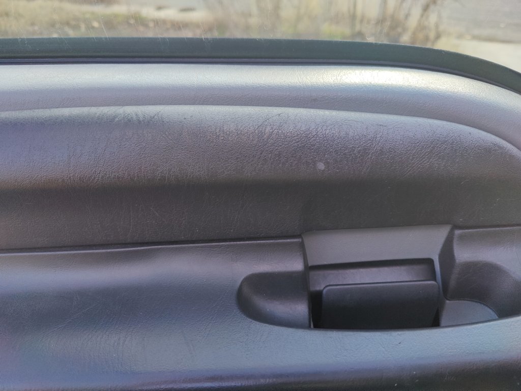

    Carbon fiber door panels came in, very happy to find a clean set and they came from California. These are a very uncommon but look much better than the wood grain stuff found on lariats. I believe the carbon were only in the sport edition trucks.

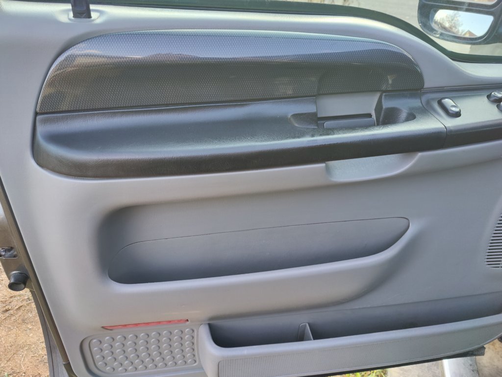

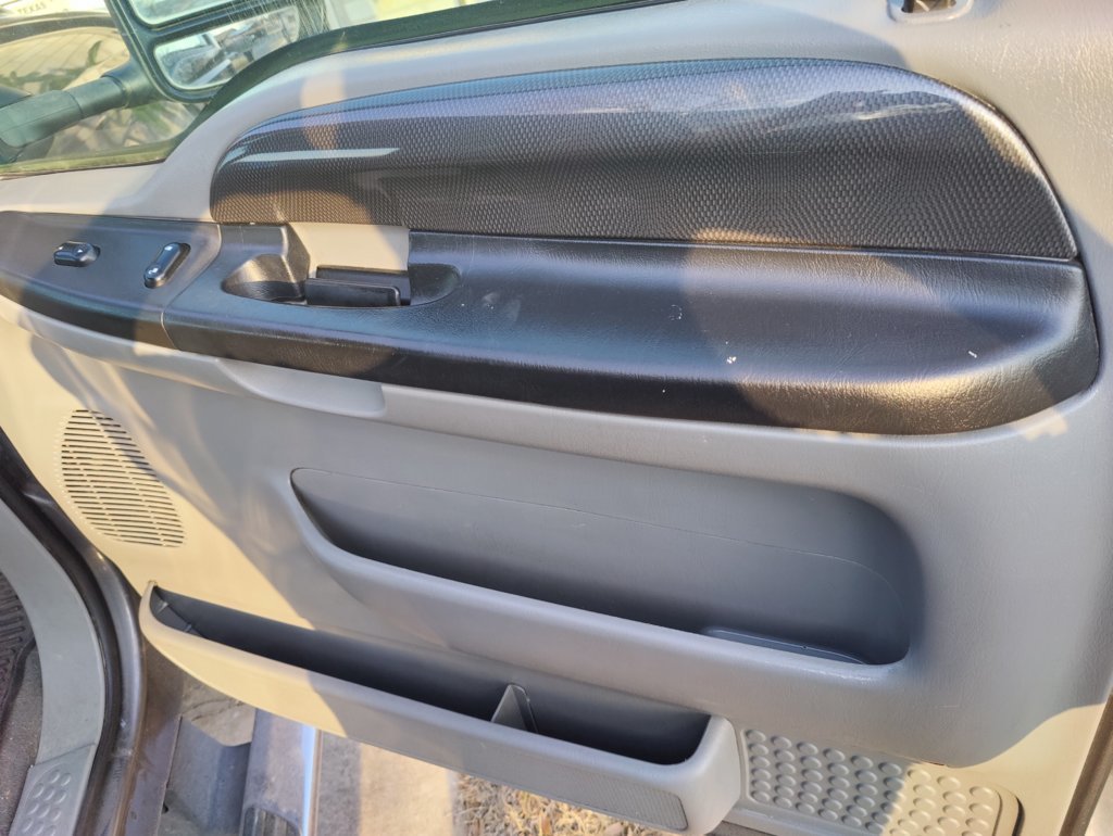

    Went from the old XLT door panels...
    To sport package niceness for that OEM plus vibe.

    will it scratch easy? I dont believe so. the clear coat is pretty think from what i can tell. i think with my usage itll be just fine, very similar with the lariat with the simulated wood. just gotta get it tinted with the ceramic tint to protect from the uv light.

    I Like them!!!! They are pretty Sharp!!!

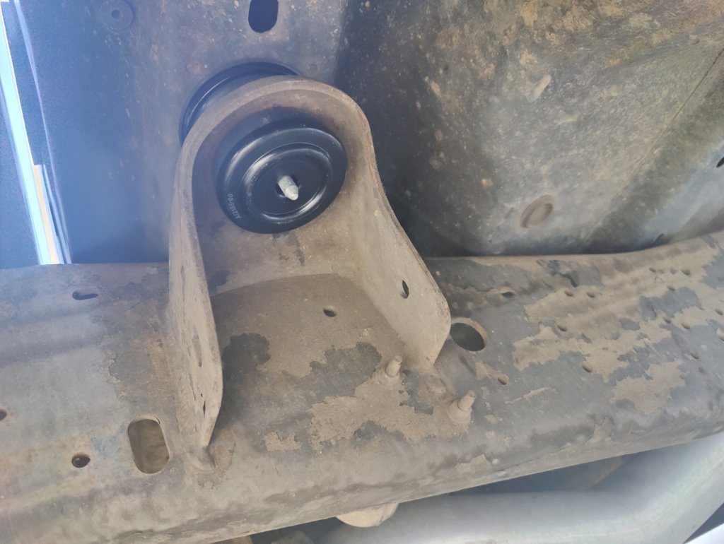

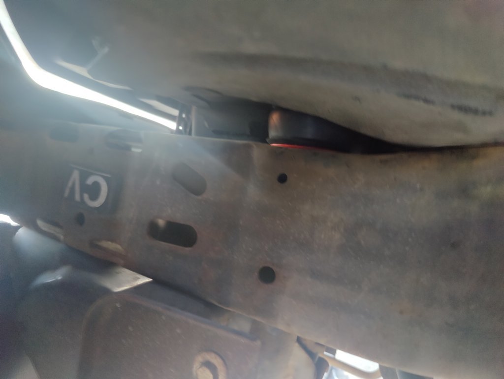

    S&b cab mounts installed and I cannot stress how much better the ride is. I really like to say it's better than new current gen hd rams and superduty's I've driven.

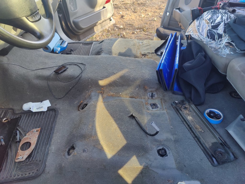

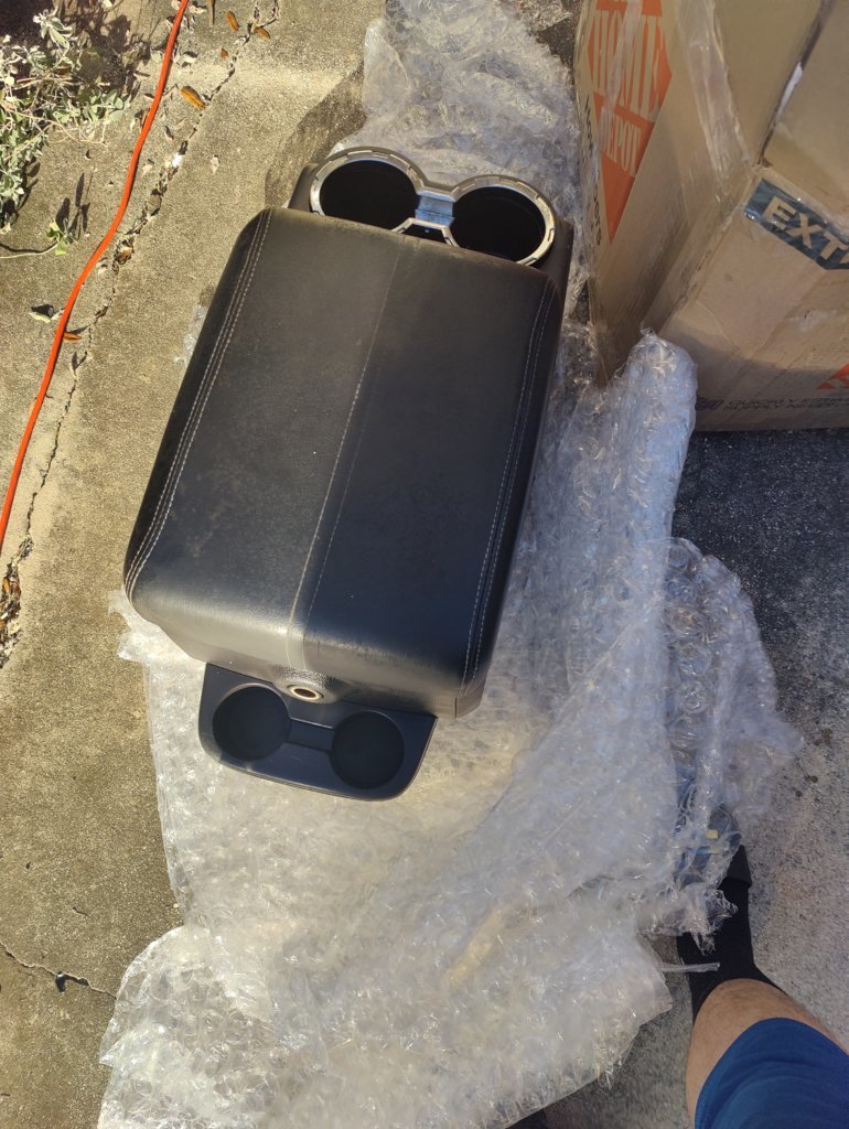

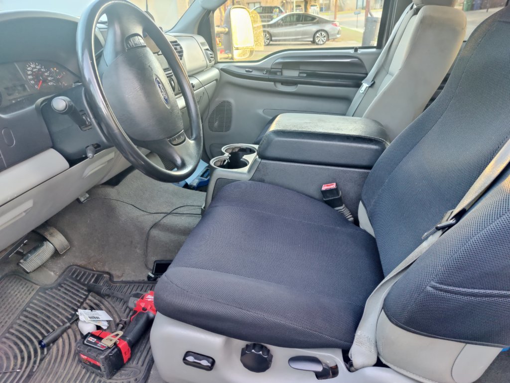

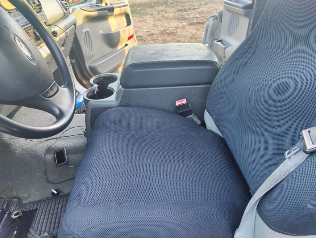

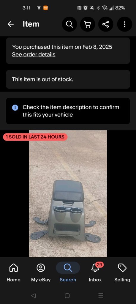

    So the new center console came in so I elected to install it before it got cold.
    It was complete so ready to install. Hardest part was finding the correct orientation of the brackets but they can only go on one way.
    Seats out, they're heavy but not as heavy as the newer seats.
    Loosely installed it so I can get everything in it's hole. And aligned correctly. Safety first after all.
    Installation is complete and the arm is at a much happier height. Plus I can now have better cuo holders and a do other things. It's big fancy.
    Torspd likes this.

    What Console is that? Aftermarket? Or just a Different Year?
  13. Feb 12, 2025 at 4:45 PM
    #133
    Lucario Runner
    Lucario Runner [OP] Resident Truck/SUV racer
    Jun 29, 2011
    #59067
    7,187
    Robert
    San Antonio, TX or nearest race track
    06 Toyota 4Runner
    AFE stage II intake, APR X1, URD 70mm Throttle Valve (ported and knife edged), NST intake manifold spacer, URD spec U headers, Denso IKH20, URD fuel pump, APR fuel rail, URD Y pipe, URD spec u catback, lightweight water pump pulley, Greddy sandwich cooler plate, Earls oil cooler, IPT valve body, FJ TRD shocks, Cusco front and rear sway bars, Energy Suspension rear track rod bushings and rear link bushings, Carbotech pads, Stoptech ss brake lines, Stoptech slotted rotors, Motul 600 rbf, Limited Grill, Painted hatch cover by me, Painted valve covers by me, Cobra CB, TRD rad and oil cap, Escort 8500, Autometer oil psi and temp gauges, AEM wideband afr gauge, Flexpod, Pioneer 400w speakers.
    It's OEM, from the 2008-2010 superdutys.

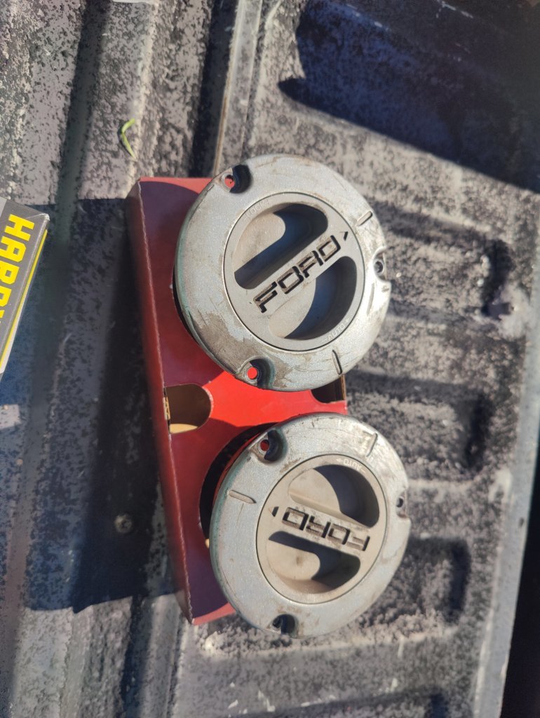

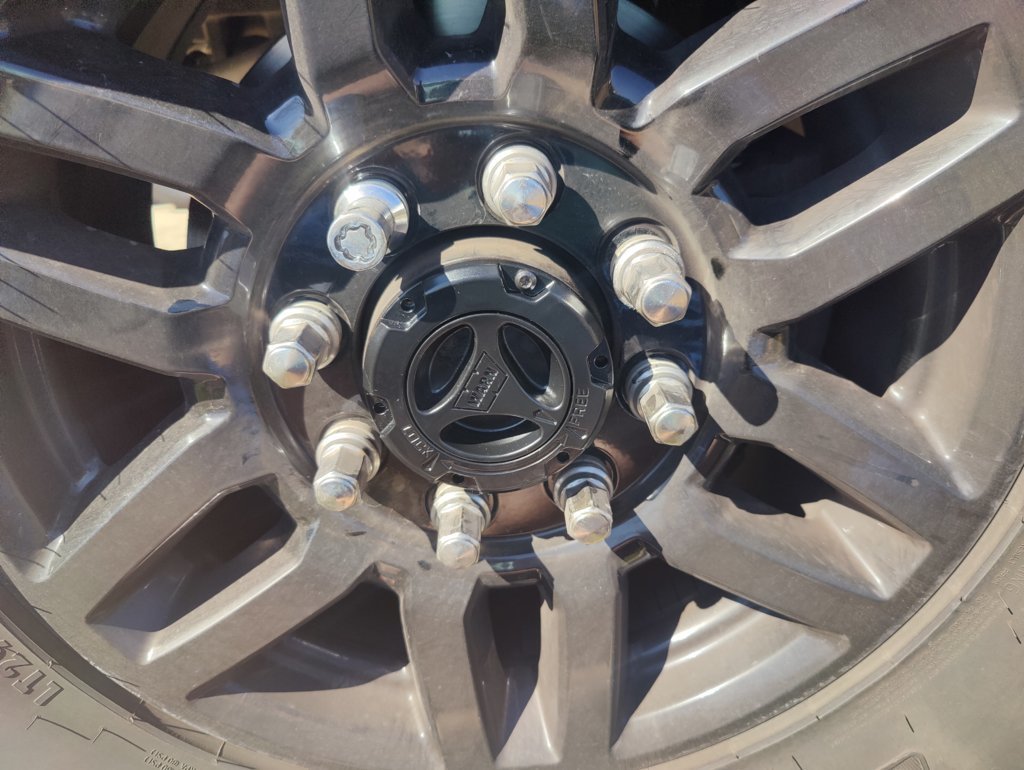

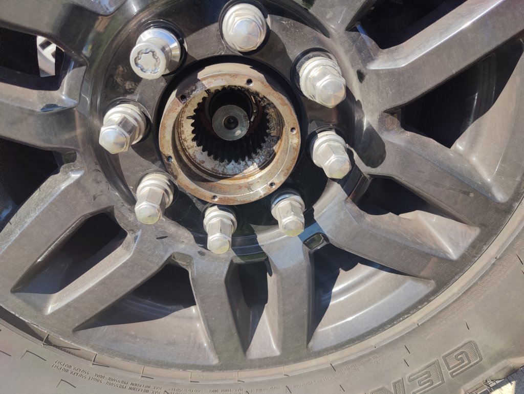

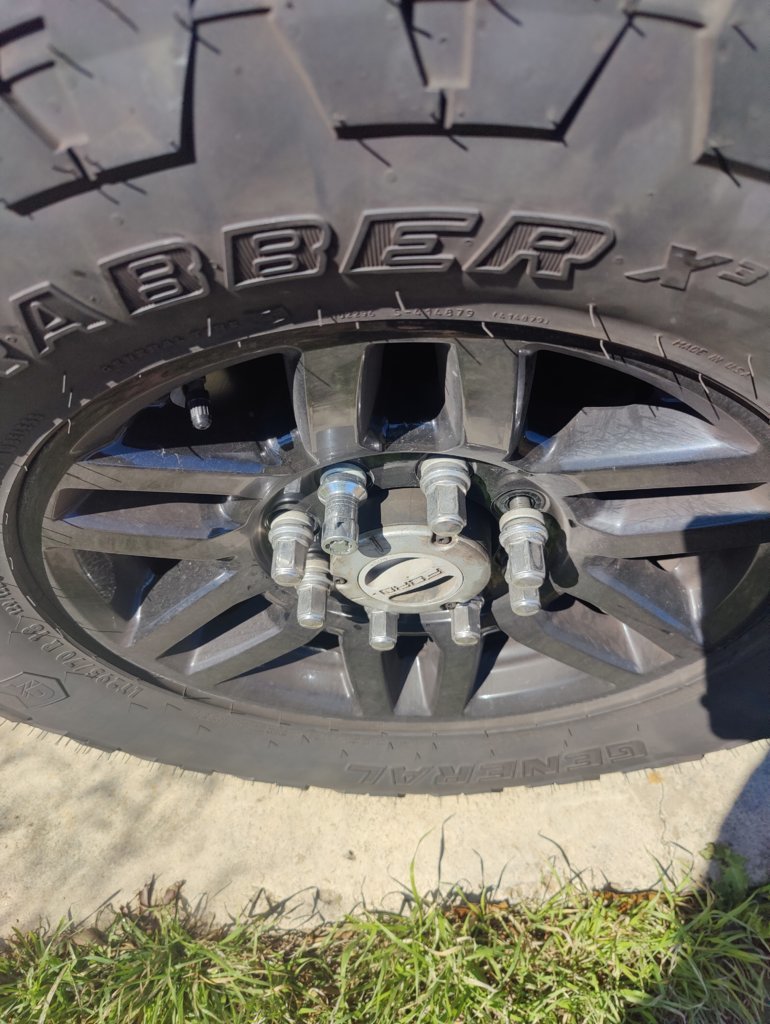

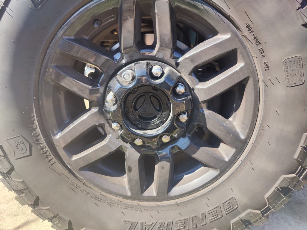

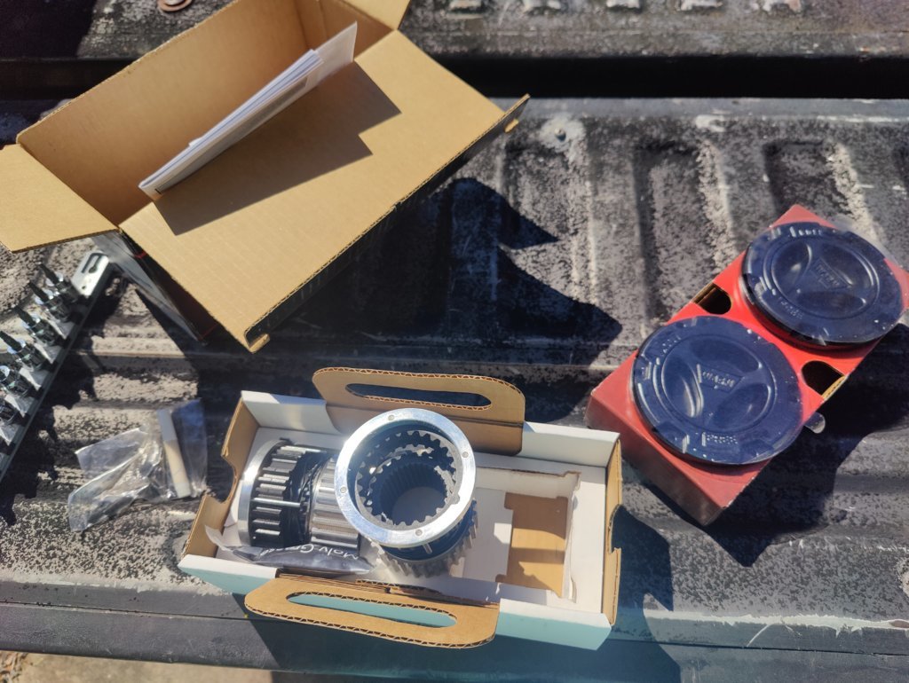

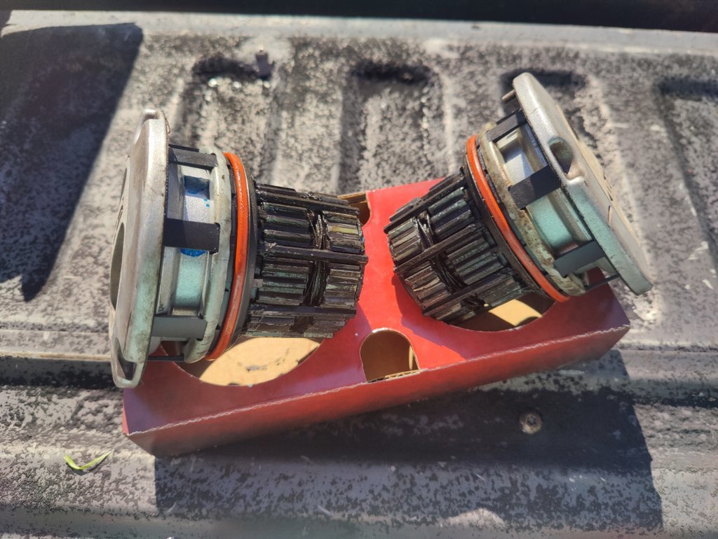

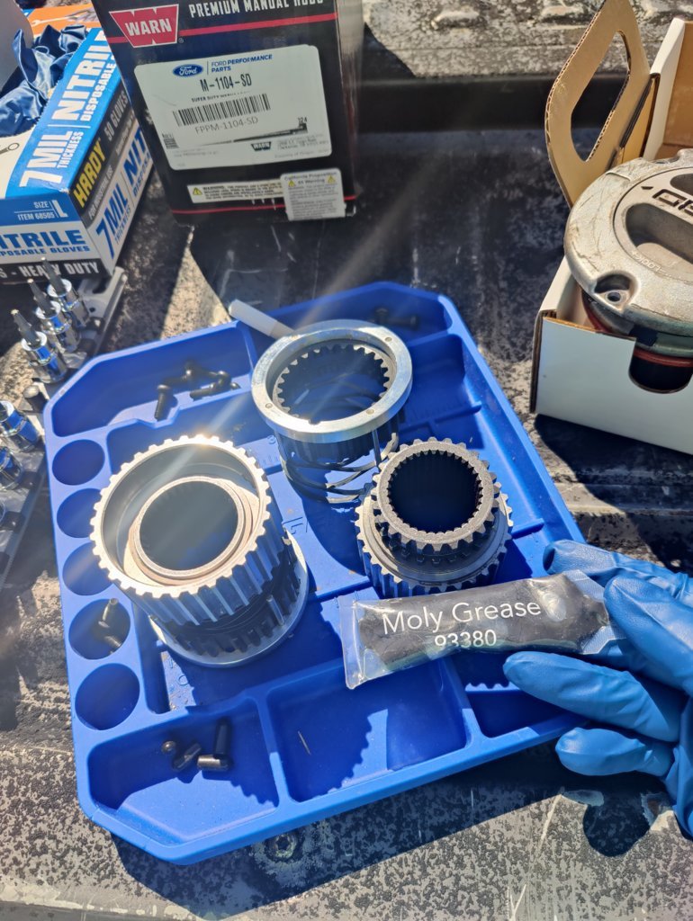

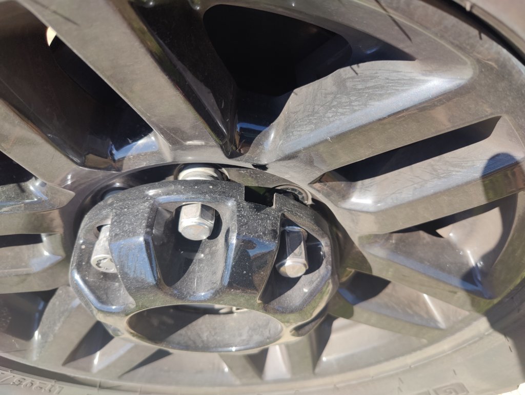

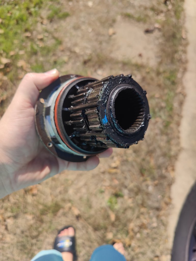

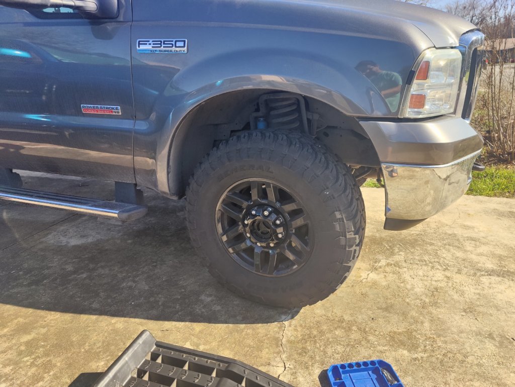

    Weather is finally not cold so got to do some wrenching on the daily. Decided to install the Ford warn hubs.
    Nice complete kit. Came with good grease and anti seize.
    Learned this trick where you release one lug nut by this slot and the cap releases it's tension. Very nice as you don't need to undo all 8 and retorque them or breaking a $100 cap.

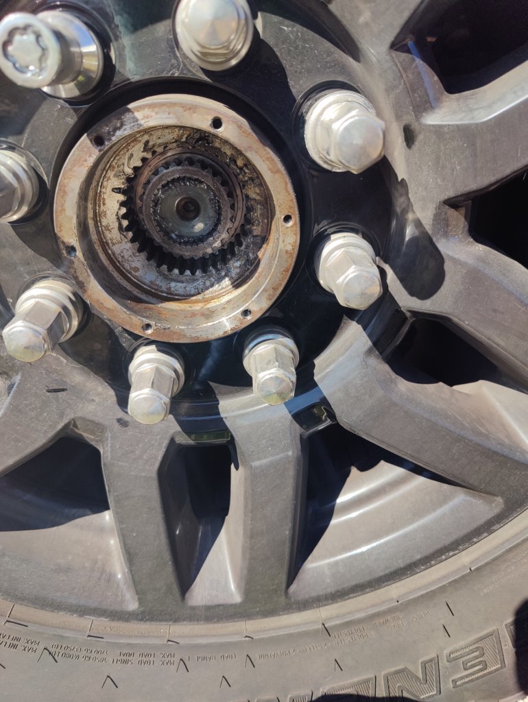

    Little t25 action and the OEM hub is out.
    Quick inspection and ready for install
    Greasing new hubs
    Ready for wave spring
    Its a bit tricky to get to point but just needed a moment to think of a solution as it's a very tight fit. Had the clutch ring and cage with one hand once engaged used the other the hub with e bolt through it and the gasket to suck down the clutch ring in the free position.
    Driver side down.
    Passenger side completed. Ran both sides and both engaged and release very nicely. Nice upgrade and look good as well.
    The stock ones, while are convenient with the auto engagement by vacuum, fail as the hub is plastic and I believe the cage is also plastic. With the warn as it's all metal that is no longer a problem.

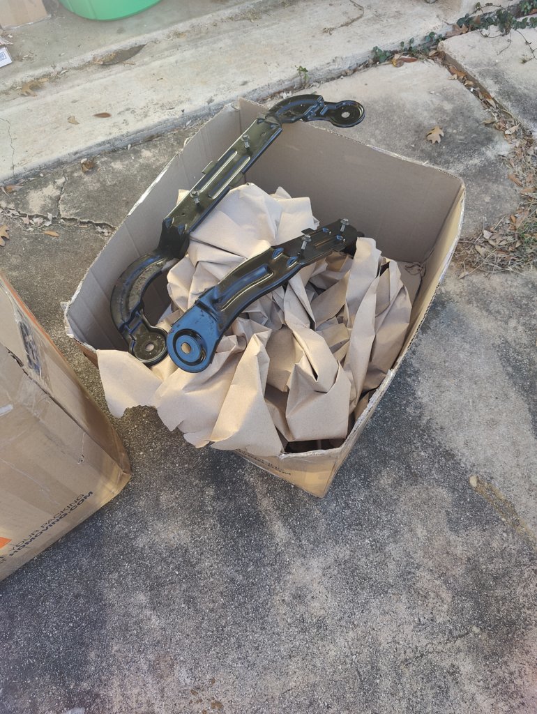

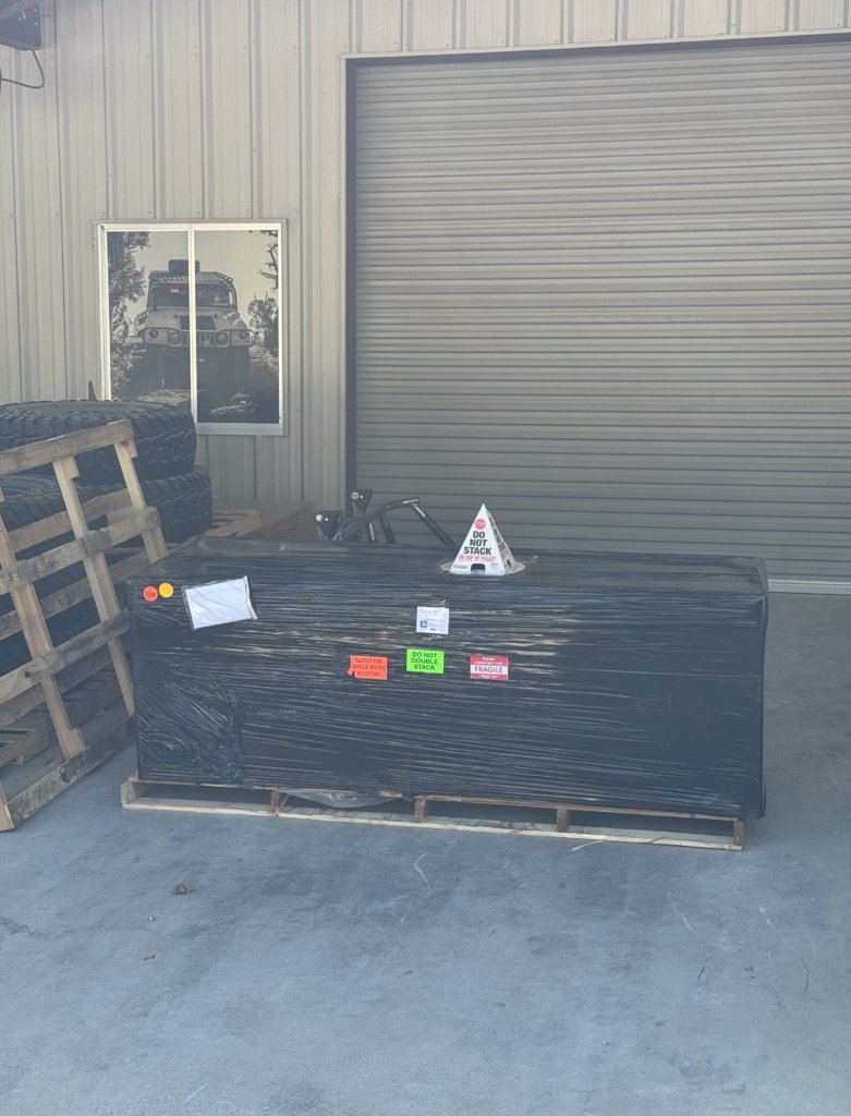

    Arb bumper arrived

    Polydyn is located right by Mark and their coating has held up well for my turbo manifold the past few years. Definitely worth considering

    Love the ‘do not stack’ pyramid

    Fragile does it for me.
