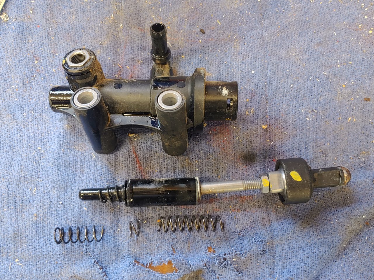

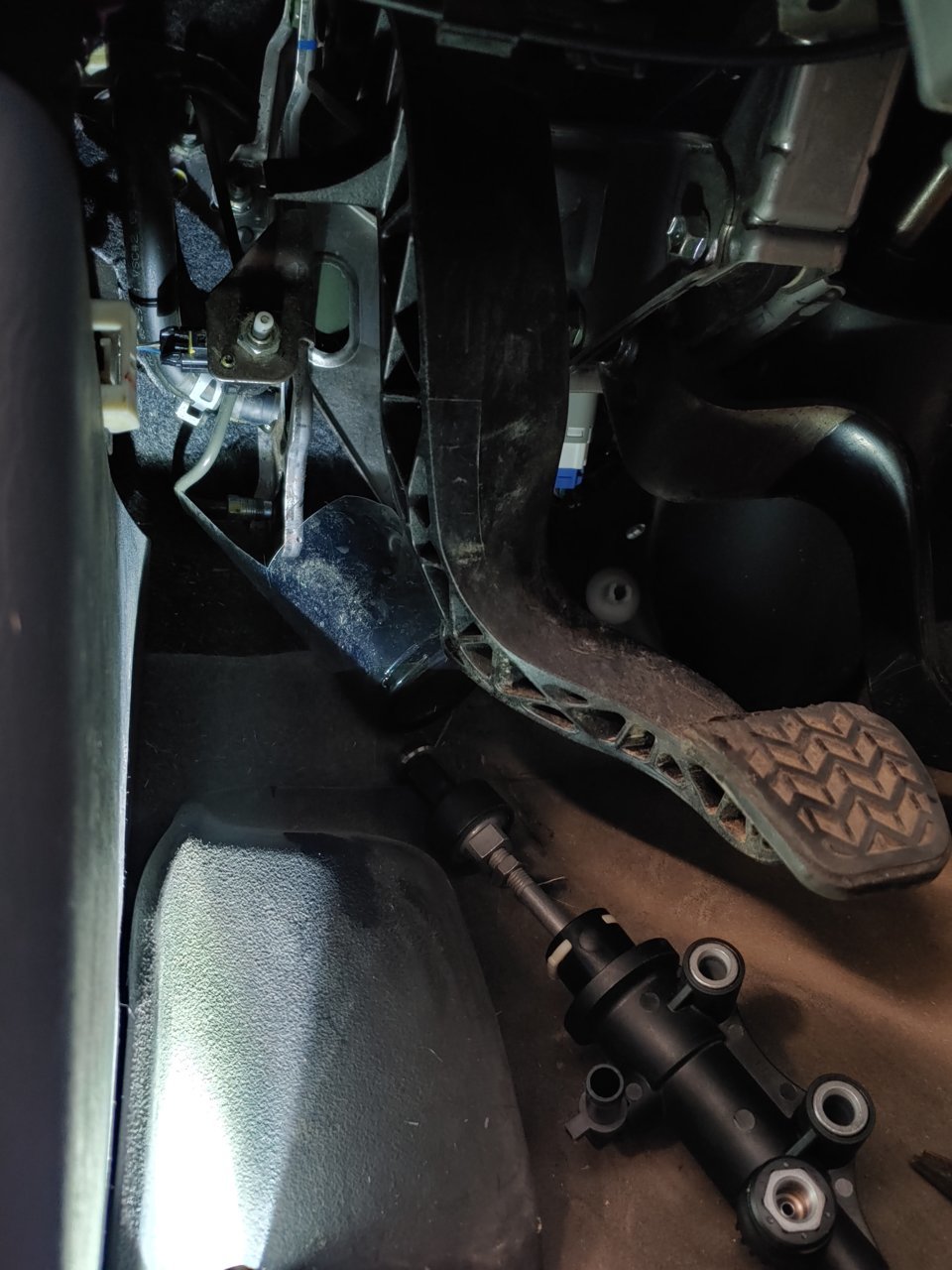

    No major updates, just some small stuff. Tacoma clutch pedal gained some extra free play a couple weeks ago. Looks like the master cylinder spring decided to become four.
    Installed a new master earlier today. Probably going to get a rebuild kit for the old one and throw it in the spares pile. Who the hell thought putting the master cylinder in the cab was a good idea?!

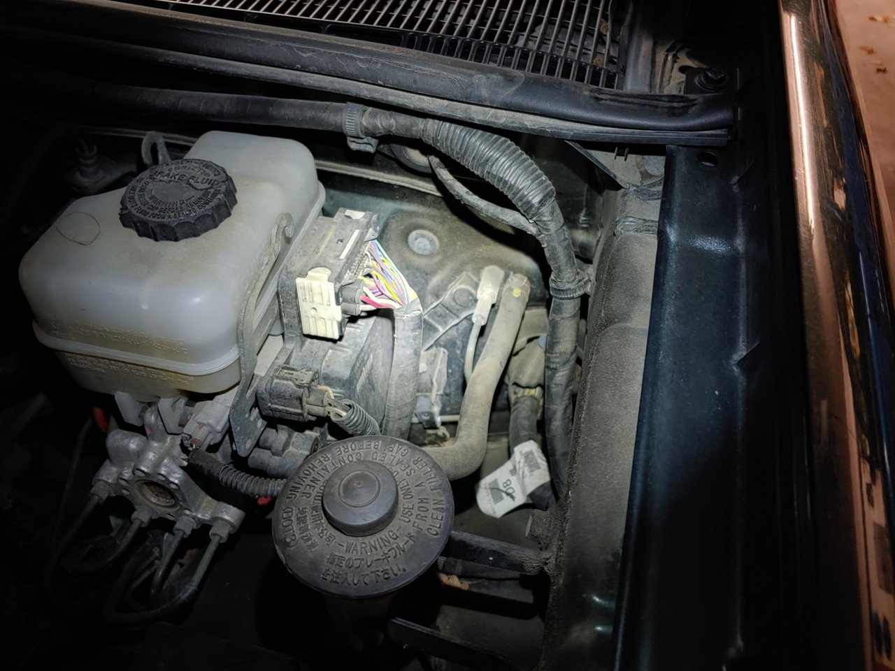

    Tacoma. Clutch lines are to the right of the brake master

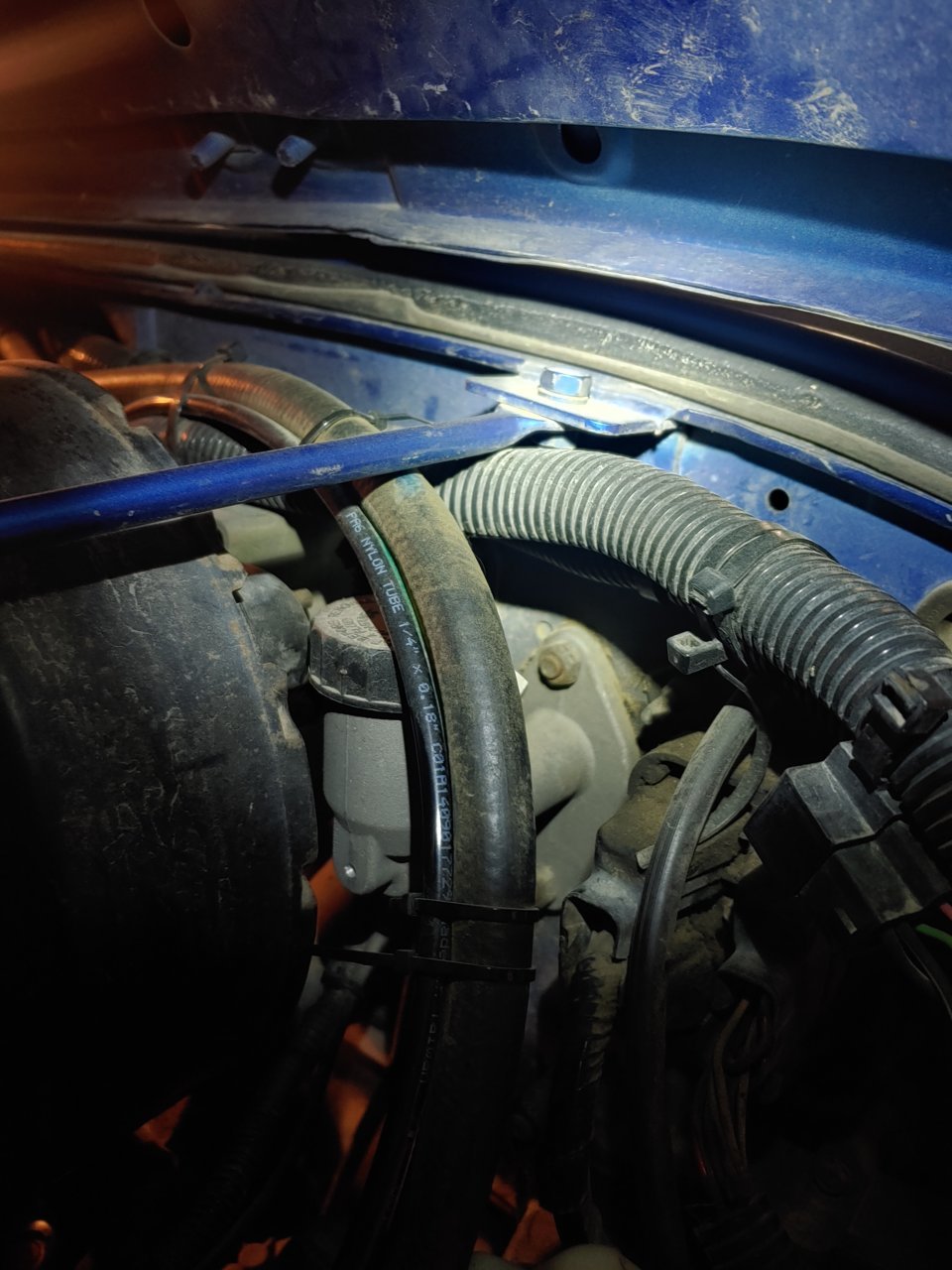

    YJ. Clutch master is in the engine bay, wedged behind the brake master and next to the ECU. (disregard aftermarket houses running above it)
    Tacoma has arguably more room.
    My best guess is ease of manufacture. This way the entire clutch pedal assembly can be bolted in as one unit in the factory, vs having to connect a clutch linkage through the firewall. As an engineer, it makes sense. As a tinkerer, I still think it's dumb.

    Dumb until you need that space for something else. Then you'll be bitching about why the clutch master is in the way..... :rofl: (this is a daily occurrence in the shop)

    Nah, I still think it's dumb. It makes sense in my brain how it could have been more serviceable without impeding on anything in the engine bay, but it would have been more costly to build.
    But I only have to work on this one, not every damn vehicle that rolls through the shop

    If they made dashes easier to work around or remove then it wouldn't be that big of a deal. Having to do back bends to work under a dash in the weirdest position sucks!

    It was fine in that regard: worked from the ground through the open door. Just not a lot of room to maneuver. Couldn't really wear gloves, either.
