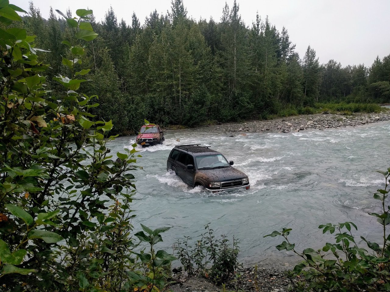

    Yes. First off if you are in a flood then the water is typically salt water, not fresh. MUCH more damaging to all the electronics. Second, if you are driving thru water properly then you should create a bow wave just in front of the bumper, so the vehicle isn't constantly in as deep as water as it would be if you go too fast or slow.
    Sometimes when crossing rivers it isn't possible to create a bow wave. See the attached picture of my friend and I crossing a river up here in Alaska. I've crossed deeper, faster, and siltier rivers up here and I have been just fine, but once you get sloppy is when you will learn a lesson.
