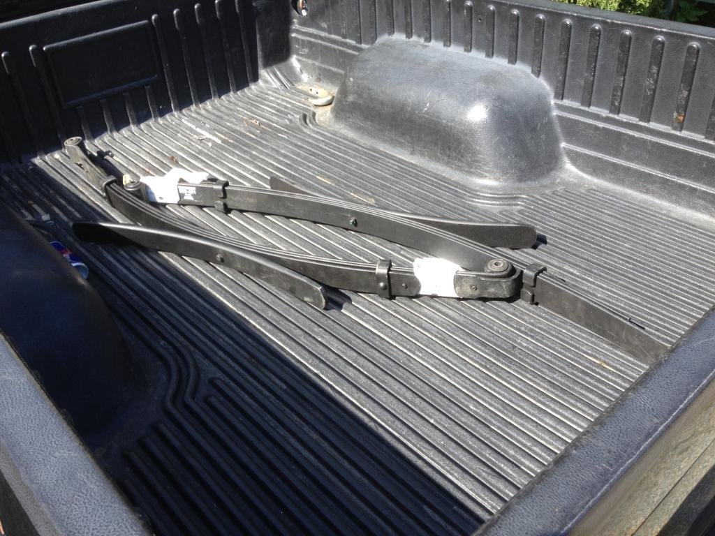

    So I found a brand new pair of Dorman 929-401 leaf springs on Craigslist for 150$. My truck needs leafs so bad they are literally frowny faces, so I picked them up. They're brand new, the guy just bought them for the wrong truck. Any experience with these? I have a feeling everyone is gonna hammer them but I just need something to improve my experience for a year or so until I can get some deavers. I'm going to be doing some light towing this summer, approx 1800lb load so I figured it was a must before I do that. I did some research and there's at least two members who had a great experience with them.
    I was also thinking of maybe doing some polyurethane bushings before I throw them in? Any advice or experience is appreciated.
    Here's a pic of the Dormans:
    624576FA-1C5D-4BDE-B2AF-1016B201EC66_zps_43fffd6cfadadd5224b75616c4d4dae4ba2f6809.jpg

    That's about what they run Per-side, so you got a good deal for new springs. I would advise against replacing the bushings. Not worth the hassle/cost and you've said you might up-grade later. There's nothing wrong with the standard bushings for your application.
    I would strongly recommend you look at your existing U-bolts and related hardware. A lot of folks get away with re-using the factory U-bolts but it's a huge PITA if you break something and don't have the replacement parts on hand. Unless your current spring hardware is absolutely pristine, plan on breaking a bolt or two. It is FAR easier to just have new hardware on hand when you start that job.
    IMO the steel used in the factory leaf springs sucks! I believe just about any aftermarket spring will be a huge improvement in quality over the often-broken factory stuff. I doubt Dorman manufactures their own springs but I don't know their source. It's very possible you got a top of the line brand with Dorman's name on it. I think you'll be happy with those.

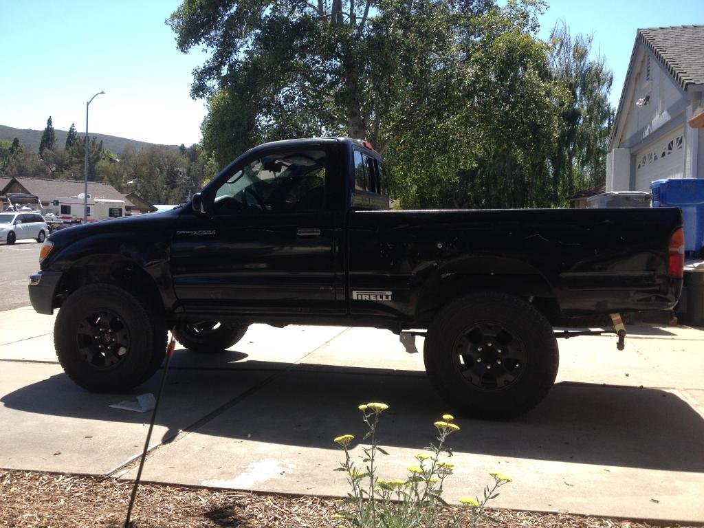

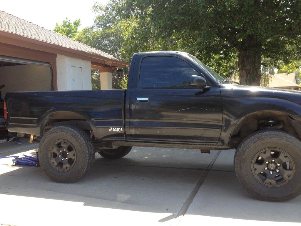

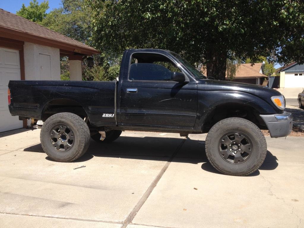

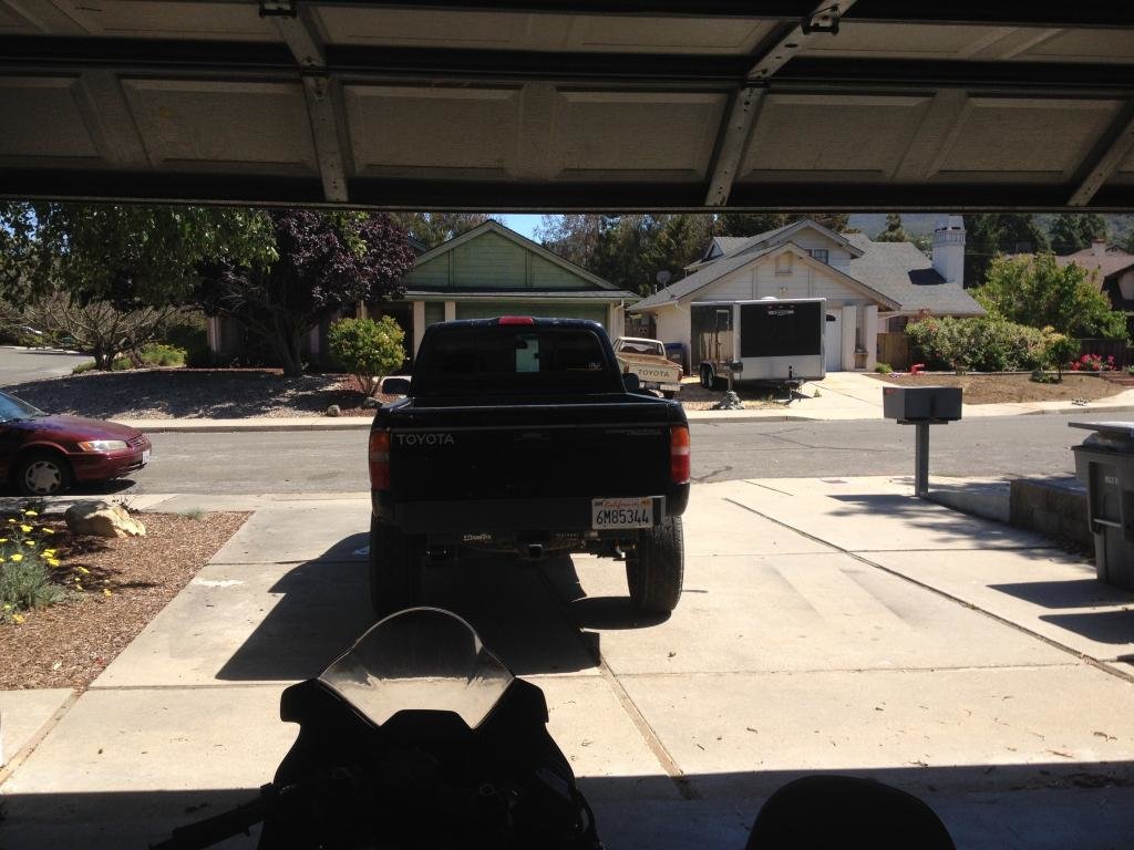

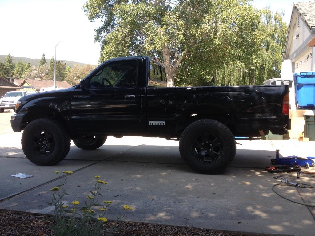

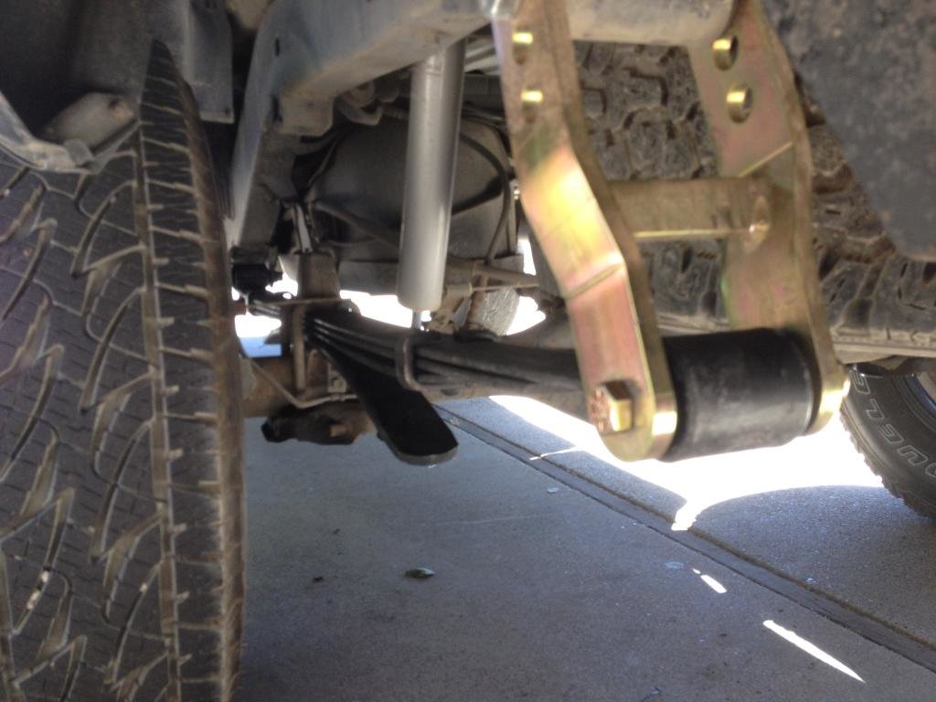

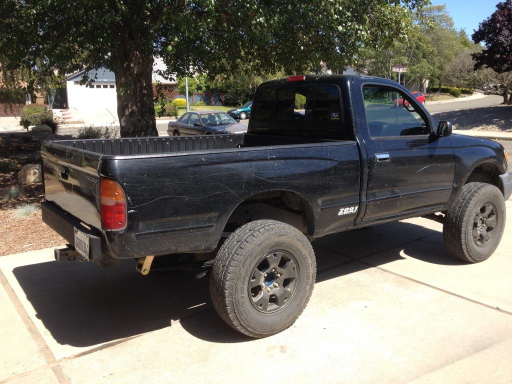

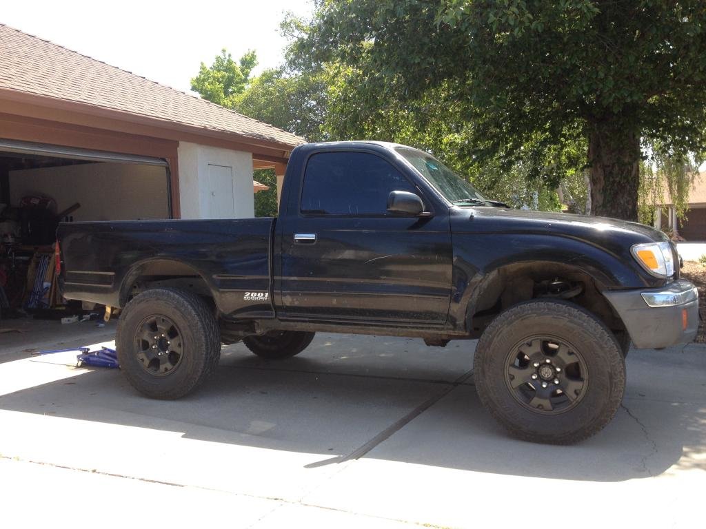

    so I put the leafs on this morning. It took slightly over an hour to do both sides, I was pretty impressed with myself. I used liquid wrench on the u-bolts and factory bolts, but I have toytec 2" shackles and I had to cut the lower bolts on those. Its really weird, the only way I can explain it is the bolts bound inside the leaf spring bushing. it was like they were welded in there, and I only put them on about 2.5 months ago. In case anyone is wondering about the lower bolt on the toytec shackles, they are a 9/16"4.5" coarse thread bolt. grade 5 I believe.
    Anyways,
    BEFORE:
    FA5C4F6E-0033-4548-A7A7-90EFFF4B6402_zps_de7f111bef9eb286f9da722ced90351354d46870.jpg
    FF0659E0-54B2-4A1B-98B9-8A0A42C9CFE7_zps_5e893f0d03af282d8780de01e5bc4f9d2ad2057a.jpg
    2A01EF91-522F-4DD4-915B-CAD6882961DE_zps_2abde7b69701c30b5ced3fe885a3bd726012523a.jpg
    *****AFTER*****
    4DA47C23-6E7E-4D2D-AEBE-D878314A2A85_zps_02d3ad88f97c025b8bc2b6f1cc4989354b4c83a2.jpg
    7B6EF80E-BA57-429E-9FFD-B884ADECA803_zps_69c5130ceb9d537b9dc5baaef0459d4553324f5e.jpg
    Still leanin' pretty hard:
    DCA53C81-8CFE-44D3-BCDC-12DCC35B9261_zps_67a573983462ed0c5e5e48053fe8946c520ee85d.jpg
    426A4A0C-FDDE-4CA7-8770-C8945265AE69_zps_fd6021d9d38d6aaec03555d63e234ed35e8e5cac.jpg
    1F4AB9B6-F4D4-477C-8484-7FEA3AA58B4D_zps_b4421b76d8719b374f3e9d1c8e5ee8b2aba2b6c9.jpg
    670AFCBB-76F5-4E91-B7DD-E3B47AD0F3E6_zps_4fcea2c4330205ffd979d2bd9f02983766a0392f.jpg
    you can see the left side is almost flat :( so I will probably be doing an AAL. I've seen some guys make some pretty cool custom ones from leaf blanks. So I could probably do a slightly stronger one on the driver side. Overall, I think the leafs are stiffer, but time will tell.

    Oh yeah, the taco lean! Were the pics with full tank of gas? Hard to understand how those bolts seem to grow and adhere. My leafs look a lot worse than flat. Good work!:p

    Haha that makes me feel better. Yeah full tank of gas!
    Update: definetely a little firmer which is what I wanted!

    As for the lean, it wouldn't concern me in the least. Gas tank, steering column, battery, driver and more, all contribute to that. That off center weight takes its toll on the body bushings and the body itself. The left springs are slightly stiffer to compensate.
    For day in / day out use; I think you'll find the current setup to be perfect. There is a HUGE difference between vehicles designed for EXCLUSIVE off-road use vs. a vehicle that must spend most of the time on the road and only a little off-road.
    You got a good deal and made a practical improvement. For those of us that live in the real world - a pragmatic approach to life makes life good !
