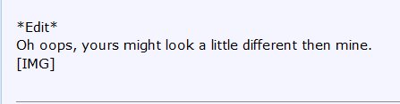

    I think for Auto, you have to cut one of the wire loops on the box...it's been awhile since I did mine
    *Edit*
    Oh oops, yours might look a little different then mine.

    How do I see the Image you posted? I've been seeing this a lot on this form but don't know whats causing it.
