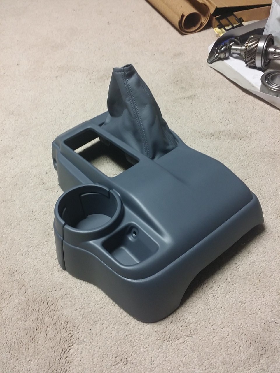

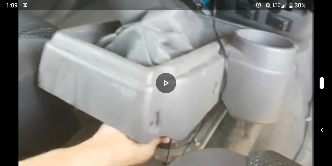

    Swapped to Manual Trans & 4x4
    Here is the one on my truck for the manual. It's for bench seats. You can see what he's talking about here regarding the tabs. I cut off the center console tabs to make it fit

    Great. Can you post a picture of it installed to see what the fit looks like?
