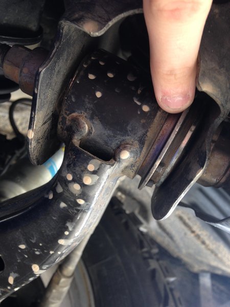

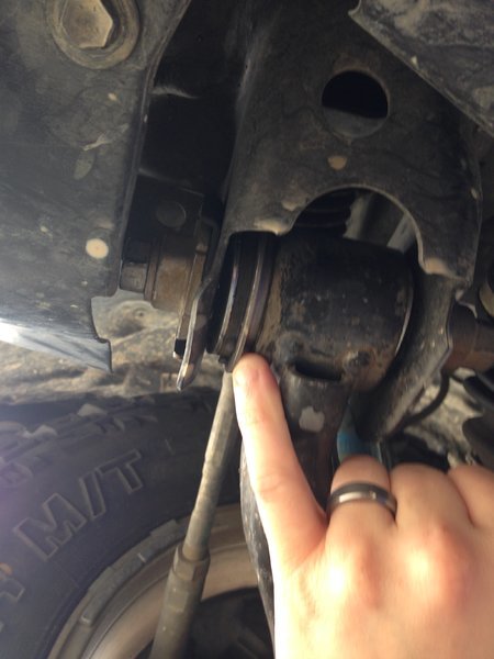

    image.jpg image.jpg Well a few days ago my clunk came back... Not not as loud sounding. A few weeks ago I swapped out all 4 of my LCA bushing. Today I crawled under my truck to find out that the front bushing (smaller ones) have came "unpressed) when I had them pressed in, they were flush. Now there is a 1/8 inch gap from where they have popped out. Both driver and passenger side. Where my finger is is where the gap is, and shouldn't be.
    Iv actually thought about getting the bushing tach welded into place so it can't move.
    Conclusion..... ROCA is a no go.
