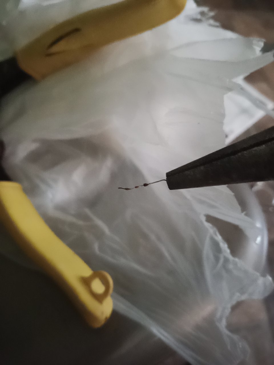

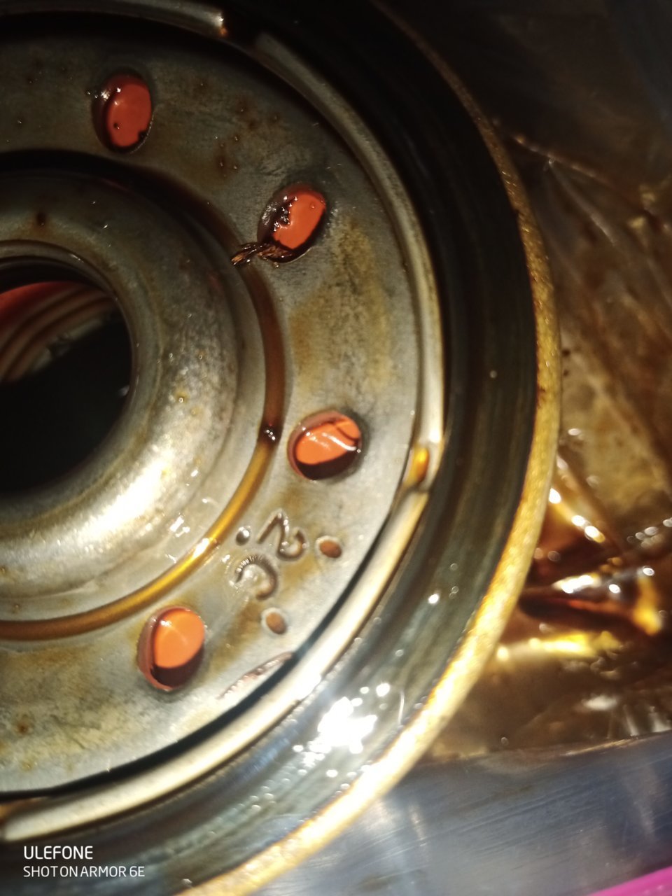

  20. Jul 13, 2020 at 4:12 PM
    #20
    Tacomaislife
    Tacomaislife [OP] Well-Known Member
    Jan 24, 2018
    #242231
    546
    Texas
    2002 tacoma trd
    These is the metal I found on top of the filter
    Don't mind the filter it got debris since yesterday because the oil filter outside all day
