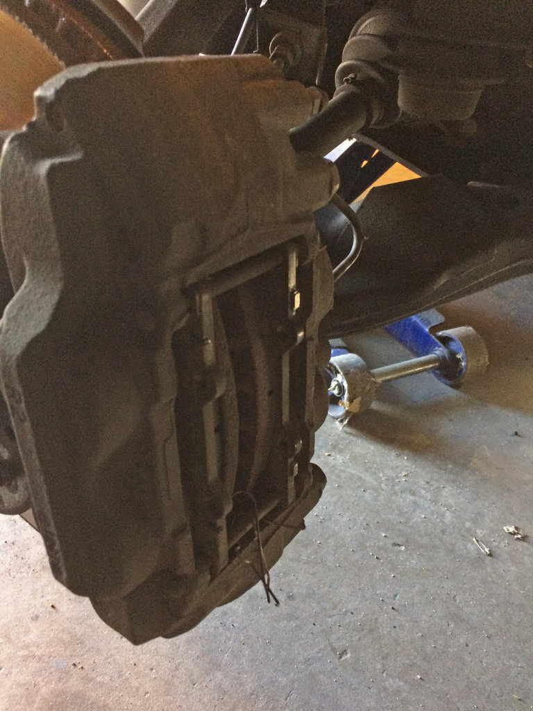

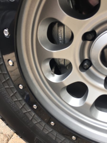

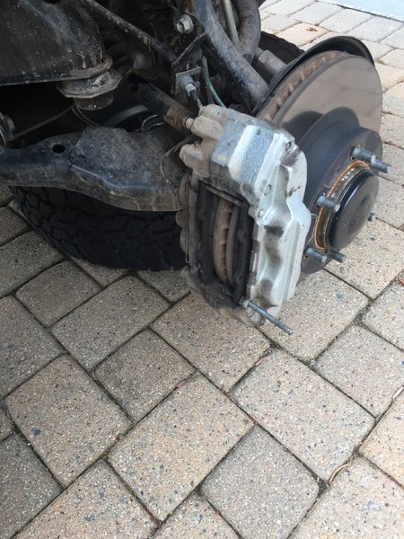

    Well shucks, found the source of my rattle. Lower pin walked loose OR the dealer forgot to put the retaining pin back in after a tire rotation and brake inspection. I have no proof, but either way it's a shitty design. They should use cotter pins like on my motorcycles. I'm just glad it didn't damage my wheels. IMG_0072.jpgIMG_0073.jpgIMG_0075.jpg

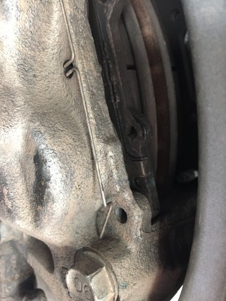

    I had a rattle develop in my front end and it was the spring. Although in my case it was pretty obvious why (it had snapped). The symptoms were a metallic rattle that would stop with application of the brakes.
    The Toyota part number for these springs is 04947-0C010.

    Thanks so much for the brake pad quiet tip! I did that as well as the double spring mod and it got rid of most of my rattling, all the brake pad slap, and even got rid of some minor steering wheel vibrations and what sounded like a bad wheel bearing that must have been caused by the pads dragging! So much happier with the truck now!

    Pin came loose for me a couple months ago. Heard a noise leaving work and figured it out after pulling over 3 times within 2 miles. Lol. Luckily I had a set of new pins ready to go in when I got home.
