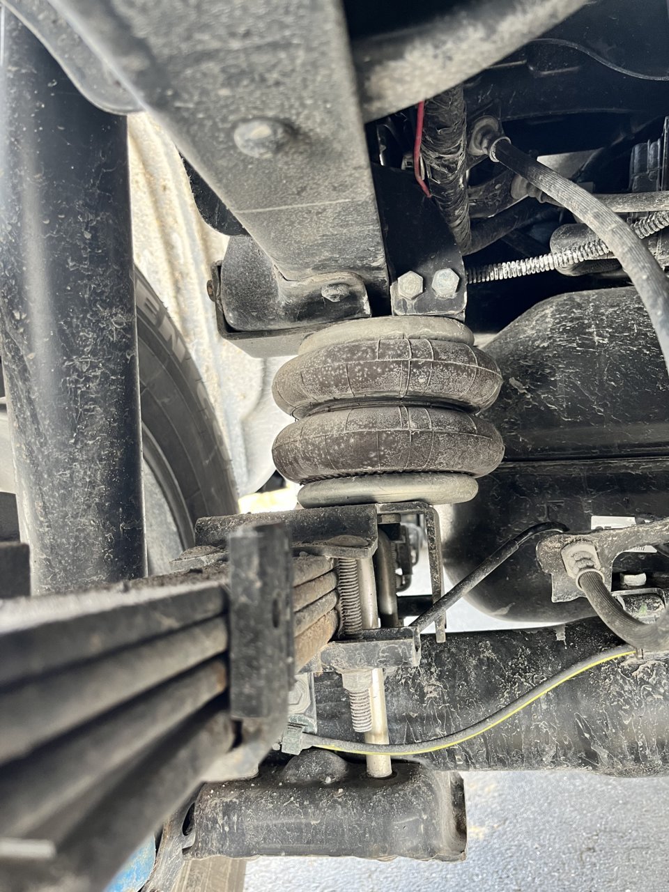

  9. Jan 27, 2022 at 11:58 AM
    #469
    joncure
    joncure Well-Known Member
    Jul 25, 2021
    #372245
    307
    VA
    2021 TRD Sport Access Cab manual
    Gotcha. Here is a pick of my air bag set up. You’re saying I can add cradles without uninstalling air bags?81358392-8964-46DB-A009-E2DCAF3B45D9.jpg

  10. Jan 27, 2022 at 12:11 PM
    #470
    blitzkrieg3002
    blitzkrieg3002 Well-Known Member
    May 30, 2016
    #188296
    1,218
    Rick
    California
    2019 Tacoma SR5 4x4
    Pretty much. You'd need to remove the lower mounting bracket on the existing airbags where the cradle would then be installed i believe.

  13. Jan 27, 2022 at 1:37 PM
    #473
    Drainbung
    Drainbung Somedays you are the show....
    Sep 2, 2010
    #42629
    9,331
    Bob
    Fallabama, NV
    10 DCLB
    TRD Fleshlight
    Yeah, very easily done. As mentioned just disconnect the bottom mount on the bag and the cradle bolts right in place.
    The suspension that you're looking at with the airbags will handle the FWC no problems. Just make sure you switch to Load Range E tires if you haven't done that yet and you'll be gold.

  18. Jan 27, 2022 at 4:32 PM
    #478
    joncure
    Jul 25, 2021
    #372245
    307
    VA
    So, last question before I order these cradles;
    I understand how to install them, they bolt into the lower bracket where the air bag would bolt in. Ride-rite model has one hex bolt that screws into bottom of air bag from up through bottom of the lower mounting bracket.
    Question-apparently the air bag just sits down into the cradle without bolting to it? Does this affect the structural integrity of the system-bottom of air bag simply sitting in cradle and not bolted to it? I’m sure it won’t come out of cradle, but it’s just sitting in it, unsecured.

  20. Jan 27, 2022 at 5:53 PM
    #480
    Drainbung
    Sep 2, 2010
    #42629
    9,331
    Bob
    Fallabama, NV
    10 DCLB
    TRD Fleshlight
    Yeah, the bottom of the bag just "nests" in the cradle. I've had them on my truck since 2013 and no problems at all.
