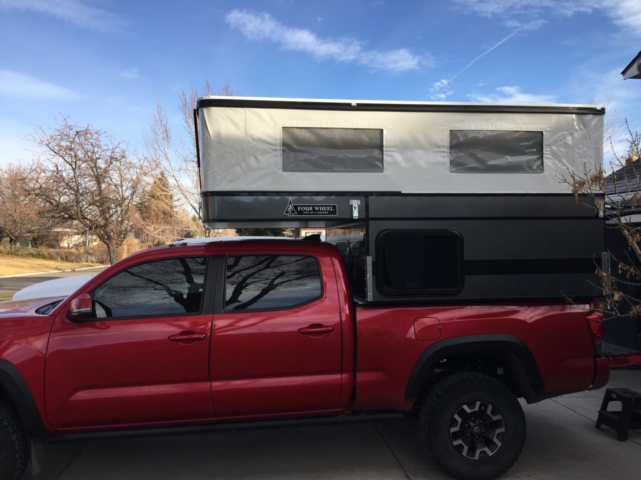

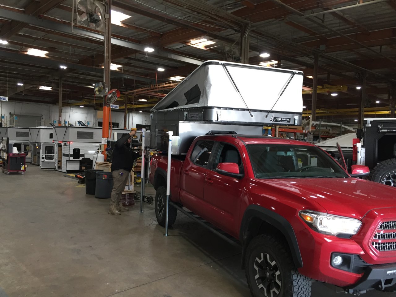

    It’s Four Wheel Camper Project M time!

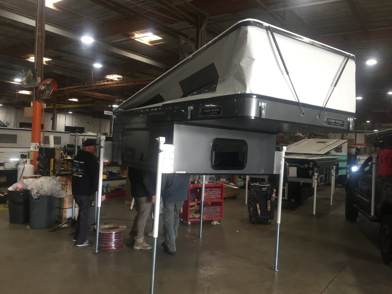

    I’m at the Four Wheel Camper factory getting the sixth Project M Shell out of the factory installed today. According to the installers, this is the second Taco to have one installed.
    Fingers crossed it all goes well! I am a bit nervous being an early adopter. FWC’s been around along time and know how to make great quality slide in campers.
    The folks at FWC have been great so far allowing me to watch the install. Being the fourth Project M install for them they are still figuring out the process.

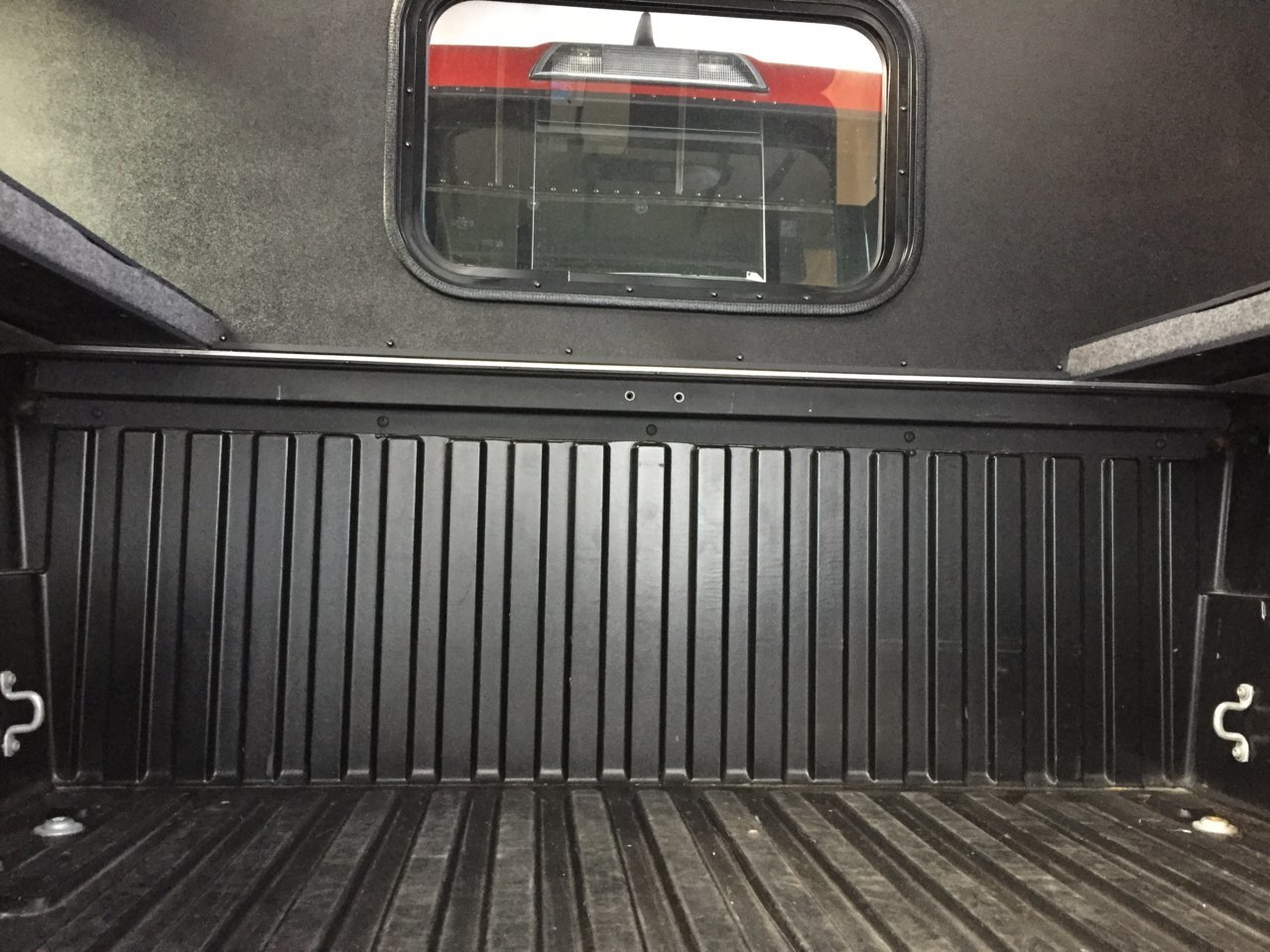

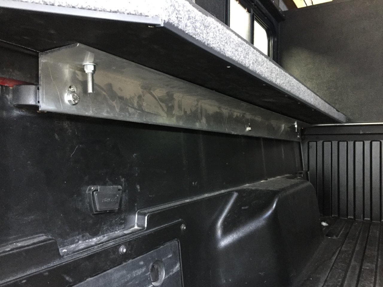

    The install took four hours. They told me their goal is to get it down to two hours. They custom fit the shell to each make/model of truck and individual trucks. Mine was the first to get an improved tie down system which essentially is angle aluminum tied into the factory tie down rail.
    It’s definitely not very sophisticated but does the trick. It also make it much simpler when you reinstall if you ever had to remove the shell. They also use flat aluminum stock at the front of the shell. This allows them to adjust the fitting depending again on make and model. Essentially this model shell would fit on mid size trucks not just Tacomas. They would then tailor the install to fit the particular truck bed.
    They used a good quality double bulb seal around the base which is good. A lot of shells on the market use inferior foam seals. When I removed my old ARE shell, the foam was flat and didn’t rebound at all.
    Overall, I was pleased with the experience. They were fairly detailed with prepping the shell and with install.

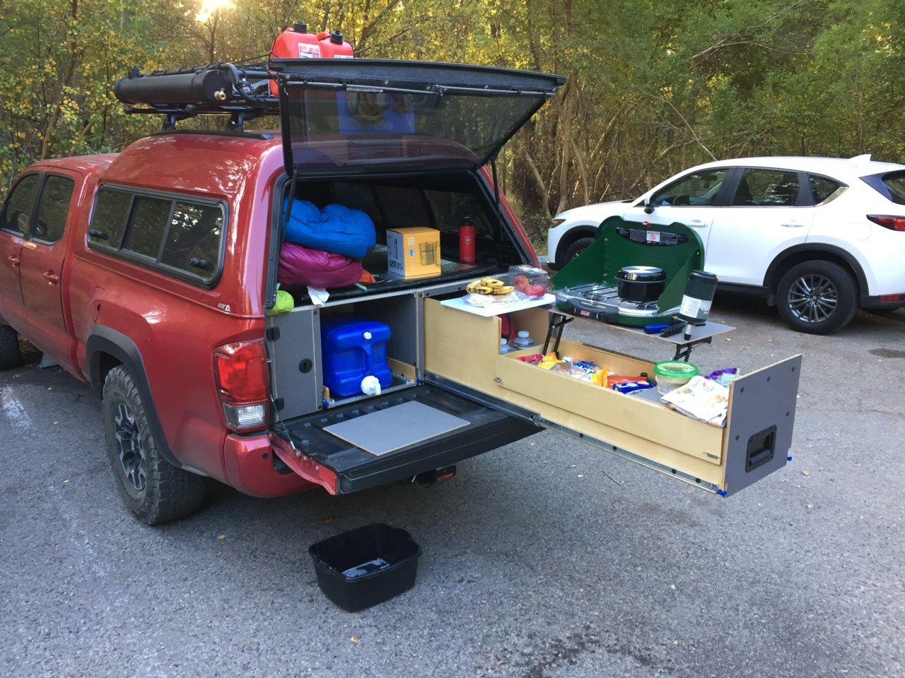

    No my suspension is not stock. At a minimum you would need to do an add a leaf. My previous build was about 500lbs constant weight and it really sagged in the back. This is my previous build. Before I upgraded my suspension.
    I am now running Icon RTX leaf springs. I opted to use all a eight leaves. With those springs and the weight I had about 1.5” of lift in the back over stock. The ride was awesome with that weight. If you didn’t want to do a complete replacement, a three leaf progressive add a leaf would be ideal. The other option is air bags. But I’d start with the progressive add a leaf first.

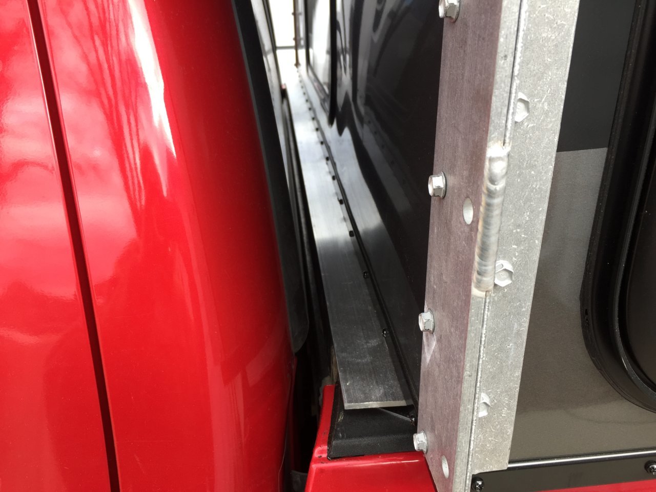

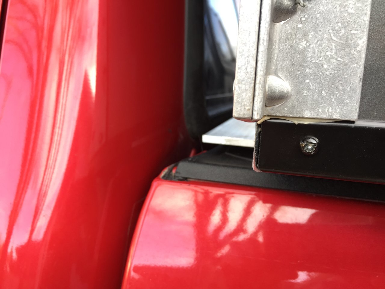

    1. The most important issue I found was several gaps between the bed and shell that needed to be sealed. They were significant enough that water intrusion would have been an issue. At the front of the shell they mount aluminum flat stock at the time of the install. This allows them to adjust the fit for a given truck. The double bulb seal is affixed to the flat aluminum.
    You can see the flat aluminum sandwiched between the front bed rail and shell. The issue is on the sides where the bulb seal has to step down to the flat aluminum. This creates a gap between the bed rail and the seal. This is not a huge deal since I caught it and put silicon in the gap. Since I don’t plan on taking the shell off, this won’t be a problem. I found another gap in the rear drivers side corner where the installers didn’t quite get the seal lined up. Again a shot of silicon filled that one in as well.

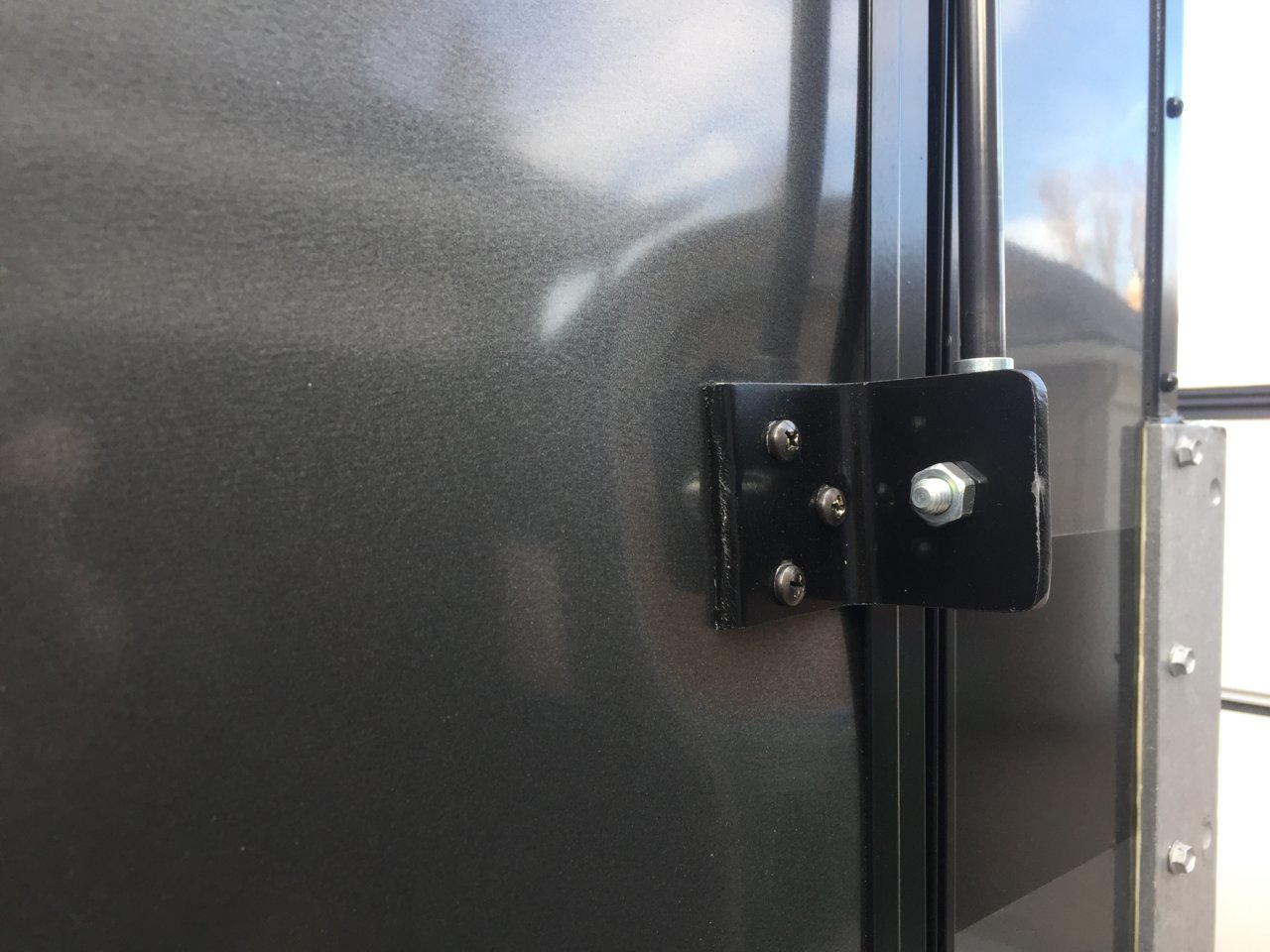

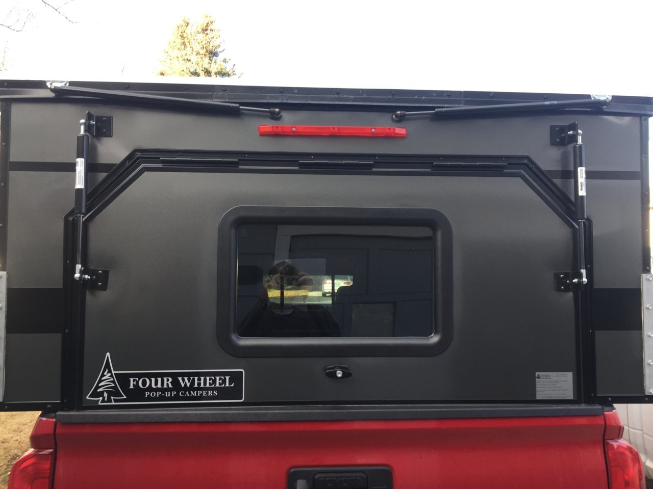

    2. The next issue has to do with the back door. There are two large lifters on the outside. They mount to the back door. The mounts have to be slightly angled to accommodate articulation of the lifter when the door is up. The issue I have is the angle of the brackets from one side to the other do not match which means they are eye balling the install and not using a template. Again not a big deal. It is just aesthetics. Another issue is when mounting the brackets they crushed the door. This caused a gap on either side of the door which would allow moisture to get into the door. FWC needs to put something inside the door to prevent this crushing. I filled the gaps with black silicon which should solve moisture getting into the door. Additionally, the door gasket doesn’t seal at the bottom of the door or either side. Their is a gap where the seal should touch the door frame. I fixed this by putting my own weather stripping around the door frame. I’ll go into more detail on this in another post.

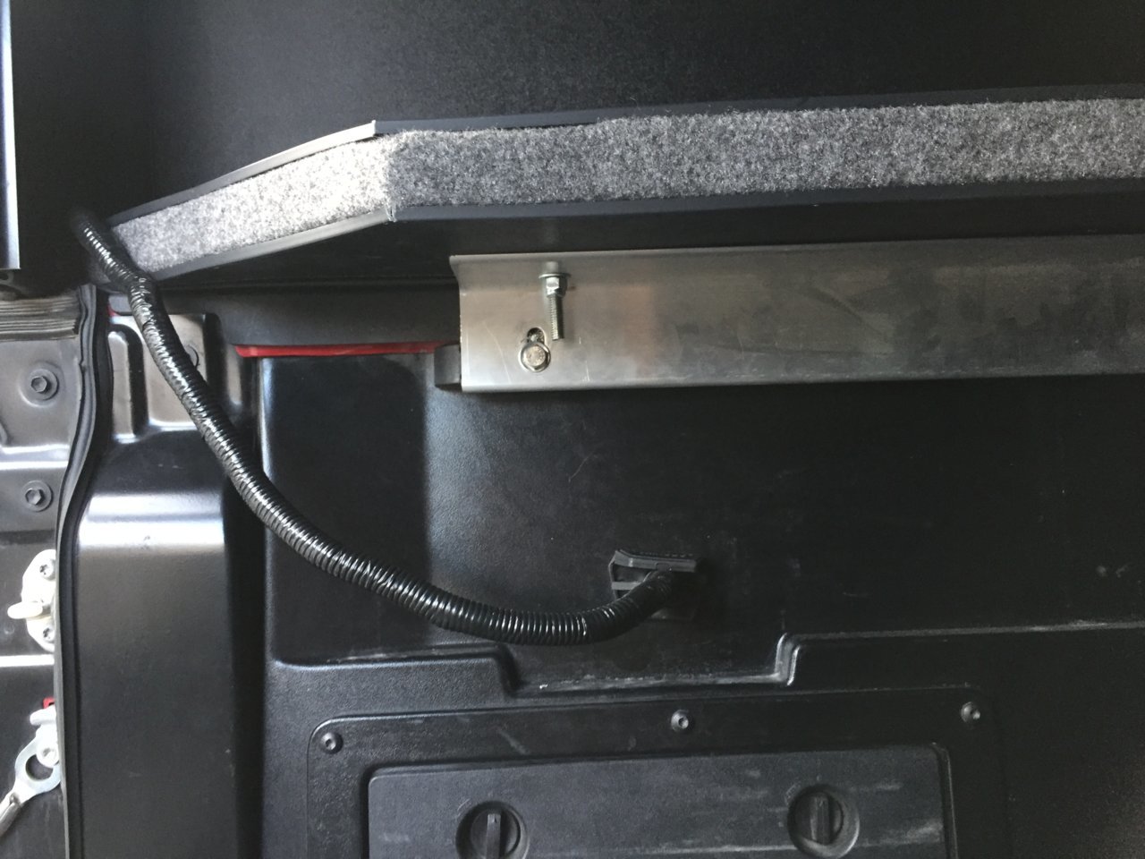

    3. The most annoying issue I have with the whole install is how they tied in the tail light for the third break light. This is ridiculous.
    Seriously FWC. You are much better than this! They used the same plug they use to connect their slide in campers to the vehicle battery system. Way over kill and not even close to elegant. I will be removing this and coming up with a better solution.

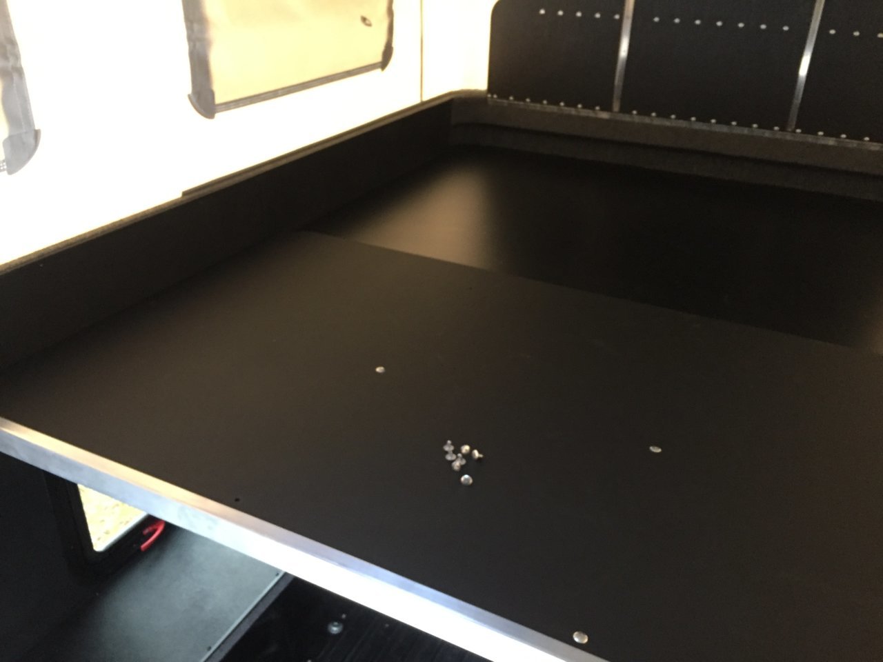

    4. There were a few other small cosmetic issues. They left a lot of metal shaving related to the angle aluminum tie down plates. I removed these tie downs in order to seal up the bed and was able to vacuum them all up. Otherwise over time they would have come out. Since I plan on putting a house battery in the bed, this would have been problematic. There were also metal shaving under the slide out bed platform. This was very surprising since FWC has a crew that meticulously goes over each camper. [edit] 7 of the 12 rivets holding the bed platform together came out. A simple pull or push on the platform would have revealed this.

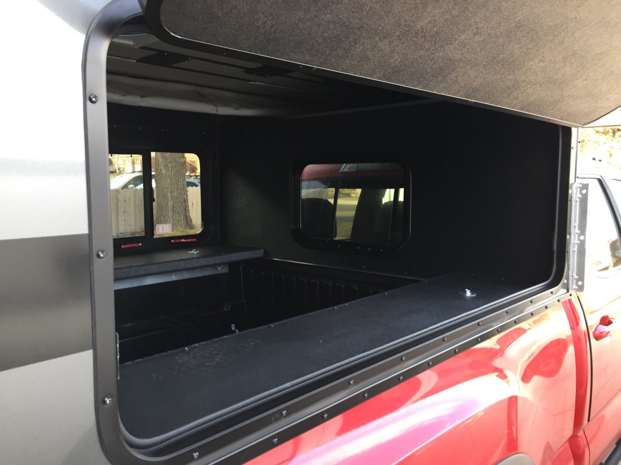

    Additionally in the bed area, they use carpet on the walls. The front piece of carpet is tattered and frayed at the bottom. This would be covered up by the bed. Finally, the corners of the trim pieces on the outside bottom of the shell don’t line up. They are cut 45deg angles. They covered it up on the back corners with caulking but did not on the front. This can be seen in the first picture above. This is just shoddy craftsmanship and lack of attention to detail.

    Interesting how the back door hinges are mounted. Different from the pictures on their website. I do think that the way they mounted yours, and crushed the doors, is sloppy and actually unacceptable for a camper that cost pretty much 10 grand. I am really surprised how sloppy they were with the other issues that you mentioned. You would think that they would be extra careful on the first models sold, because the reviews of this new camper will be based on on the first few.
    I was considering this camper, but will be keeping an eye out on how they hopefully improve soon.

    And over half of the rivets holding the bed platform together "came out"?!?! Wow - that seems really shoddy. I certainly expected more from a company like FWC who have been making campers for a long, long time. I wonder if this spate of problems you encountered stems from the huge backlog of orders that FWC has presently? I wonder if they have less experienced workers doing the Project M because it is "simpler" and less expensive than their slide-in offerings? Or maybe we are seeing the inevitable start-up transients involved with bringing a new product out of the prototype stage and into production.

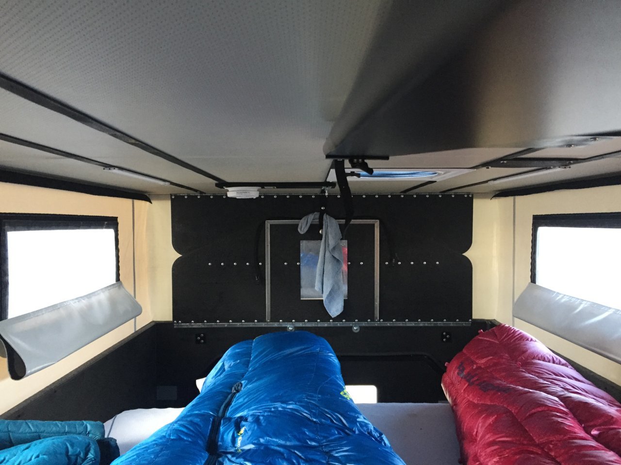

    I am happy with it. It really is a good product despite some of the minor issues. I think the biggest plus is the weight. Mine is 380 lbs according to the sticker on the side. There slide in campers are over 1000lbs.
    I am behind on my posts. I have three I need to write where I will go into more detail. I hope to get those done this coming weekend.

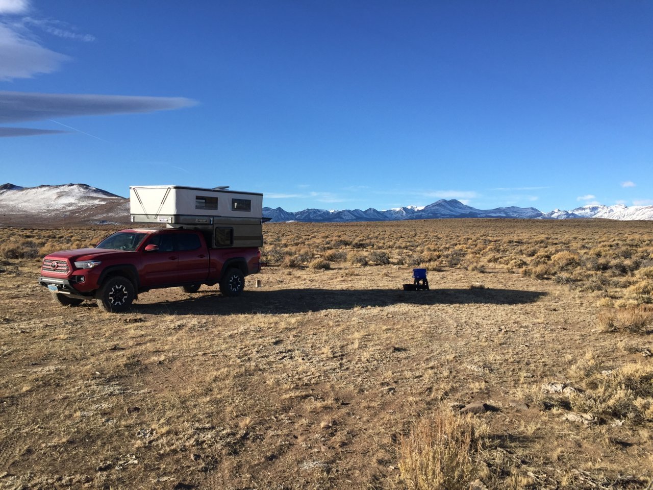

    We took it out for a quick over night trip this past weekend and it performed well. Way more room than our last build. It seemed like a palace inside. We did about 50-60 miles of dirt roads and washboards. No issues came up.

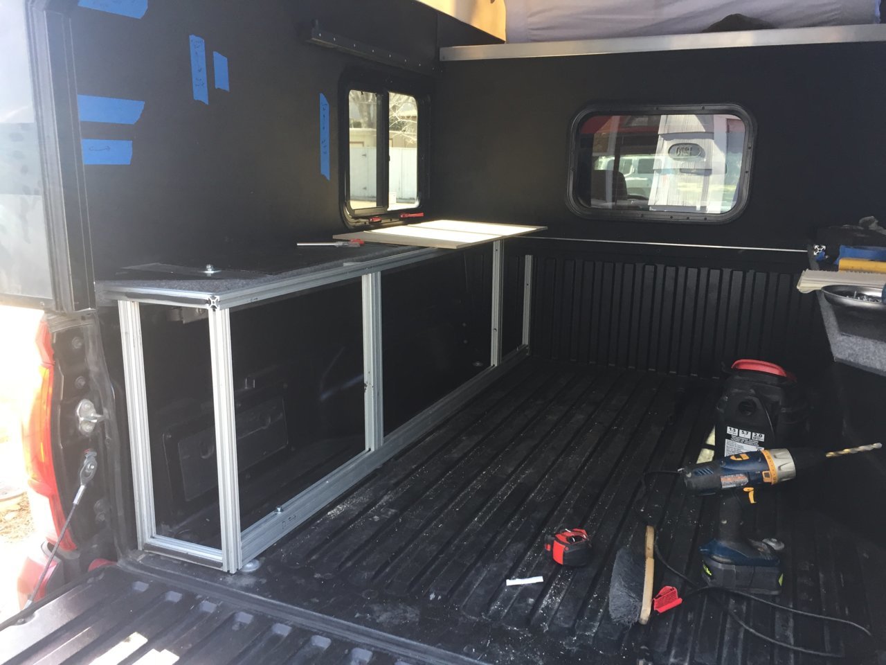

    Yesterday I started the build out in earnest adapting our old build to the new shell. More to come on that.

    [EDIT] One question: earlier you mentioned "Additionally in the bed area, they use carpet on the walls. The front piece of carpet is tattered and frayed at the bottom." - is this carpeting on the walls standard or optional? Reason I ask is that one video interview with the CEO and VP of FWC indicated that the interior - in fact the entire shell - was made of materials that are impervious to water, so that the shell could be hosed out with water if desired. In your photos it looks like the interior walls of the unit are some kind of smooth, hard material, not carpet. Perhaps you can clairify?
