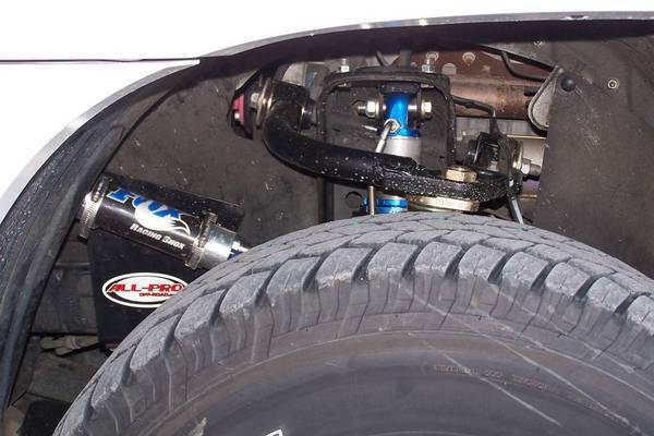

    FOX 2.0 RESIS,LRUCAS,BILLY 5100S ON THE REAR.MAGNAFLOW 11264,COLOR MATCHED GRILL,YELLOW FOG MOD.OVER HEAD DVD,FEDERAL COURAGIA M/T
    here is mine.2.0 and love them.got the lruca as well.good luck. [​IMG]
