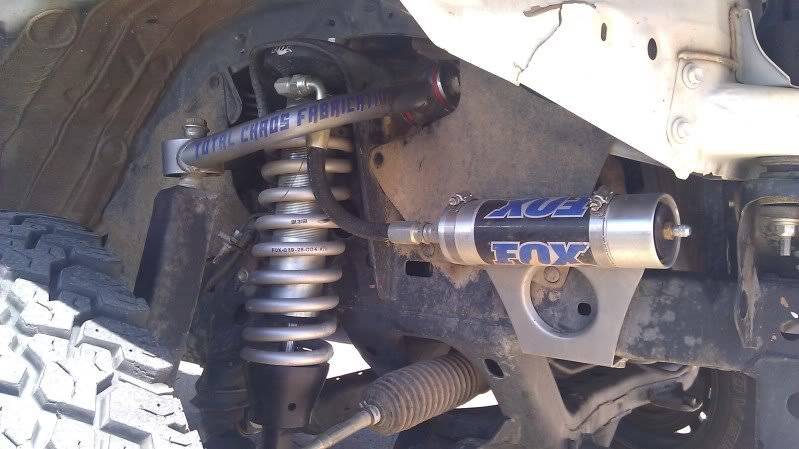

    anybody out there running the fox 2.5 w/ resi on their first gen tacoma? i've been searching, trying to see where the resi mounts to the truck and cant find anything...thinkin about swaping my icons for the fox's any pics would be apprectiated
    thanks guys

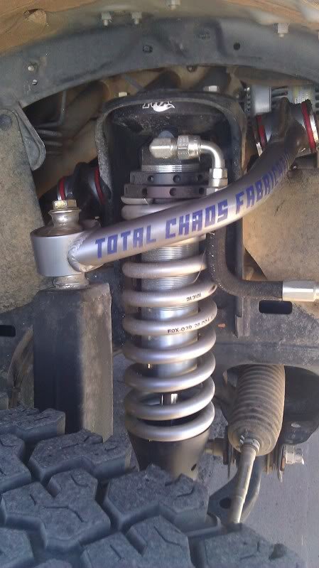

    Quick question: Did the mounting bracket for your reservoirs come with your shocks? Thre reason I'm asking I just got my 2.0 coilovers from AP and there are no mounting brackets...have to order seperately? Thanks in advance...

    came with the shocks.
