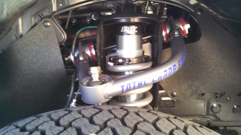

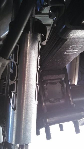

    So i made up my mind.im gna do the total chaos uca n fox 2.5 rr coilovers up front n fox in the rear

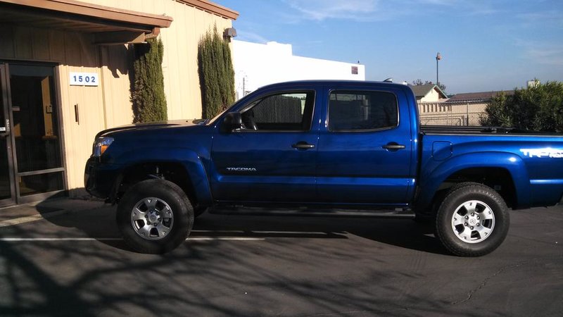

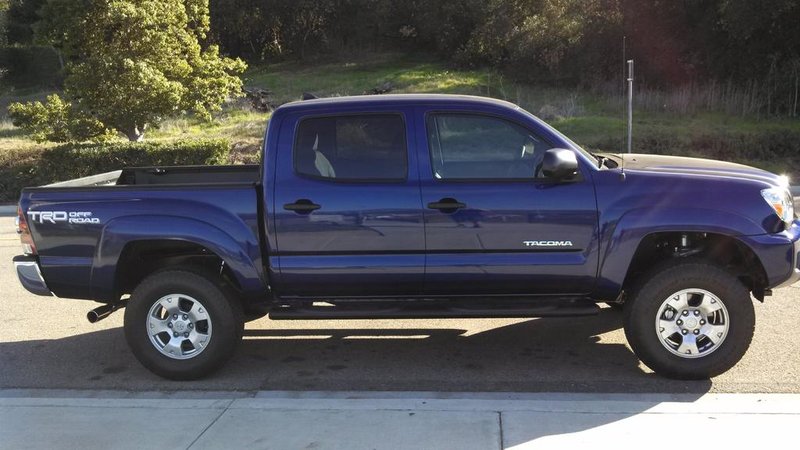

    Ok i got my fox coil overs and i honestly forgot to chech my stock ride hieght b4 i started lifting it.i wanted to set my co at 3" but hav no idea if i did or not.. i got 31" tires and from the floor to the bottm of my fender i messure 38 inches. Does that sound about right?
