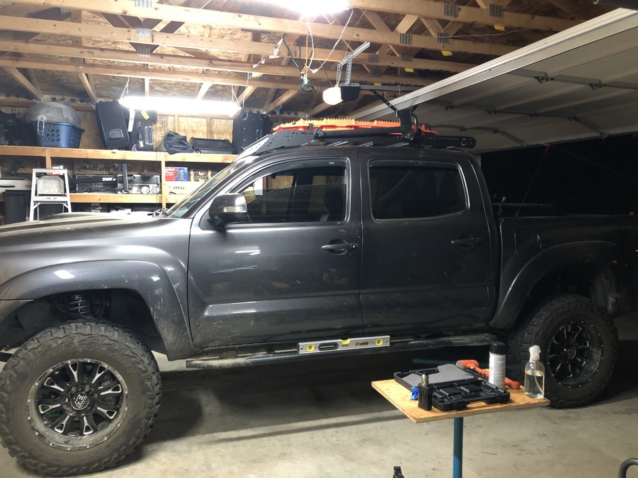

    All done with the suspension. It’s all leveled out.

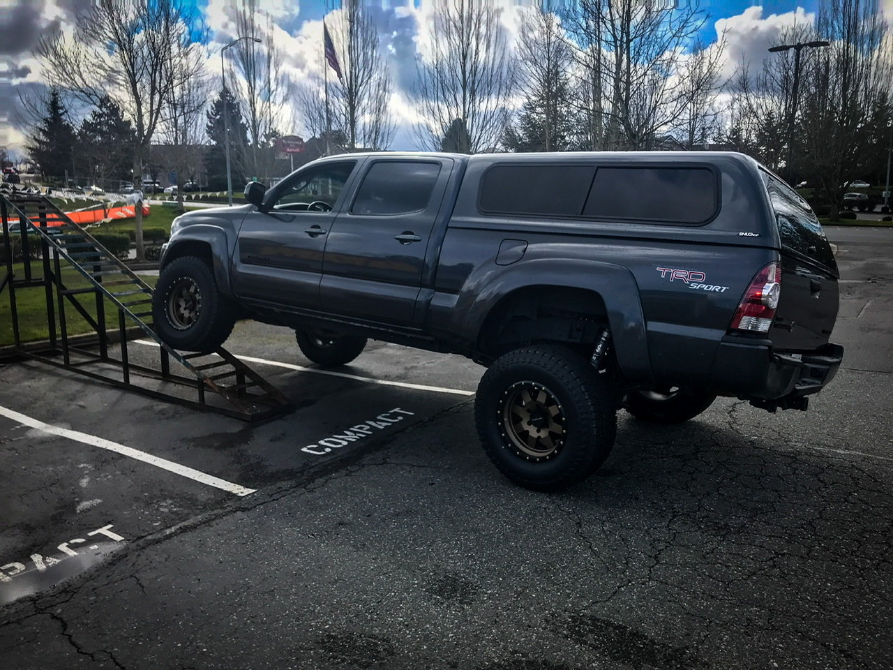

    So far so good!

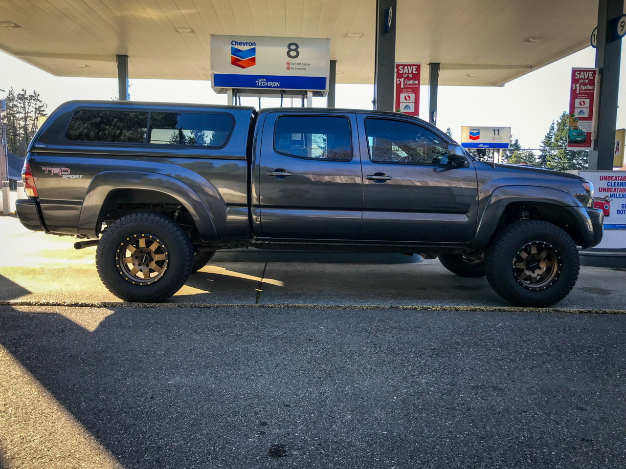

    What is your total lift front and rear and tire size? I have a DCLB and doing an identical set up with the 2-3 inch length rear shocks.

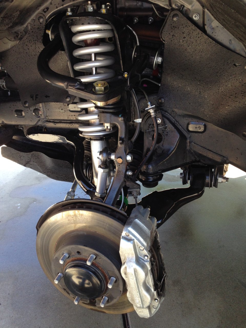

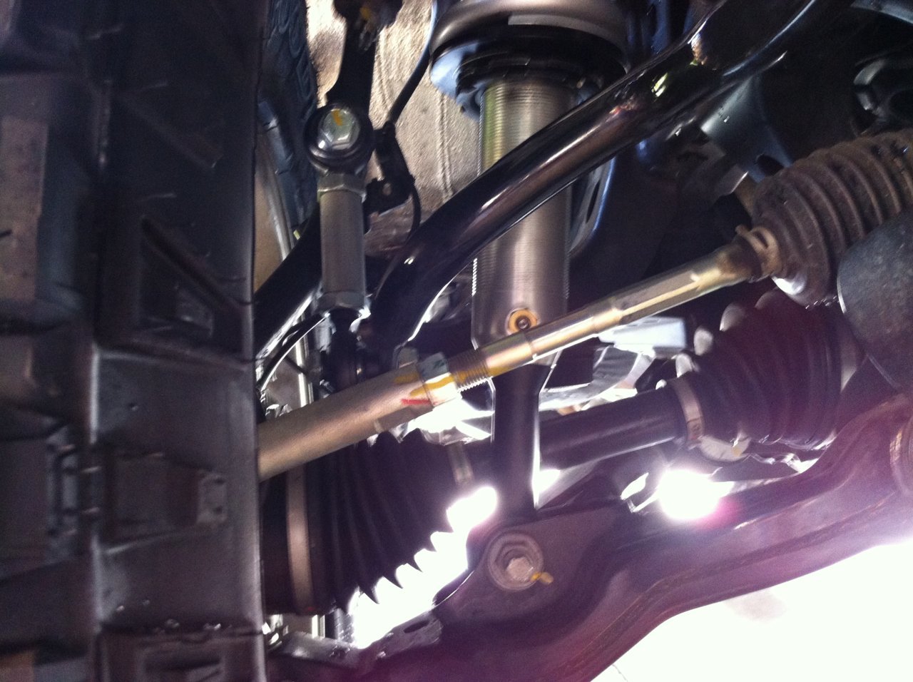

    Here are some pics, I recommend 2.5 to 3" at the most. Truck still road great cranked up. If you look at the coilovers body, I only had to crank them up about an inch to get 3" lift out of them. No spacer on top. Truck road better than stock too.

    This helps a lot. Thank you. I don’t think mine were set correctly from the factory. I have about 2” on my 2nd gen and would like another inch if possible after installing an AAL.

    I ran full 3" and wheeled Moad UT, CO trails, and ID dunes with no problems. Sold them with 40K on them and they are still in use today, 2 years after I sold them. Great coilover for the price. Good luck with your truck.

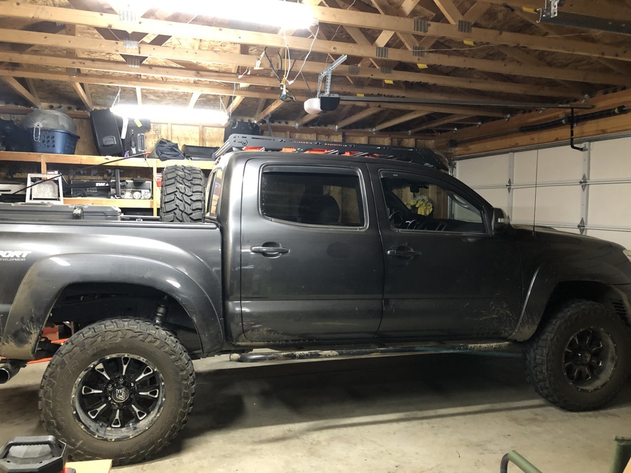

    Thanks again! Followed a few YouTube videos and got it done. Ended up taking the whole strut out, removing the spring and adjusting like that. Was able to be way more accurate. Got it right where I wanted it.
    For those that are searching about these coilovers... this is set with 4” of threads showing on the bottom of the strut. From hub to bottom of fender is 25”. Brand new AAL 1.5” with overload leaf left in. Have it about 2” in the back but I’m sure it will settle some. 1E0D3B4F-89E5-44D1-8B97-6AE91FD7B049.jpg

    This is a before pic after I installed the AAL.
