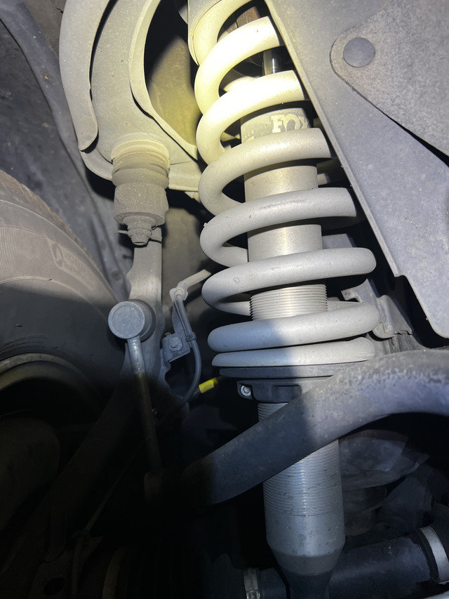

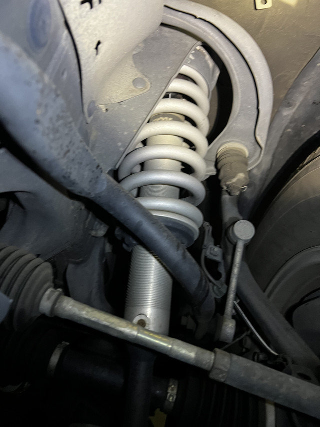

    Reading this thread I may be have some possibility to lift my truck more. So far I have Fox 2.0 with reservoir and +1 ICON AAL in the back. I bought new the Fox 2.0 set (front/rear) but I am guessing when I asked to install them they went on with the straight out of the box configuration. I took a picture of the front right at set up right now:
    IMG-0298_f8aa50f6f043edea3620ca24d0fb8508157c0925.jpg IMG-0299_fec4d6e7f2ddc15b91747b69f3e84cecddcdbcd7.jpg
    My truck is a 2015.

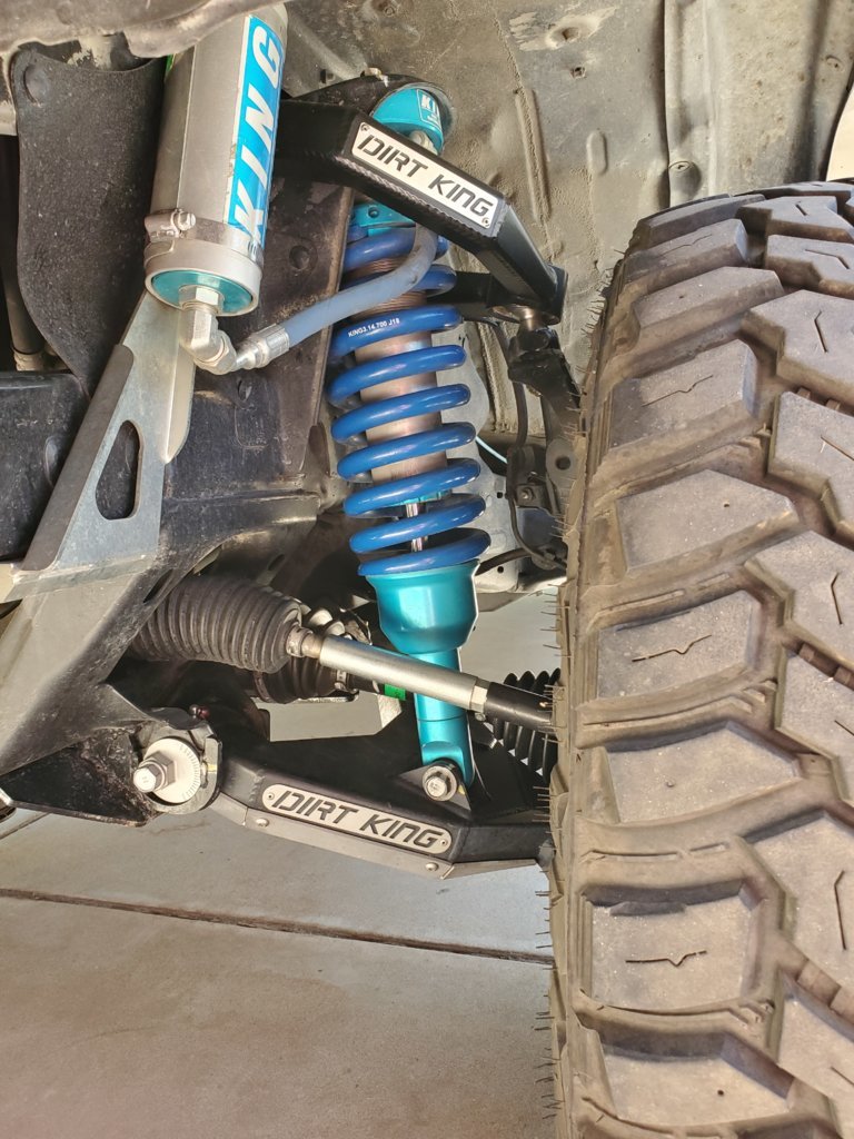

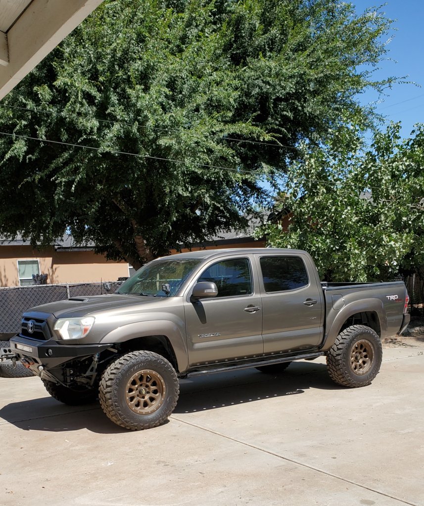

    This was a great lift, but I am on my 3rd lift now and did this. Good luck with your truck.

    Your truck looks really good! Thanks Chris the reply. Very nice set up.
    Just wondered if I could lift up more than the current config I have knowing that I think I am a little bit more than half way on the coils.
    Looking at the picture posted in this thread I thin I can add more height/ turns on the coils.
    I am probably need UCA to make the alignment/drive better.

    In my opinion, don't lift the front more than 2 1/2 inches and diffently invest in some UCAs. It will keep your tires from scuffing.

    Based on the numbers we have, using this diagram, our max recommended shock length at ride height for these shocks would be around 20.625". Anything taller, and you may top out the shocks too often and ride quality may suffer.
    P4x4[QUOTED] likes this.
