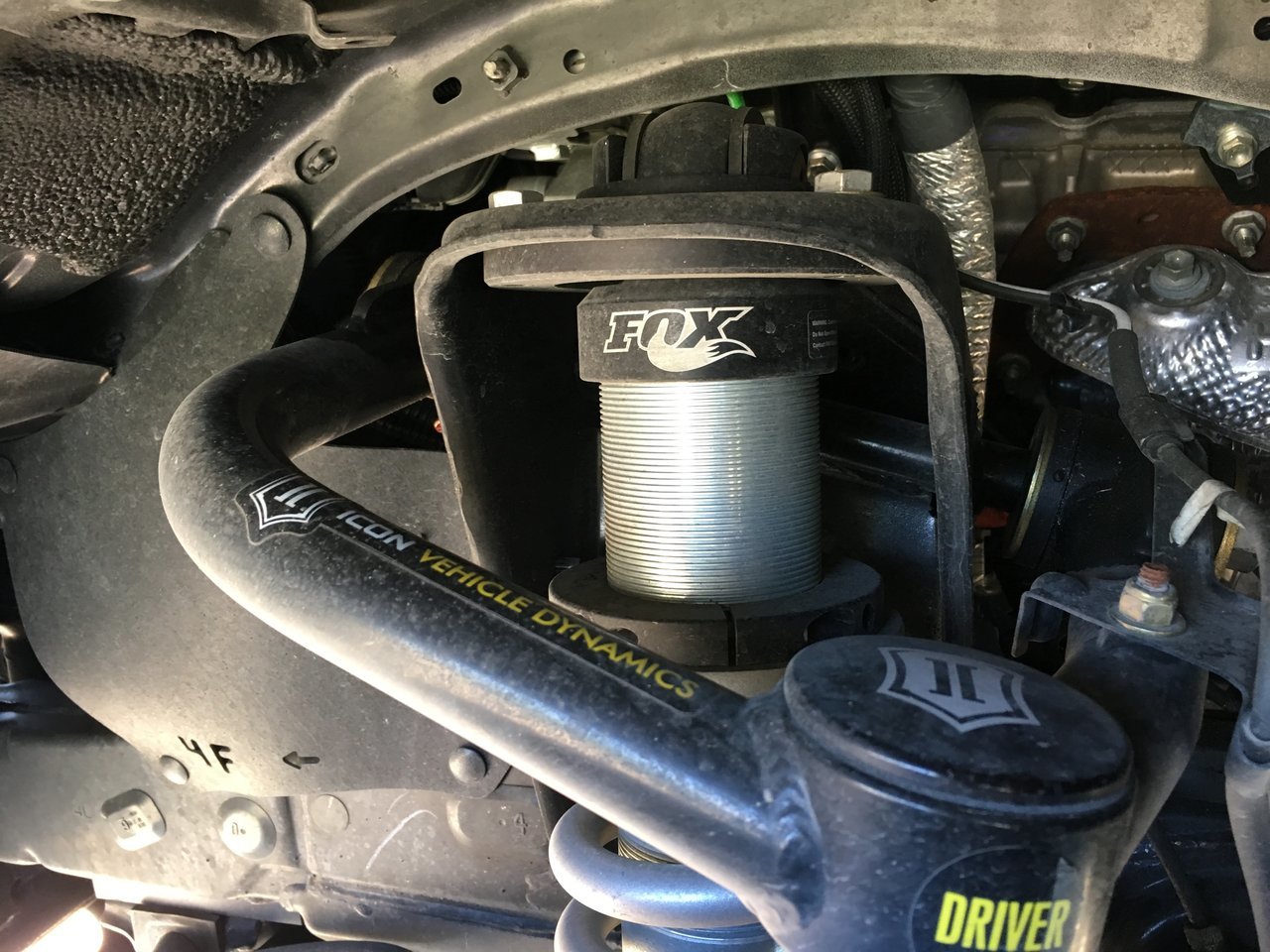

    I'm going to go ahead and ask this because I'm still trying to understand after reading a few threads and watching a rediculous amount of youtube videos. I've got the Fox 2.5's that will lift up to 3" on my 17. Is there a way to adjust them so that I get more lift but maintain the same preload. If I'm thinking correctly, I would just need to turn the treads to raise it higher and not the collar somehow? I've seen videos of coilovers that have up to 3 different collars in which that's possible but mine of course only has 1. I'm just trying to understand this and every time I think I have it figured out I get confused again. Any help is appreciated.

    Holy mackerel!!!! That's A LOT of preload!!!! If you want a easier way to gain 3" is to switch from the standard 13" springs to 14" springs. That way you have 1" already from the springs and just crank it down to another 2" which is 4 expose threads equals 1/2" of lift. So about 16 expose threads on the collar. Simple!....Done.

  14. Aug 4, 2017 at 8:35 AM
    #34
    ktmslado
    ktmslado Member
    Jun 5, 2017
    #220728
    16
    Jon
    17 trd pro taco
    2.5 fox dsc/icon uca, icon omega bypass rear/icon aal, icon bumps Wrangler mtr 285/70-17/method grids
    Your ride quality must be terrible. Lol. That's got enuff preload to make sure u have no down travel and defeat the purpose of the coil over. Should have just put a spacer lift if all u want is "lift"
    Adding that much preload means the suspension is almost fully maxed out.
    There is no more droop and that causes ur front end to dive into bumps rather than droop into them. Companies advertise 3in cause u can crank it to 3inches. But for optimal ride quality(why u spent money on fox shocks to begin with) u should only be lifting around 2inches to maintain up and down travel.
    Putting a taller spring like lord helmet said is a waste of time as u gain nothing at all besides the look of less preload. The taller spring only works on a strut not a coilover. In no way will that help your situation in fact your just fooling yourself that there is less preload when really ur collar is just spun up a bunch more turns.
    If you do put a taller spring and compress it that much u will have negative droop and the harshest ride known to man!
    Upping ur spring rate will in turn raise the front a little more at the same preload that ur at, but will also make the ride quality harsh unless ur adding more weight to the front like a bumper.
    Only way to achieve lift without ruining ur ride is a drop bracket lift like the pro comp or bds. There are many reasons why that's not the best solution as well but we won't get into that.
    It all depends what u want. A truck that looks cool for the mall or a truck that performs for the dollars that you spent.

    Go call fox and ask them about putting a larger spring on ur "coilover" and see what kind of remark and answer u get. Same rate, taller spring on coilover is the same as what he has. Just 1 inch less of threads showing. Some must learn the hard way. Lol

    Please speak facts as ur pics show that my point is proved. Please explain to this man with facts why ur idea is correct but every shock company will tell you otherwise.
    All ur pics show is that the collar is 1 inch higher with 14 in coils to achieve the same lift

    my facts are listed In what I've said. Regarding maxing out droop at that much preload and moving ur preload collar up 1 inch with a taller spring.(shown in ur picture which has no facts cause u listed no ride height)
    Achieving more lift with a drop bracket lift because it keeps your full travel and actually lifts the truck. (Again not saying this is the answer but the answer for the mall crawlers that want LIFT)
    How do I say this in lamens terms. If you leave your preload in the same spot and put a taller spring, all you are doing is crushing the spring and putting excess pressure on the spring and the shaft. Yea it's lifting it to its max but 3in is all u can go. And all u can go for a reason! There is no more travel to accommodate it. There's no where else for it to go. The shaft isn't growin an inch to accommodate ur longer spring. The arms can't droop any further than the stops allow. The travel is limited by the stops. If you want to ride on a completely maxed out suspension pushing on ur stops then this is the best idea for u. Not the intended use of the Coilover.
    Apocotaco has room to crank the preload some more but there is no more room to go up in height. He's not out of threads therefore a longer spring will only raise the collar or just make the ride harder.
    Your picture shows ur smarter than that cause u don't have ur preload cranked on ur kings "to achieve the same height". Notice the collar sits one inch up from the foxes. Hence a 1 inch longer spring.
    Before u get the lord part taken out of ur name cause ur 28000 posts are spam and ur telling someone to buy new springs cause you did it, you should really call fox again and speak with anyone in the building. Or a shock builder, or anyone besides myself cause u obviously can't come to terms that u made a pointless move on ur truck and just don't know it. Hahaha. I'm sorry u will not believe me but maybe if someone else tells u, u might rethink it.
