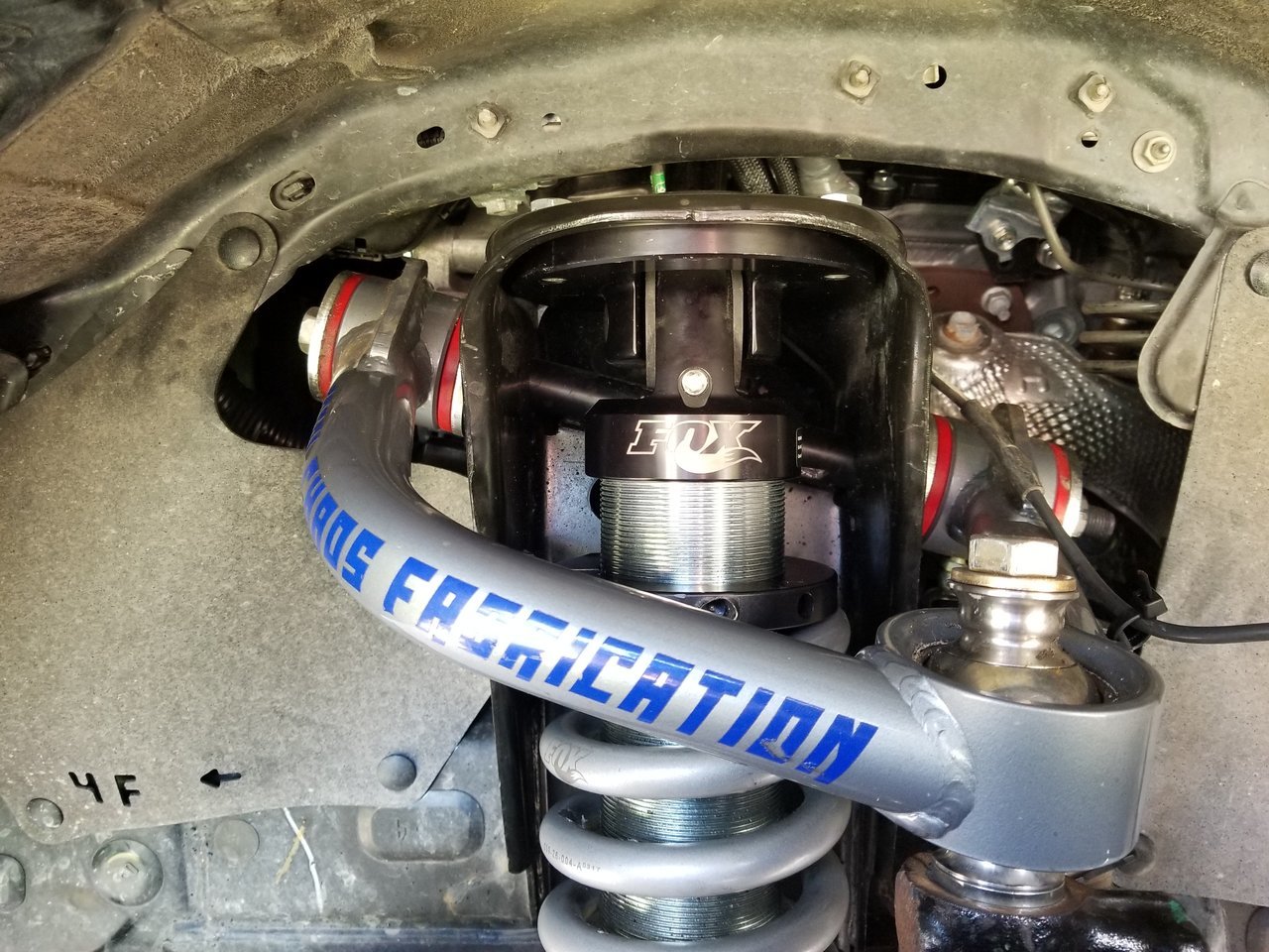

    Heres a cool story bros...
    I have the Fox 2.5 w/o RR which I got from headstrong off-road. The top hat was flipped the opposite way as those with the resi. The collars we're cranked to 27 threads showing. IMO that's a lot of preload. I removed the coilovers and flipped the top hat because thats how it's configured with those that have reservoirs anyway. I turned the collar so that only 16 threads we're showing figuring it would reduce the preload. The truck now sits level and rides much better. I may crank them down more because I'd like the front to sit a little bit lower than the rear.
    Lord Helmet and stevotivo12 like this.

    Got any pics?

    This was with 14 threads showing on driver's side. I lowered them another 2 full rotations. Front is now 1/2" lower than rear. Sits at about 23 1/2" hub to fender while rear is at 24 1/8".

    Yes, it was kind of a pain but only because I had to remove the assembly from my truck anyway to adjust the preload. There is an 8mm allen bolt holding the tophat on. I used an impact to remove this (there is locktite on the bolt so it is difficult to remove with hand tools). Then just flip it and put the allen bolt back in using locktite if you want. You will find this increases overall length by 1" which results in +2" of lift up front, knowing this you can assume 8 threads = 1" lift and adjust accordingly based on your rear height measurement.
    I got lucky and mine came out perfectly level. After the initial adjustment I was able to drop the front another 1/2" the next day without removing the coilover again. Some find it difficult to adjust these while on the truck. I completely removed the allen bolt from the collar and used a 5/8" punch tool to rotate the collar..
