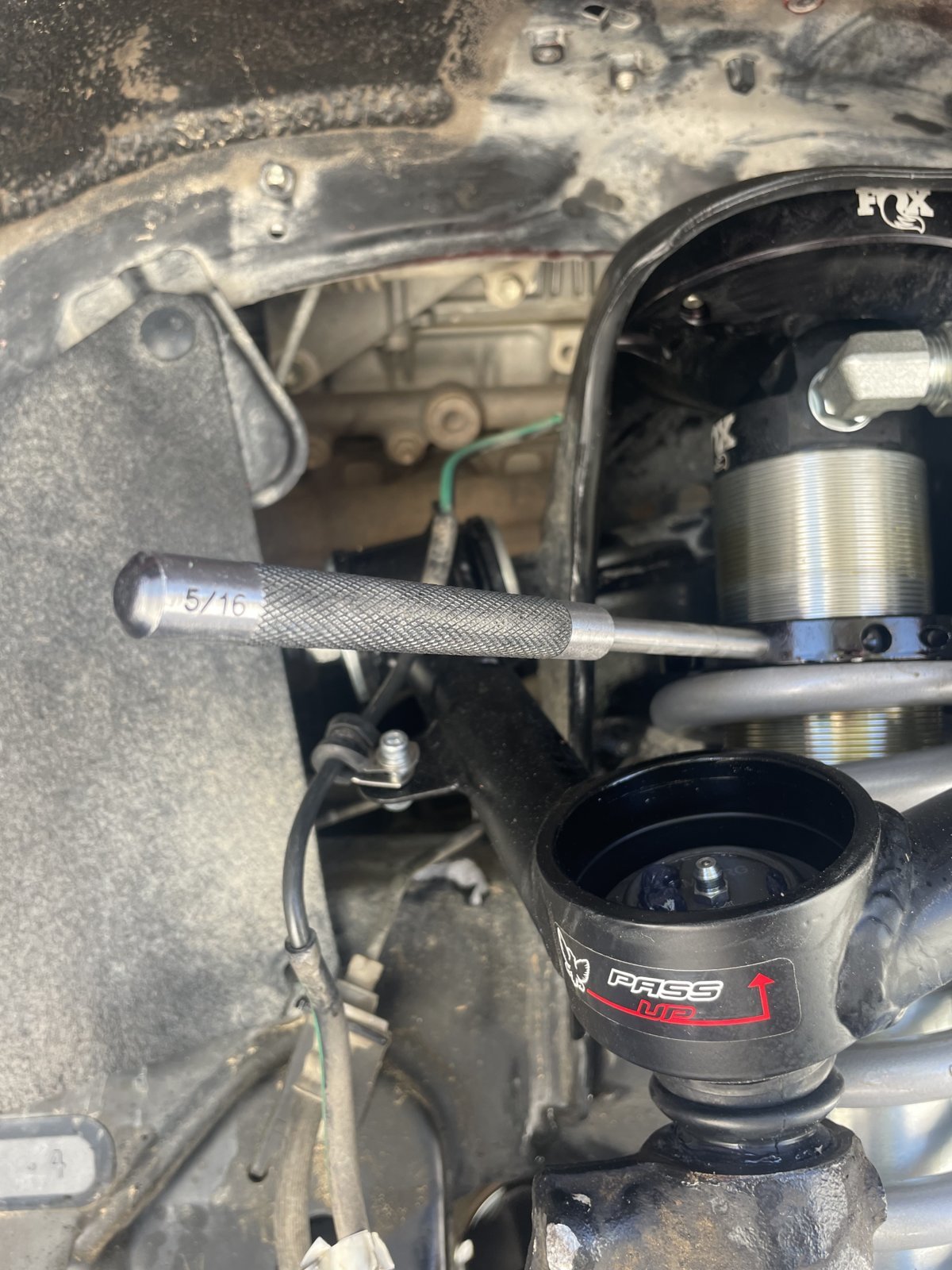

    I'm running the same setup and i too had the same problem. The set screw was out of reach for me and I couldn't loosen it.. I lubed the lock ring a bit, used a 5/16 punch and with a bit of muscle was able to turn the lock ring enough to where I could get to the set screw. Oh yeah and it was jacked up to release pressure off the coils.

    Thanks guys. I bought some punches from harbor freight and with some muscle was able to get them adjusted.

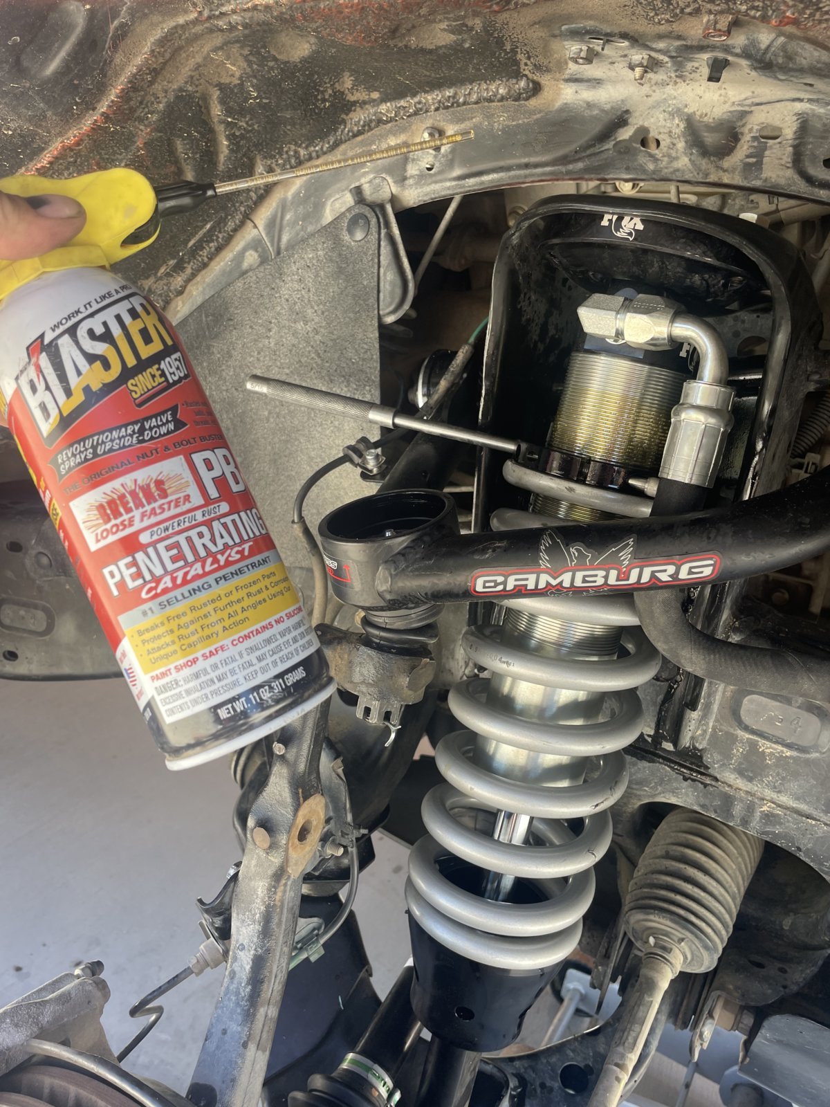

    The method works muscling through it with PB (a crap ton!!) spray as you go and it gets the job done. I used a box wrench as a little more leverage on the punch to make it easier. Small increments.

    Alright I am going to adjust my 2.5's tomorrow and I want to confirm how y'all went about it.
    1) WD40 the hell out of the threads and as you work.
    2) life the truck to get the pressure off the coils.
    3) loosen set screw just a slight amount
    4) Turn collar till desired height (I bought a spanner wrench like a chump.)
    5) Tighten set screw
    6) Enjoy.
    Thanks yall

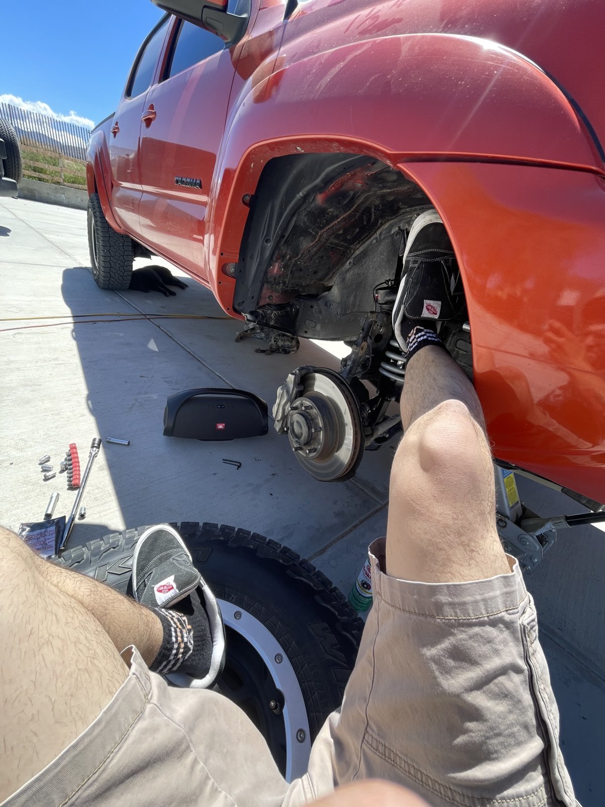

  20. Apr 27, 2024 at 2:06 PM
    #40
    97TRDPRO
    97TRDPRO Member
    Apr 10, 2023
    #422200
    10
    Jose
    2015 Tacoma TRD PRO
    Thank god I found this thread. Was about to pay $300 for some shop to do it!
    For anyone struggling, I was about to give up; if we can do it, you can too!
    ps:
    Using your legs helps
    pss: couldn’t do the driver side. Gonna take it to a shop:frusty::annoyed:
