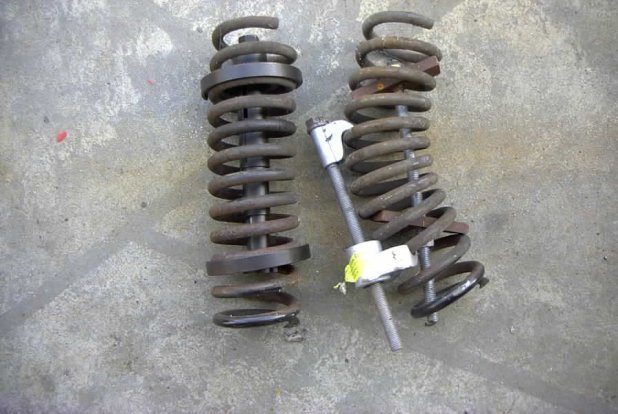

    BTW in regards to your adjustment issue. There is a way but its sketchy to say the least. You can buy or rent a spring compressor tool at auto zone or pep boys and they can work, but if they slip or you don't do it correctly they can be very dangerous (once you see one you will understand) . Take them off and take them to a suspension shop and they can adjust them in 5 minutes or less. Those shocks are worth having a shop do it correctly.

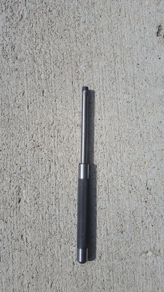

    These are what I am talking about. It "can" be done. I'm sure most would advise against this method though.

    No need for a spring compressor. Just spray the collar and lower spring mount with WD40, don't be shy. Jack up the truck to take all the load off and if you have a remote resi I would highly recommend a 5/16 hole punch from harbor freight $8 5 piece set. 5/16 is a perfect fit which wont ruin the holes like i previously did with an allen wrech i had laying around. I would also recommend not buying the $50 fox spanner wrench because it's useless with remote resis. (FYI ignore the pic with the excessive amounts of preload bc it was lifted to 4")20161104_125054.jpg 20161104_125044.jpg

    I just used a L shaped tool similar to a hole punch but it has more leverage on it to spin the collar around the shock body. Screw the spanner wrench. Those suck. Just take the weight off as previously mentioned and go to town. WD-40 if your coilovers are a little rusted out to really smoothen things up.

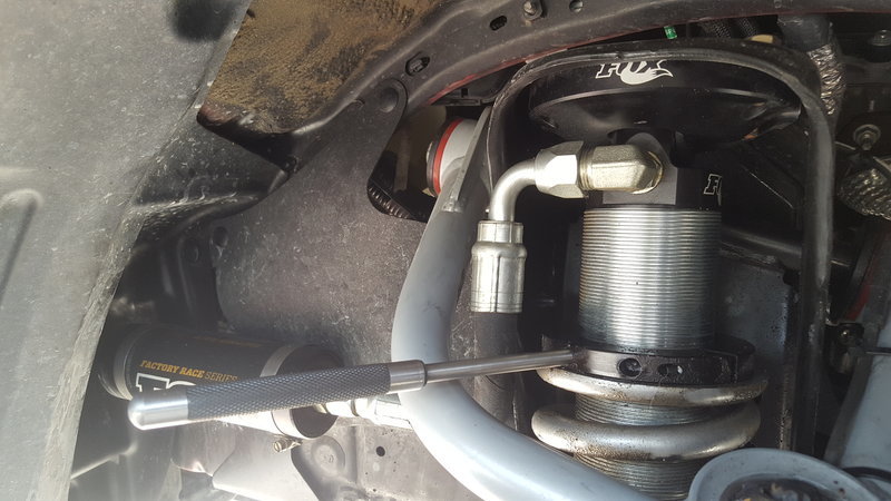

    Worked flawlessly. Think I paid $6 for the set at harbor freight. I've used the fuck outta that punch. Especially useful if you have the resivor hoses in the way.

    Yup don't waste money on the spanner, also beware of hole punch as I got a tapered one and it broke in one of the holes. Can't get it out:annoyed:

    On this pic with the amount of threads showing on the coilovers. how much lift did that give you?
