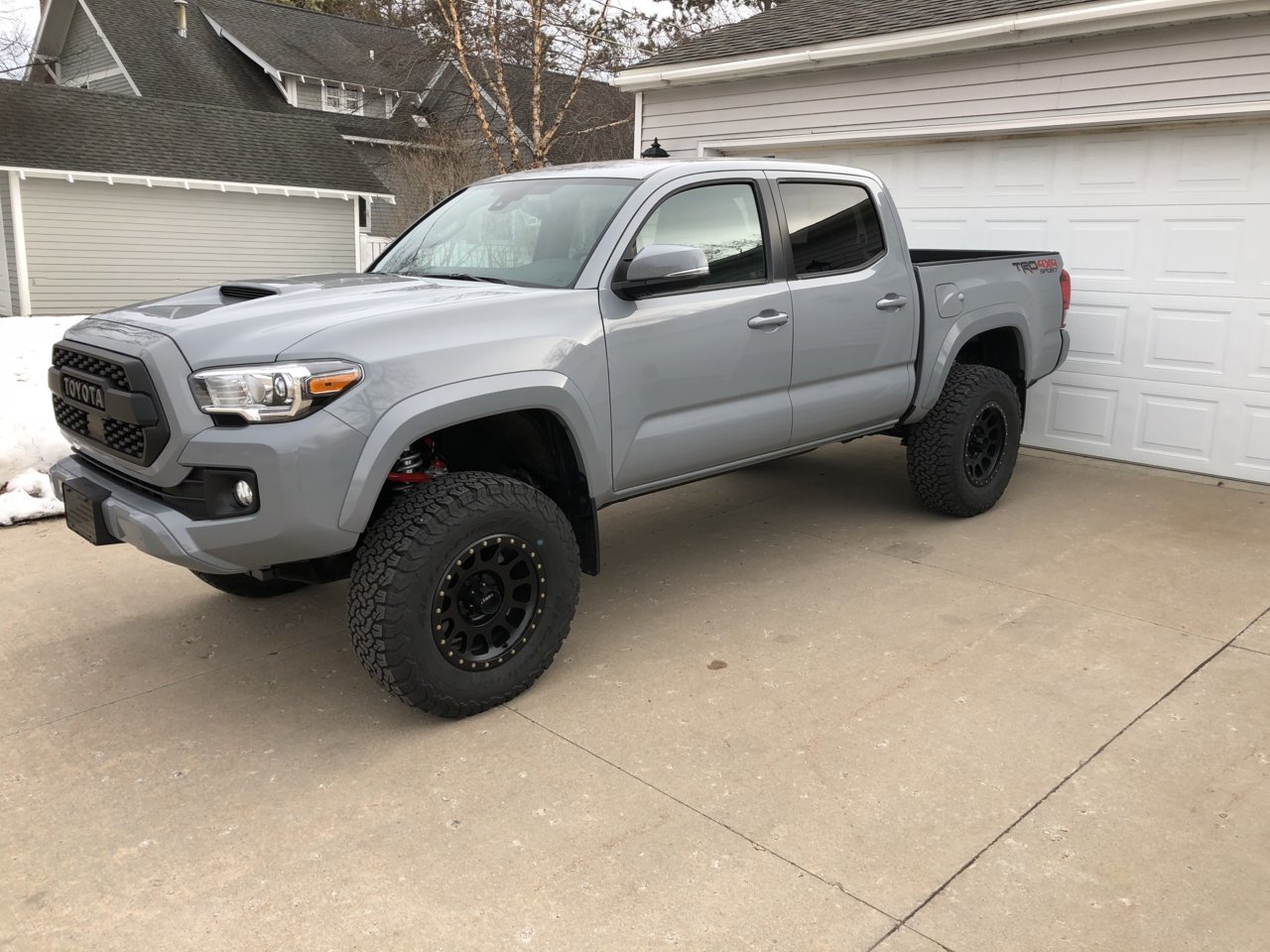

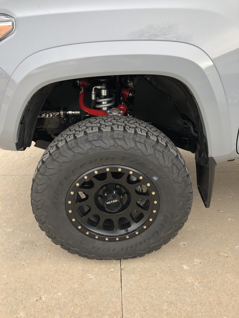

    8B22303F-B3CD-452C-AE69-FE35D24B1D38.jpg D6D9FB5A-9E93-4A84-A076-5FABEEE68056.jpg I just put some fox 2.5rr Coil-Overs on my 2019 tacoma to replace the 3 inch ready lift spacer because of the harsh ride. I didn’t adjust the fox Coil-Over at all so I should have about a 1 inch lift it says for a 3rd gen. I’m most likely over 3 inches and the ride is terrible. Way worse than the spacer. Not sure what’s going on?

    Too much coil preload? :notsure:

    More preload takes the springs and valving out of the comfort zone. How are the measurements versus the rear or stock measurements? Did you do anything in the rear?

    Measure from centre of hub up to fender, then can figure out lift amount

    From the center of the hub to the fender in the front I’m at 25 1/4 and the back I have 2 inch block and the measurement is 24 7/8.

    Looks liked they are cranked down a bit

    16 threads showing above the collar. Everything I can find says it should only be about a 1 inch lift over stock.

    i had 2.0 coilovers with nothing done in the rear. I was perfectly level. i realize these are 2.5's but the ride on and especially off road was the best I have ever had.....ever! If you have a 2" block in the back and are level then you are literally at 3 inches lifted up front. 2016+ tacomas are 3/4 to 1" low in the front.

    Yeah there’s something going on here. Every one talks about how great these ride and I’m sure they do just need to figure out why I’m so high.
