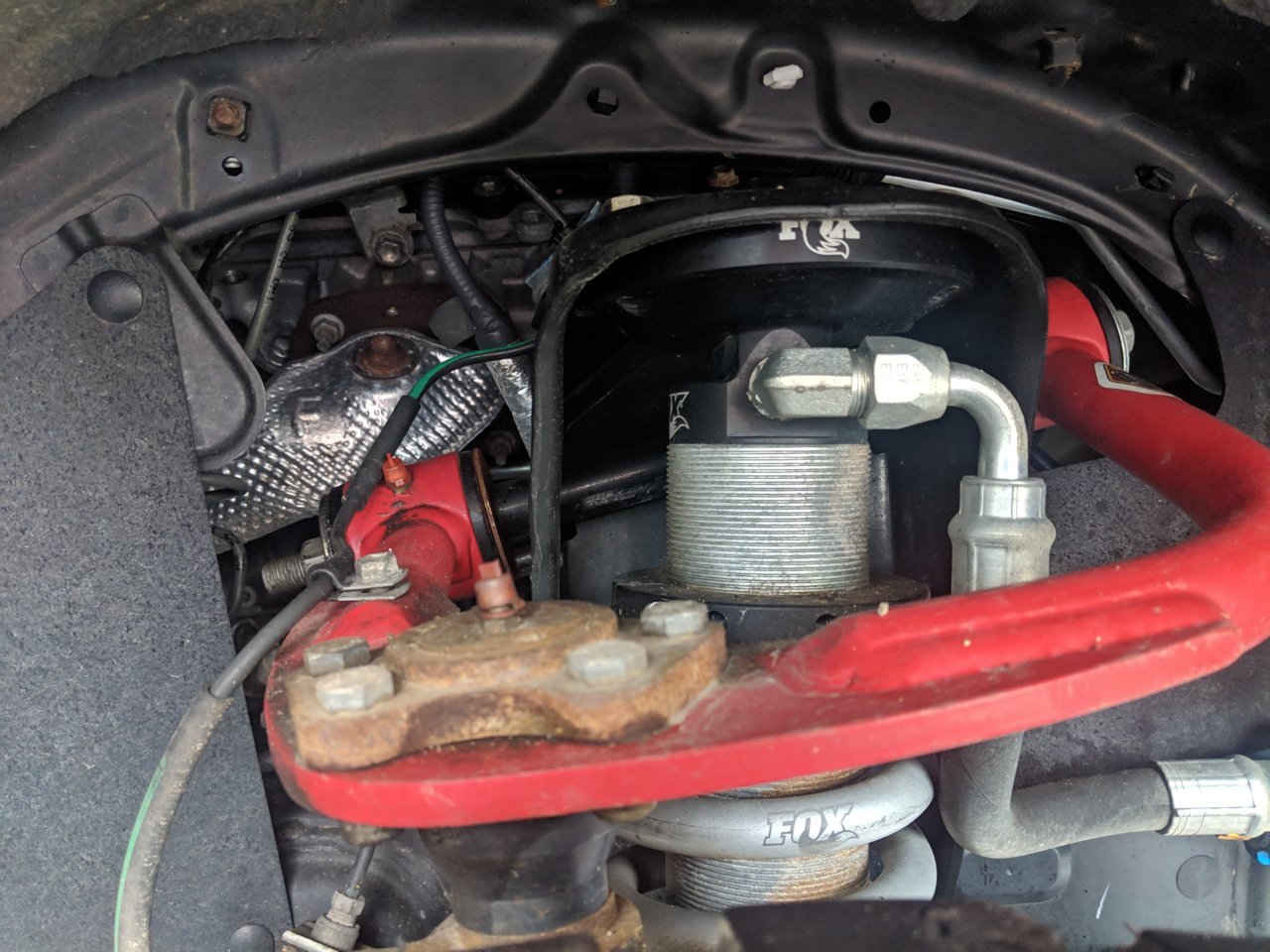

    Your UCAs look so much more level than mine. ED86FE8B-6188-4C3F-B017-B5ECE59A87E3.jpg

    The uca in this doesn't lookbad
