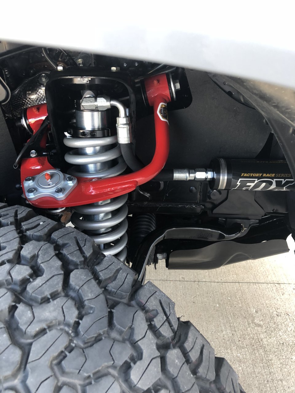

    Got a picture of the entire shock?

    If that's a 600 pound spring, and that's the amount of preload you have..then something is definitely wrong. You should be nowhere near 25" of height hub to fender with that shown in the picture.
    The rear should be about 24" max with a 2" lift....from spacer or aal.
    Did they leave the front spacer in?
    If not, I'm thinking those arent 600# springs or wrong part #s for your application

    Agreed, should’ve immediately thought of that as a possibility. UCA bolt should be hand tight/snug at full droop with the front off the ground and then torqued to spec in the static position once on the ground. Same applies to shackles, etc. in the rear. Also, just out of curiosity did you reinstall the UCA bolt correctly?
    @Broheim
    Agreed, 13”/600lbs shouldn’t be anywhere close to that. I’d be surprised if the coil doesn’t have some very minor play in it at full droop. Hell, with what little amount of preload, a few rotations loosening the retaining collar would probably free the spring entirely.

    You shouldn’t be at 25 1/4” up front. Adjust the preload by 3/4” on both sides. My truck was at the exact same height up front as your truck is now and it rode super stiff. I adjusted the c/o’s from 25 1/4” to 23 3/4” and it rides a ton better. My ride is still on the firmer side since I have 650 springs but a ton better than before.

    Think I found my problem guys. Looks like the coil 3CE98322-6670-4555-989E-A329AAAA7606.jpg spring is a 039-39-600-a and from everything I can find it’s a 16 inch spring.
