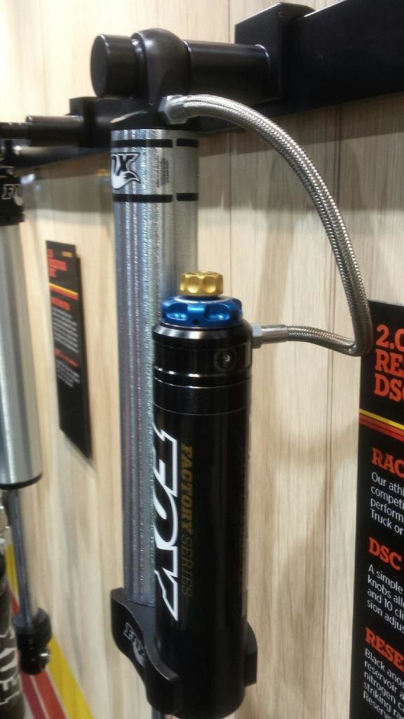

    Time to chime in shock guru's. I normally don't ask too many question's when it comes to suspension, but if you've seen my previous thread, I am currently going through a situation with my old Fox shocks, needless to say due to the circumstances I am getting some new revised Fox shock's shipped out to me on the house. Since I will be replacing the old ones with the new updated ones, I have the opportunity to throw in some new CD adjusters for the reservoir's. They are currently out of stock of them at the moment which gives me some time to evaluate whether or not these are a good idea or just somewhat of a gimmick.
    Anybody have these? What is the consensus on running them? Good, or bad? My wheeling style is mostly desert and sand running at high speeds. I know there is no replacement for proper valving, but any devices that offer finer tuning for adjustability can be and are appreciated. Whether these are legit or not, I'm not sure. There seem's to be a lack of info and reviews out there on them. Based on what they look like, it appears that they restrict oil flow into the reservoir's via the adjustment knob. I'm not sure if this would be a good or bad thing though. Any input? Thanks guys.

    I was looking at the DSC adjusters though it appeared for some reason that they were only available for 2.5" shocks and not 2.0's. Though another website stated that the only difference in making them fit and not fit was the increase in hose size.
    The money is not a huge deal, as Fox is going to take care of me regardless of what I decide. I just want to make sure they are good for what they are, and if the CD adjusters are not good, I see no sense in wasting the money. If the DSC adjuster are good though I do want to make sure they will work.
    http://www.pacificcustoms.com/fox81003001kit.html
    2nd option down, PN: fox81003001fitting
    This is what has me curious about it ^^

    It appears that Fox DOES make a DSC reservoir with a 7/16 hose for 2.0 shocks. They have released it, apparently they have not and will not ship them out to their distributors for one weird reason or another. A quick look at these pictures proves that. These were taken at the Offroad expo in Ontario.

    They will work with standard eyelet shocks but not with stem tops as stated by the Fox rep, BUT given some suggestions I made to him, he is talking things over with some of the engineers there and is going to get back to me within today.
    As a small update the pictures of the DSC 2.0's with the 7/16 hose is still in it's developmental stages apparently according to him. It's not ready for full production. I guess those must had just been an announcement that those were coming out at the Offroad Expo in Ontario.

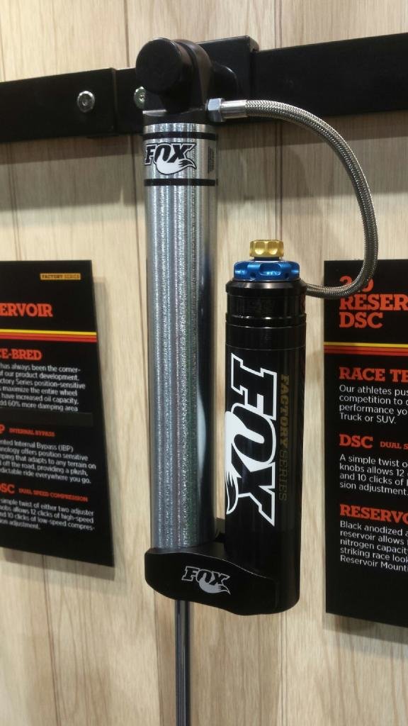

    As an update, I did receive a reply from the Fox rep about it stating that they did not have the proper convertor fittings to make it work, but assuming they did, a conversion like this would work and would go together fine, BUT for the money invested as well as the performance benefit out of it being that it is not made for 2.0's it is not worth it according to his engineers.
    The big HOWEVER to that though that I have somewhat of an objection with, (after doing some calculations with the information I have) why are the King Compression Adjuster's compatible for both 2.0 and 2.5 body shafts no problem, both 3/4 (.750 shafts) and 7/8 (.875) shafts, and can work with their old model shocks equipped with 3/4 shafts as long as a converter hose of 3/8 to 9/16 is used, and the Fox DSC Adjusters are only compatible for 2.5's and 2.0's with a 7/8's shaft, NOT compatible with a 5/8's shaft when the sizing difference would equal the same values after they are broken down and cross referenced? Their construction is identical which utilizes springs and shim stacks in a remote reservoir. The bump in size from a 2.0 to a 2.5 reservoir should also offer additional cooling capacity as well on the Fox 2.5 DSC Adjuster's.
    (See Bilstein 9300 Blackhawk series shocks specs. to see what I am referring to here.) Just so you don't have to spend the time searching, the Bilstein Blackhawk 9300's are 3.0 body shocks equipped with a MASSIVE 4.5 remote reservoir. Running something like this would be essentially the same theory. 2.0 body shocks equipped with a 2.5 remote reservoir.
    I did some quick math and cross referencing based on the information I had on both the King Adjusters and the Fox DSC's and I came up with these specs. I hope I do not confuse anyone.
    King Compression Adj.
    (.3750) to (.5625)
    3/8 bore hole to 9/16 hole
    .5625-.3750=
    .1875 difference in bore size
    .750 (3/4) smallest shaft avail
    .1875+.750
    = .9375 total
    Fox DSC Adj.
    (.4375) to (.5625)
    7/16 bore hole to 9/16 hole
    .5625-.4375=
    .1250 difference in bore size
    .625 (5/8) factory shaft (7/8 available, but not advised)
    .1250+.625
    = .7500 total
    Difference in overall sizing= .1875
    A quick check of this math is easy. If you notice, when you add the Fox's overall larger bore size and it's shaft size together, you will see it equals .75, which just so happens to be the thickness of a a 3/4" King shaft. Gee, funny how that worked out huh?
    The difference between the King Compression Adjusters and the Fox DSC Adjuster's cancel each other out after you factor in the larger size of oil flow from Fox's 7/16 bore hole compared to the old King's 3/8 bore hole. They both HAVE to be 9/16's (at the shock body via an adapter) regardless to run the adjuster's and if you have to run a converter to the hosing to make them both work with the appropriate shocks, then so be it, but the amount difference between the two in their allowable oil output from their bores cancel each other out after you factor in the loss of shaft size for the Fox shocks. It appears based on the information I have, that the same amount of fluid will be worked into both reservoirs due to the lack of sizing of ones bore vs the others larger bore in relation from ones larger shaft sizing to the others smaller shaft sizing. In conclusion to this crapshoot (lmao), I honestly see no problems here.
    I am going to let the rep know I want them anyways and will be testing them out myself, then provide feedback. Gerbil style :D
