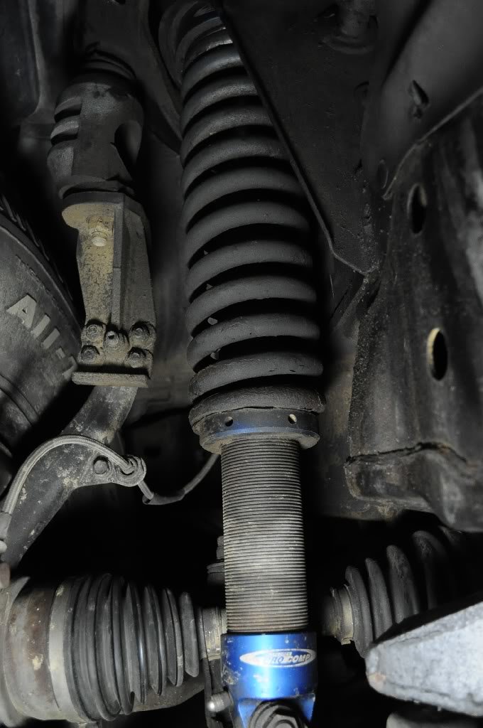

    i have these but 3"
    Pretty dirty i know
