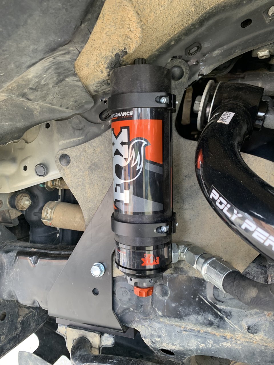

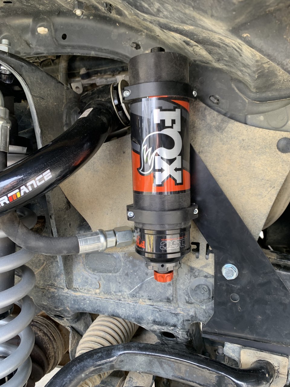

    This exactly! Finished the fronts over the weekend. I struggled a lot with mounting the remote reservoirs on my PES shocks. Found it difficult to fit the resi in the mount and also clearance the frame with the resi hose fittings and the top of the wheel well. Added some pictures for reference. Felt like I put a lot of pressure on the hose and and indirectly, the fittings trying to get it in there and lined up. I'm not sure if its a problem but the tolerances between my trucks frame and the resi hose fittings are so tight the splashguard sandwiched between the two can barely move. Tightest on the driver side for sure. Driver side I also removed some of the foam on the wheel well for the resi to clearance. Honestly, everything passenger side for me was much easier. Front and back.
    Other than that, the UCA bolt was a headache. Nothing related to the Fox shocks.

    I apologize if this has been asked before. Can the mounting hardware from the Elite 2.5 series be used on the Factory race series? It also seems the orientation is rotated about 90 degrees, what's up with this? Does it help with easy of installation and with rubbing of the tire? I remember when installing the factory race series front coilovers, it was like wrestling bear trying to get them in place.

    I'm pretty sure the mounting hardware can be used. Mounting my front resi's on my PES was like wrestling a bear as well. Challenging holding the resi's straight/in place while cinching down the Allen bolts. Made me want to use hose clamps instead...

    Yes, its just a clamp made to fit around a 2.5" reservoir. Not sure why Fox changed reservoir orientation.

    Only thing that concerns me with the new mounting location is the sway bar hitting the DSC adjusters. As seen in this video at the 7:50 marker.

    Definitely. Unfortunately its pretty difficult to cycle the front suspension to make sure the reservoir is up high enough (remove spring and cycle), so in general just need to push it up as far as it can go in the fender to avoid contact with the sway bar.
