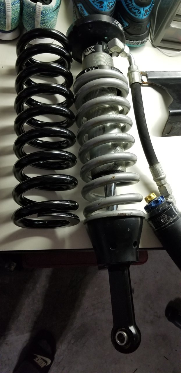

    wheelers offroad. i just bought 700lb eibach coils with my 2.5'' RR dsc. has anyone else done this yet? i'm gonna run full skids next. the the ADDS Honey Badger front bumper in the future..

    I am adding a ADDS honeybadger front bumper and a warn winch. the back with be loaded with a Rci bedrac with rotopax and RTT full time. I have mob town sliders on right now and going to be running a Hc rear bumper as well. by pelfreybilt I believe.
    this is it right now but I will be adding all that in the next few months to come and I just wanna prep for the weight.. will running 700lb coils be ok right now? what setting will I need to put the preload at to net about 2.75 inches of lift?
    edit.
    this is the spring i bought from wheelers offroad. eibach 14" 700lb coil

    You really shouldn’t exceed 23” hub to fender, or 2” of lift on a 3rd gen.

    you're telling me I shouldn't. but I have a shitload of stuff that will be going on the rig.. that will eventually weigh me down. along with full armor. so... what now? @Sub_Par

    What have they debunked? The fact that your CVs will be at an extreme angle and could lead to premature failure?

    So why would you set it to that height when you have no idea how much it will sag? Put the springs on and let them settle then set your ride height. But it’s up to you, your truck and your decision.
