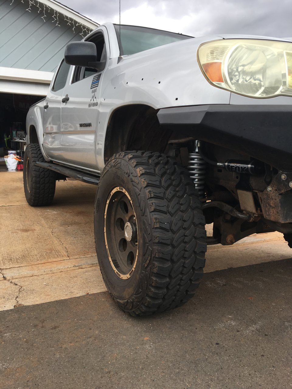

    Installed Sunday. This is for 6” lift kit, adjusted 1” more from factory. 2nd gen so that gave me 2” of lift, ride is so much better and height is just where I want it. 03FDBEBB-A77C-4C06-BF0C-284C8C437D77.jpg

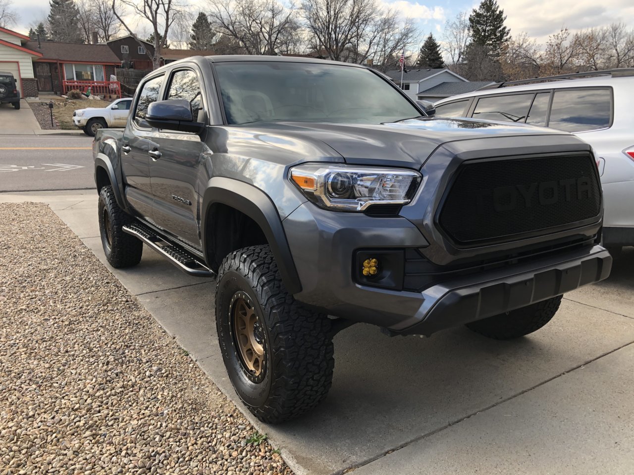

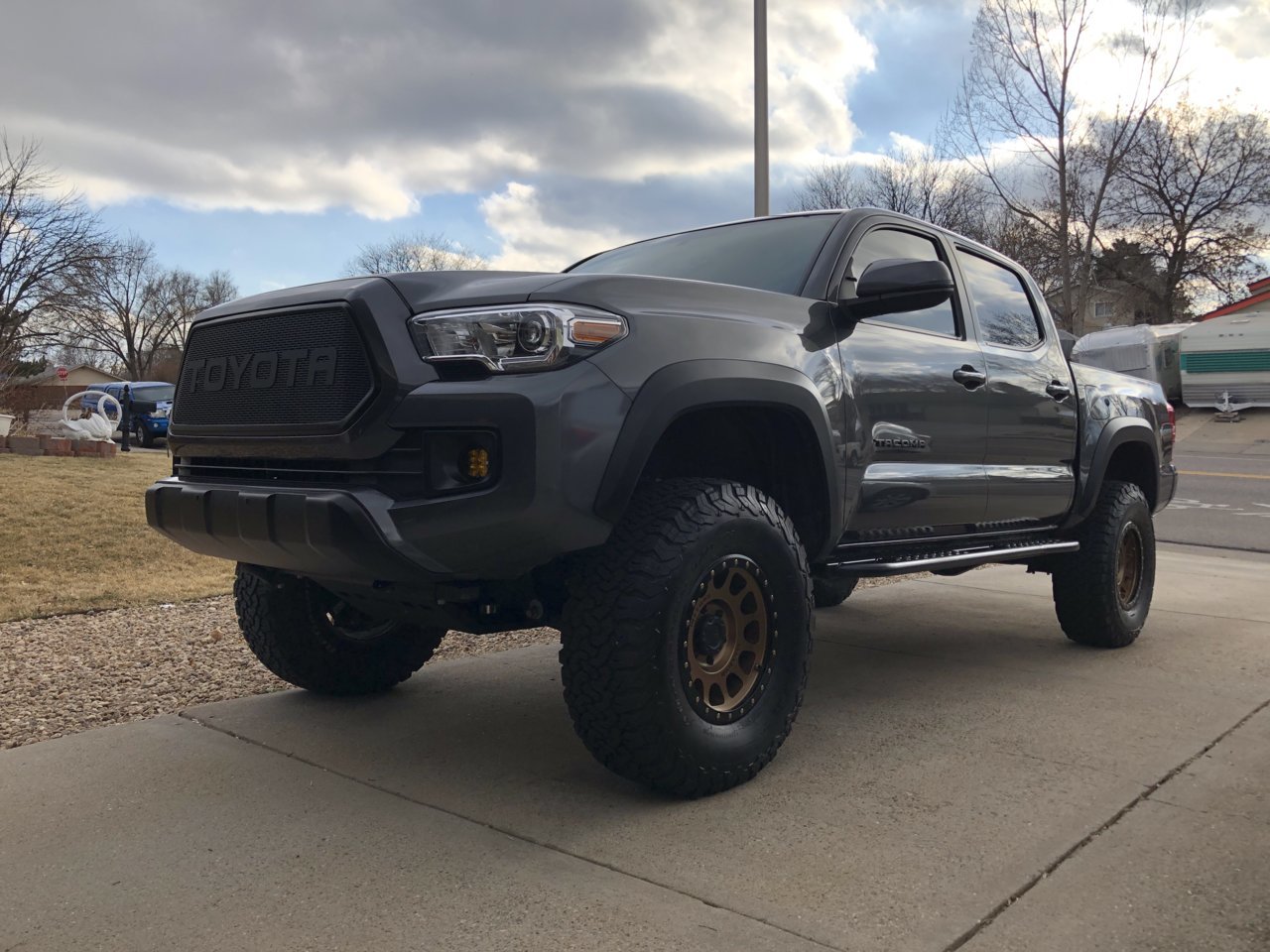

    My buddies and I installed Fox 2.5 DSCs w/ adjustable reservoirs last Saturday and I had my mechanic adjust the preload on these bitches and do an alignment yesterday. She is all dialed in now. 23.85” center hub to fender on fronts and 24.25” on rears. She rides like an absolute dream- soaks up the bumps. Also gave her a bath for the first time in months.
