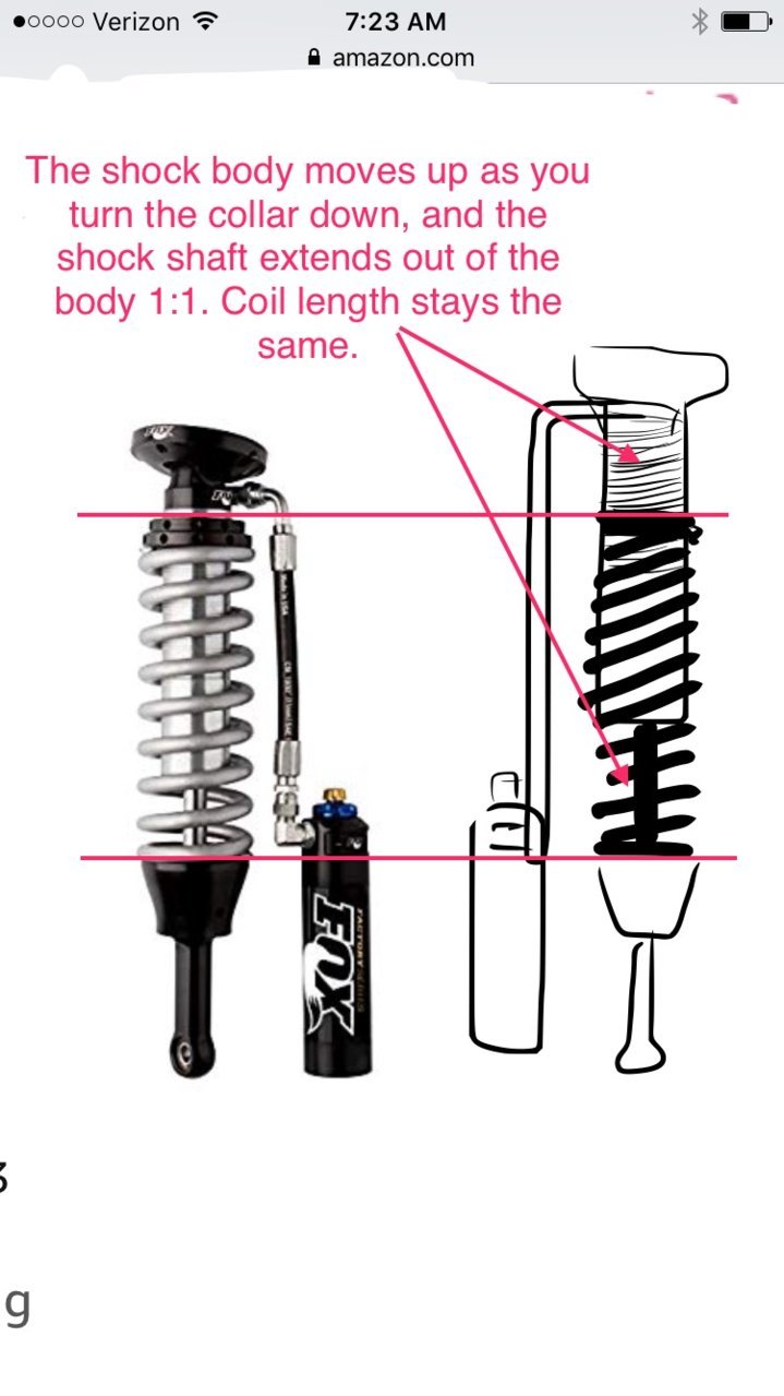

    You're good to get ext travel on stock UCA's. You just won't get the travel until you get on. No diff drop. Maybe carrier bearing and just do the needle bearing while you're there.

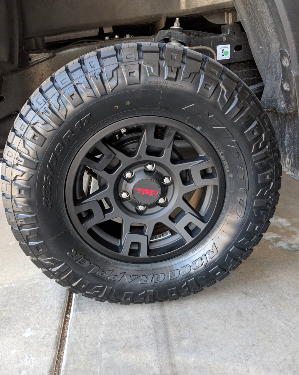

    I just got the same tires on my 3rd gen. I have Fuel JM2 17in wheels (-6.3mm offset) ( 4.5 backspacing) with Fox 2.5 CO. Both side are rubbing. Did you have rubbing?

    I had rubbing with the mud flaps. No rubbing on normal street driving/parking.

    Sorry, article is correct. I miss-typed.

    Thank you for the visual! Based on the answers that I've received, I'm starting to think I'm associating the harsh ride to the wrong end. The rear (Fox 2.0) was lifted with a progressive 3-AAL setup.
