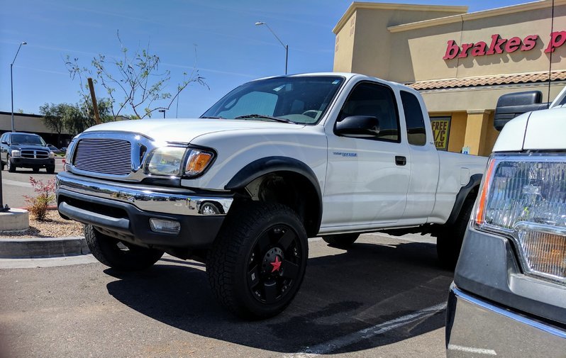

    Just had Fox 2.0's put on my 1st Gen. Made such a difference! Got a little lift out of it too so. The bolts were so rusted I had to take it in to get them installed. Put Billstein 4600 on the rear myself, but it's like driving a brand new truck! IMG_20170318_113327_1.jpg
