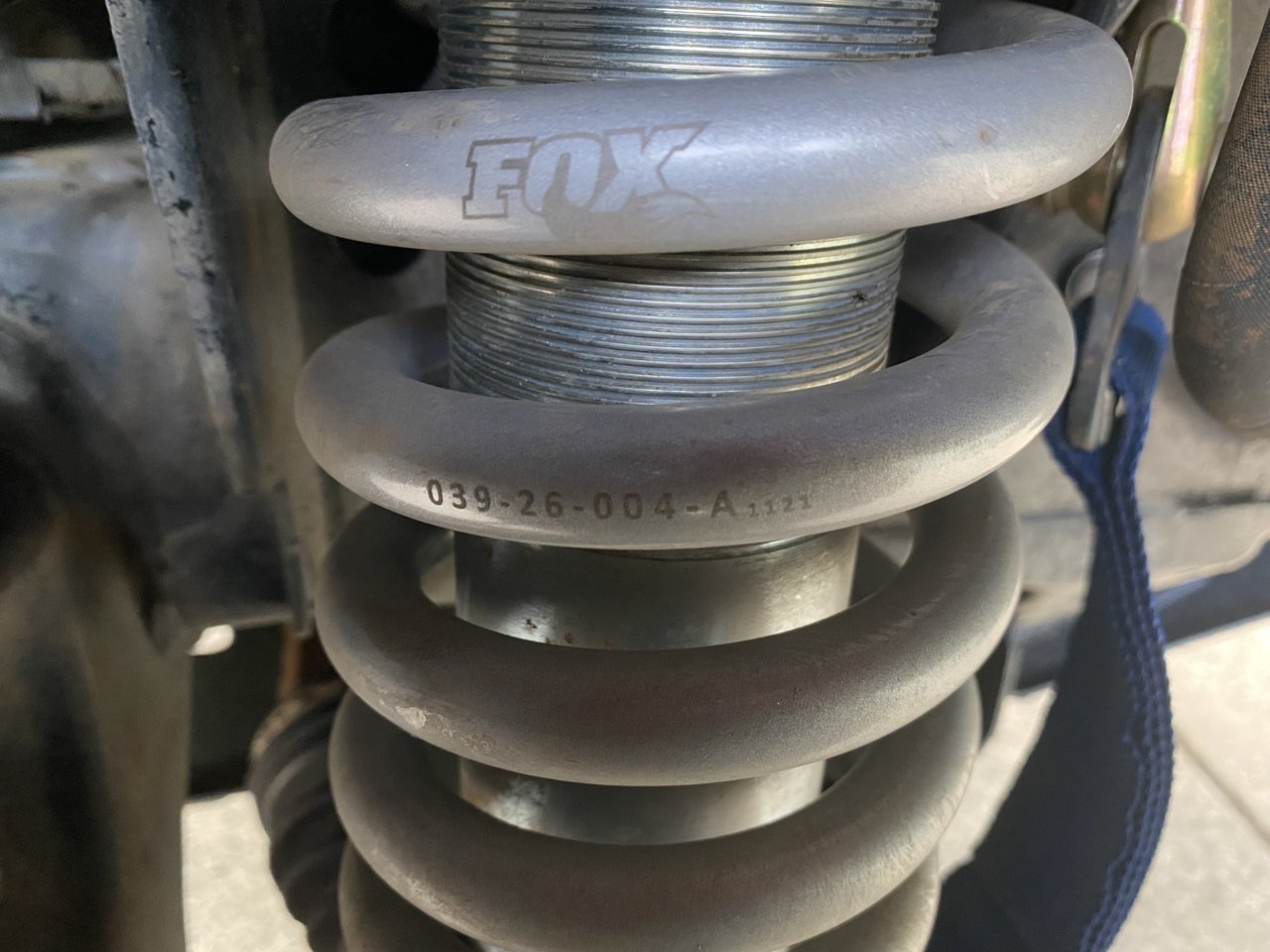

  17. Sep 7, 2022 at 7:58 AM
    #17
    PNWtaco541
    PNWtaco541 @LFG_Tacoma
    Feb 8, 2019
    #282249
    7
    Portland, OR
    2020 TRD MT
    Mod: Front Coilovers Spec: 2.5” RR DSC Brand: Fox Mod: Rear Shocks Spec: 2.0” x 12.1” RR CD Adjuster Brand: Fox Performance Series Mod: Rear Shock Relocation Tower Spec: 12-14” travel 2.0” shocks Brand: Archive Garage Mod: Rear Leaf Pack Spec: RXT (Option 1) Brand: Icon Vehicle Dynamics Mod: Ubolt Flip w/ Bump Stop Spec: Active Off-Road Brand: Timbren Industries Mod: Rear Extended Brake Lines Spec: +4” 5 Layer lines Brand: Crown Performance Mod: Rear Leaf Hang and Shackle Spec: 3.6” shackle hammer hanger custom cross tube support bar Brand: Archive Garage Mod: Rear Bumper Spec: HC Tube Bumper "Tilted" Brand: OUTGEAR SOLUTIONS Mod: Aftermarket Wheels Spec: 17x9.0 -25 (4 Inch Backspace) PCD: 6x139.7 Center Bore: 106.1 Limited edition Machined Silver Brand: Summit Off Toad Wheels Mod: Tires Spec: KM3 285/70r17 Brand: BFGoodrich Mod: Seat Covers Spec: Black Perforated Leather and Vinyl Brand: Classio Mod: Cab Mount Chop Spec: DIY Plates Brand: Total Chaos Mod: Upper Control Arms Spec: STRD High Caster Brand: JBA Offroad Mod: Rock Sliders Spec: 80" Brand: DYI Mod: IFS Limit Straps Spec: 15" Brand: TMR Customs / KarTek A few more cosmetic sh*t, will add later…
    ....a year later... my bad!
