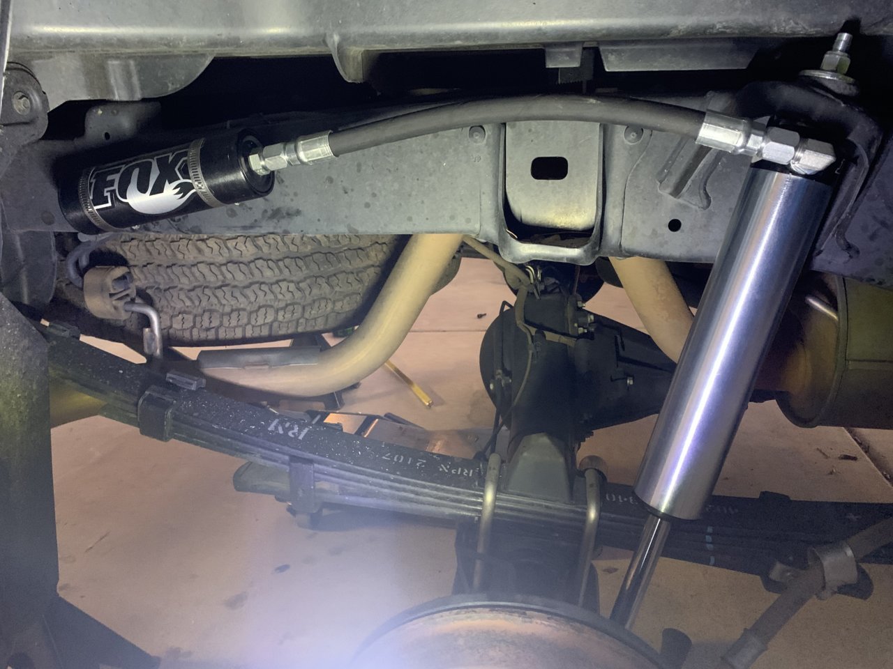

    I have the Fox shocks 2.0 with remote reservoir on the rear of my 2019. Doesn't seem to matter how I mount them, the hose eventually finds something to rub on and starts leaking. The first failure rubbed on the tire and cost me a tire too. The second actually didn't rub on anything at all and still started leaking at the fitting. After remounting the reservoir to ensure they couldn't reach the tire, the 3rd ended up rubbing on the shock mount. The other side is already showing wear against the shock mount too. I am up to 3 replacements in less than a year. The second failure was warranty but took over 30 days to get repaired and cost me $70 in shipping and was a horrible experience with near no way to reach them to get status.

    I used these to relocate my resis along the frame rail and haven't had an issue:
    https://www.amazon.com/gp/product/B007CISHT4/ref=ppx_yo_dt_b_search_asin_title?ie=UTF8&psc=1
    Definitely agree it's not the best hose design given the method they want you to mount the resi's, much too long and should use fittings to make the bends, so these mounts keep things in line and as a bonus keep the reservoirs in view
    Side note but totally agree that oxidation and corrosion on the front coilovers sucks balls.
    Hate to see you get rid of such a pricey set of rear shocks when you can get rid of your issues for $20

    Yep, this is the second upgrade I did. The problem is that it turns the fitting to where the hose touched the shock bracket. I tried to leave a slight "service loop" in the hose. That is the one that started leaking at the fitting. Assuming from stress from the slack in the hose.

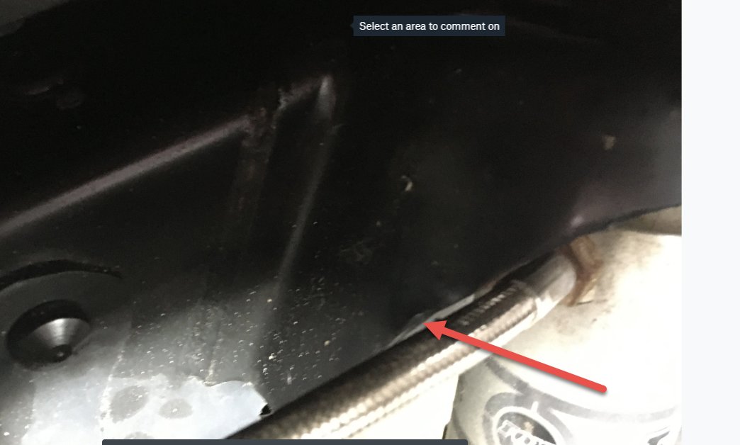

    Here is where they end up leaking

    Rotate them out so they're not hitting the shock mount.

    Well I can see why they leak after time. Any amount of vibration and the shock tower will come in contact with the hose.
    ericvega and SR-71A like this.

    They didn't start in this position. For some reasons they work their own way back to the side. There is nothing preventing them from turning.
