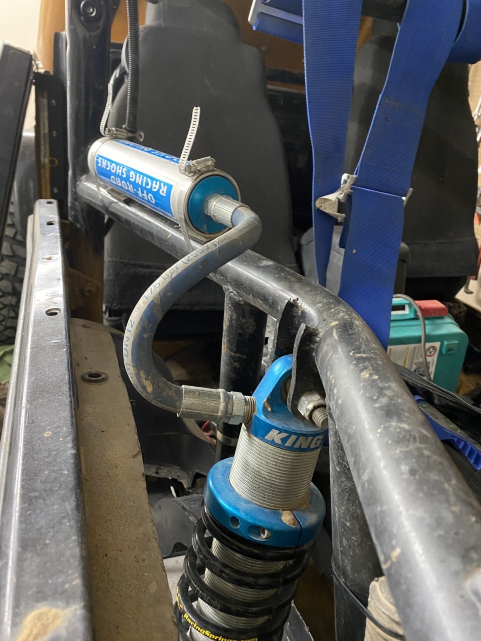

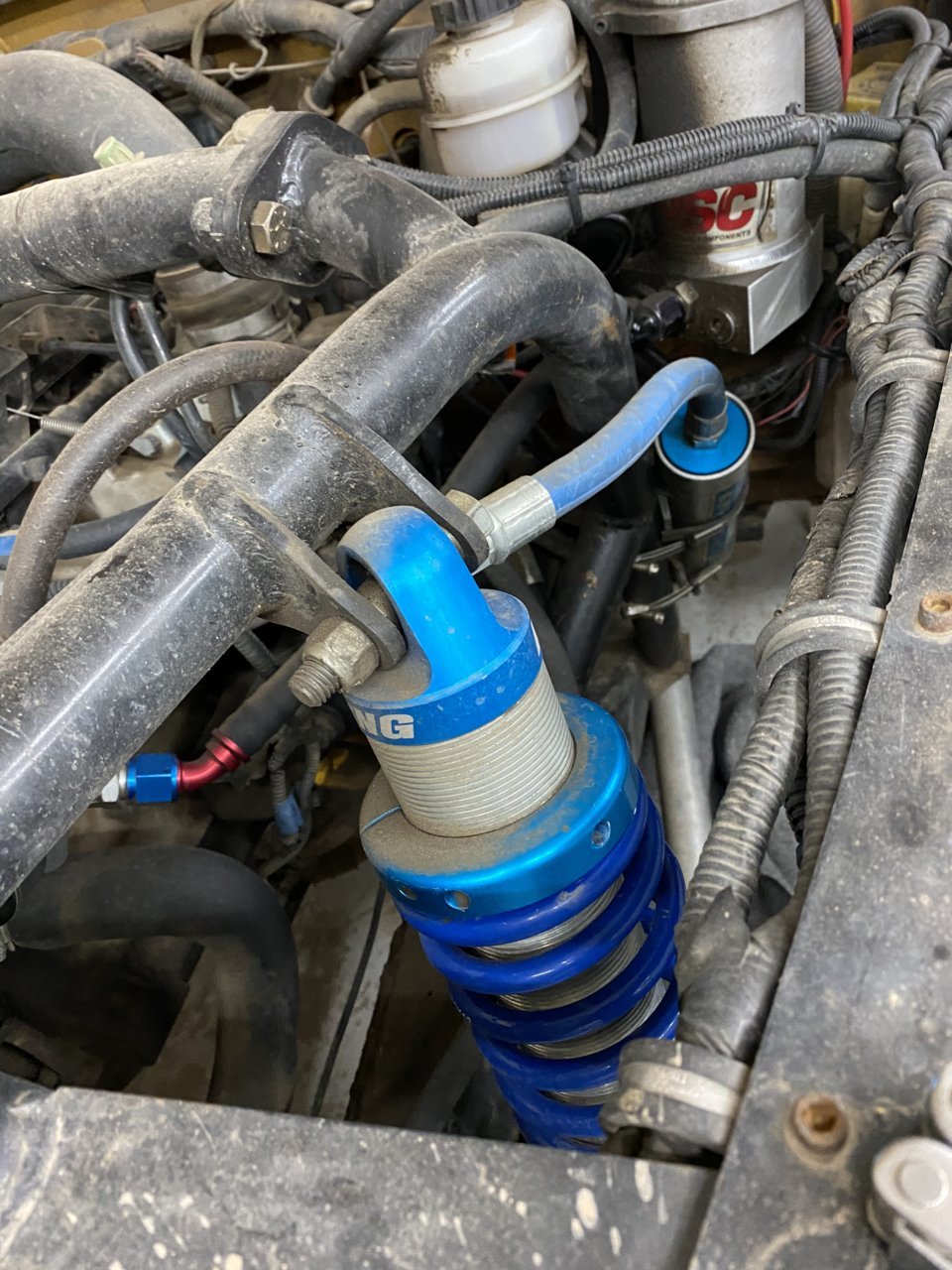

    I would sleeve the hose with another rubber hose...
    and as stated above, re-torque the top bushing.
    My mounts are pretty basic, but 5 years later....
    06717AF7-5D39-4980-998E-0322B8A5EC7A.jpg F862CEC1-8C25-4A4A-87E0-ABF9ACB870E4.jpg
    Keep us posted on what you do.
