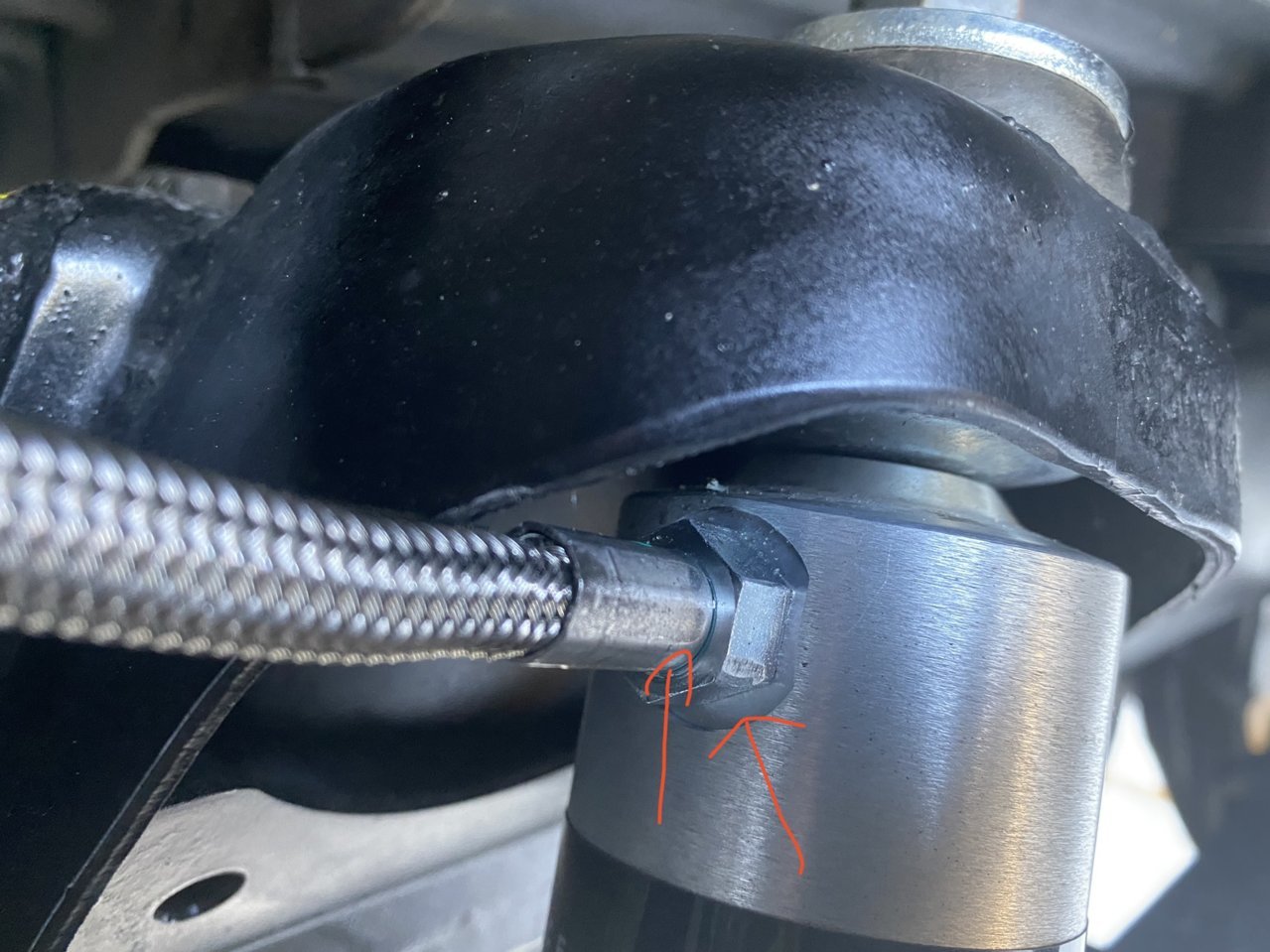

    It definitely appears to be hose abrasion in the pic but its just where I rubbed off the dust with my finger. I was checking for rub. Hose is good but I might as well put some edge trim there too. I'll go give that hose fitting a teeny ugga in a bit. Thanks.

    Do you have enough hose slack everytime it flexes? Maybe the hose is gwtting pulled at full lock?

    Those are mounted on the rear...there's no hose flex.

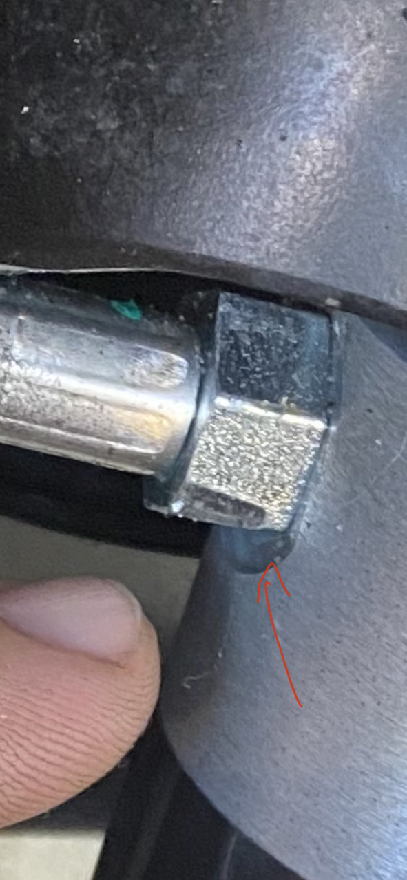

    Hey guys, hoping y’all can help. Rear 2.0 is leaking here. upload_2021-10-26_17-31-24.jpg
    Any advice on why, less then a month old, and I’ve tried to tighten. Seems tight just don’t want to over do it. Please any help would be great!

    They're leaking? Is the end of the crimp hitting on the top side of the shock bucket?

    It doesn’t seem to be hitting. Yes leaking oil. Is leaking out at that “bolt” that goes into body of the shock.

    Your braided hose, before the metal crimp, has hit the shock mounting bucket. That’s where your leak is.

    The braided hose is damaged, and you can see where it has worn the paint off the shock mounting bucket.

    It’s not leaking there. I can literally see it coming from body of shock beside fitting.

    99% of the time, its the installers fault. Any performance shock needs to be rebuilt every ~20-30k miles for the average joe.

    Well obviously yeah, the hose got smashed and it rotated/loosened the fitting going into the body or fucked the o-ring up.
