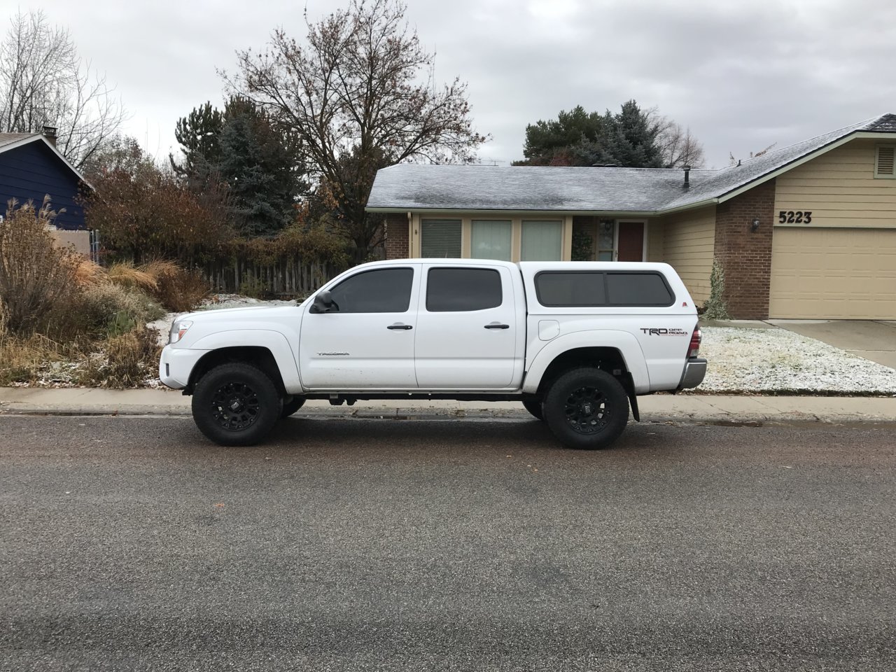

  20. May 30, 2023 at 6:21 AM
    #40
    Wilso14
    Wilso14 Active Member
    May 24, 2023
    #425331
    29
    Philly Burbs
    2014 trd sport 6spd
    Scored a set of used 2020 pro Fox shocks from a fellow member last week and installed them on my 2014 this weekend. I replaced a set of stock OR 2020 bilsteins which I mounted about 2 years ago. I have a AAL in the rear for reference. Night and day difference in driving experience. It soaks up any imperfections in the road, eliminated the brake dive, corners better and stays planted in all scenarios. Couldn't be happier with the upgrade and wish I would have done it sooner.
